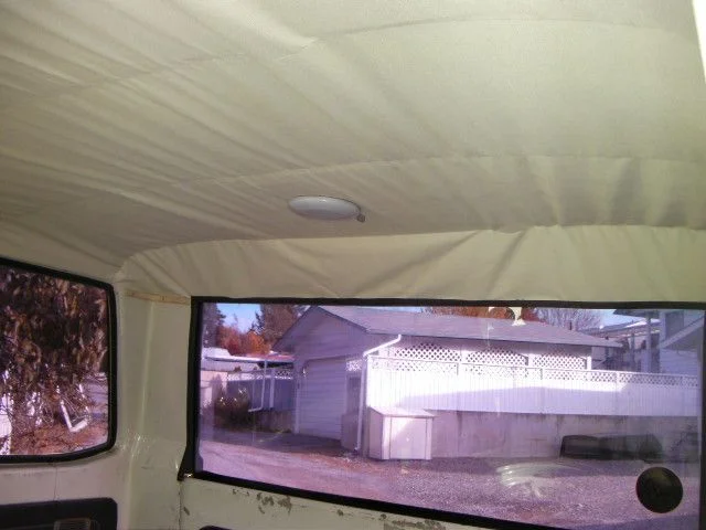

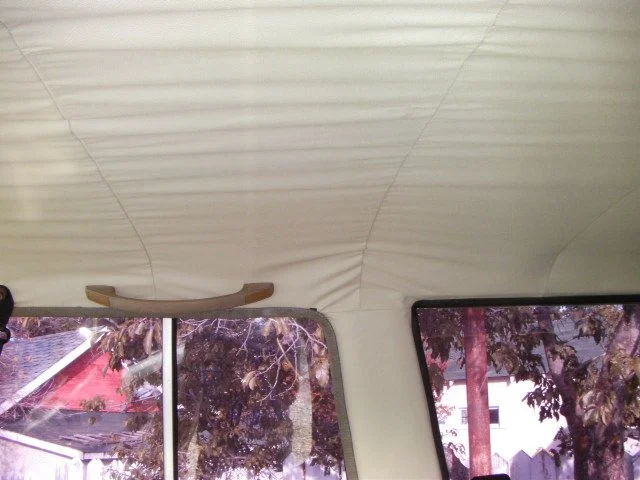

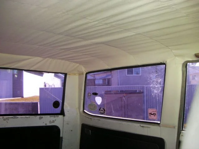

Yes, it's the SOR headliner. The dome switch handle is broken off. I'll snap a few more pics of the headliner. I was tied up today doing other things so I'm not totally finished the headliner yet.
As for the windshield price, I have NO idea. It's covered under the insurance and they bill direct to the insurance co. I don't see the bill, just $200 deductible.

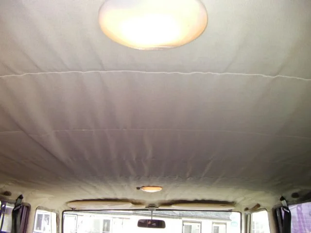

The headliner is in, except for shrinking it. I need to find my heat gun or hair dryer. I got a second dome light with a switch so now I have a dome light front AND rear both individually operated.
Got a pic of the forward and of the cargo windows as well but like I said, it's not yet shrunk tight.
Hopefully I can find the heat gun here in the next few days and get it 100% on the headliner.
I like how the dual dome lights look. I picked up a second dome light a few months ago and I am doing the same thing when I put my headliner in.
It's more than just the dome light. You need the extra support too. The one that holds the dome light that you can see in this post https://forum.ih8mud.com/fj55-iron-...otm-cruiser-guy-guatemala-12.html#post5952357 I picked it out of the scrap when restoring my '55 way back when. If you look at your roof supports you'll see you have half the supports I have.

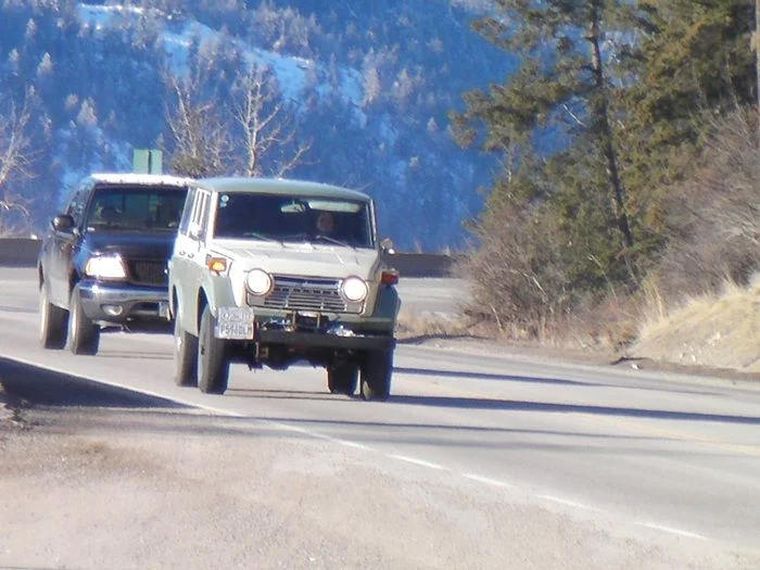

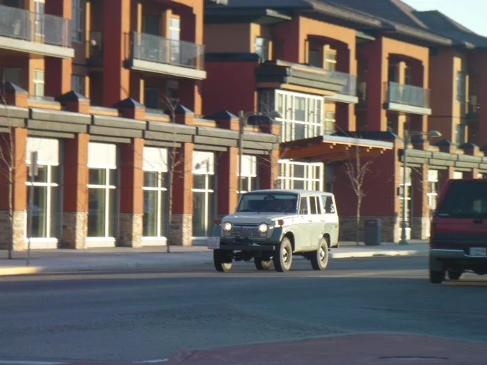

Took the piggy out for a drive to the coast. A friend of mine will "piggy sit" while we are off in Sierra Leone. Here's a few pics on the drive.
