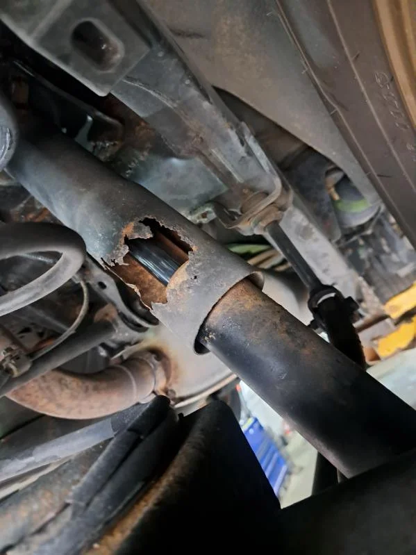

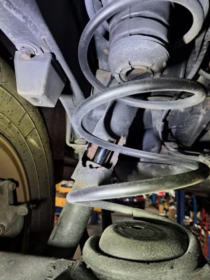

Hi! Been reading your posts today. Amazing! I have a 1999 LX 289k miles with all original globes, springs, height sensors, shocks front and back and everything still working. Graduations in reservoir are down to 9-10 but range of pressures still within range. And H N L all working. No rust on frame or body so I think that has helped also. My rear shocks do look like this though (see picture), but mechanics said the inside battering ram is still good with no leaks. And my right side damping has gone off with code C1721 and 1723 because of wire damage due to exhaust heat but found the damaged wires area and will have it fixed this or next week. But even without that it’s driving pretty smooth and comparable to my much newer RX350. Waiting to pull the trigger (after getting damaged damping wires fixed) on new globes and new shocks and possibly even new height sensors because I’m more worried about things being discontinued as alternator, brake lines and other things have been. Rather purchase and keep some of them on the shelf. Live up in Canada so I have to get from Impex Japan or Parts souq or few dealers in US who do international shipping as even more limited with parts here or super costly here. Would like it set it up for another 25 years of driving.
Oh and still original control arms and other suspension components. Except for steering rack replacement. No noises. 24 years and 289k miles (465k km) I mean I’d say these vehicles are pretty good :)

@WanderingWarrior I think rust would be one reason why I might abandon AHC.... but besides the dust shield, your undercarriage looks pretty good for NY. There are a lot of hydraulic lines that can succumb to rust plus the sensors.
