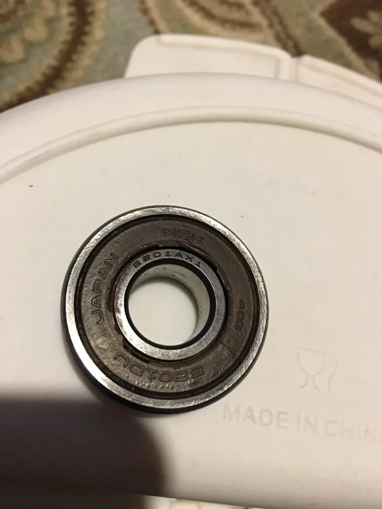

Hello I own a 1984 fj60, two weeks ago I was coming back from a trip with my wife and friends. We stopped too sightsee and when we jumped back on the car it wouldnt start. After hours of trial and error I realized that when the engine turned the distributor didn't.
After taking the distributor apart I found that it's bearing had seized and caused to seize the whole distributor shaft and broke the pin.
The problem I have now is that I cannot find a replacement bearing.
I am attaching a picture below.
If anyone can please tell me wich online store carries this part I will be very grateful.

Thanks @Spike Strip for the link to MERCADO LIBRE, unfortunately that listing is in Venezuela and I am in Bolivia, my dizzy carries the bearing, and to get home I had a friend drive 130 kms with a points dizzy to drive back home.
I just managed to measure it and I think these are the measurements:
Internal diameter 0.0485"
external diameter 1.255" and
width 0.4".
I think it will be easier to have it shipped from the US or Europe than from Venezuela.

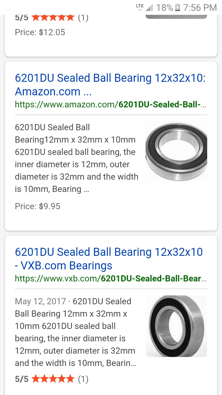

There are no bearing supply places in Bolivia ? Even an Auto parts store should be able to get it...
It's a common bearing and even a place with limited supply should have it.
Bearing size in mm for 6201 DU Sealed Ball Bearing is 12x32x10.

Yes you're right I have found the 6201 bearing but after measuring mine and being told by the parts supplier that it was in inches I got these measurements
Internal diameter 0.0485" 1.2319 mm
external diameter 1.255" 31.877 mm
width 0.4". 10.16 mm
And there is some variations.
Do you think it wont make much difference?
I guess the best way to see is trial and error.
I'll try and let you now how it goes.

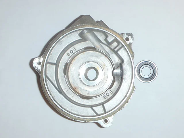

Where is the sealed bearing in the dizzy? When I tore mine down, I only saw loose ball bearings under the breaker plate but no sealed bearing. I don't see it in the schematics in the 2f manual either.
The bearing is a press fit inside the aluminum housing, underneath the base of the cam. You can see the top of the bearing with the breaker plate removed. I'll post a photo in a few minutes.
