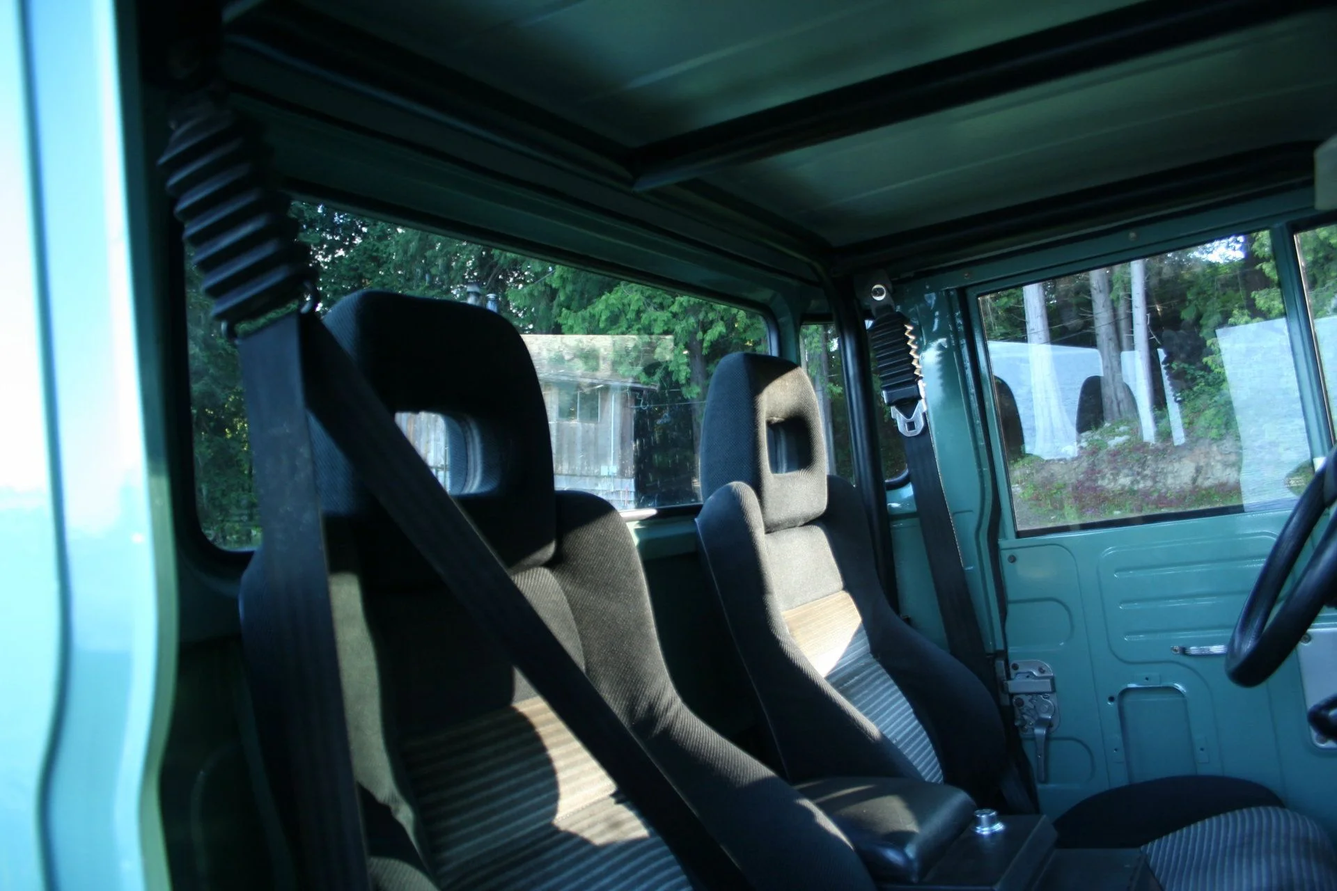

Seats and steering column in a 45...
I used a set of 1988 Honda CRXsi seats in my 45. They are the smallest in profile (recaro) designed seats I could find when I built it. Pretty comfortable, The truck has a full interior cage as well. I'm 6'1" and weigh 230.

Casey, just a thought….if you shorten the the column it becomes in the way of your knees. I don’t have my Red 45 back yet but went with 1987 FJ60 seats and made custom frame. That way you can lower the seats or do what you need to. I’ve sat in them and they are way better and more room than my stock seats. Also went with a 1981 FJ40 steering wheel that’s about an inch smaller in diameter from my stock 66. I have no real seat time yet but getting close and I’ll share as soon as I do.
