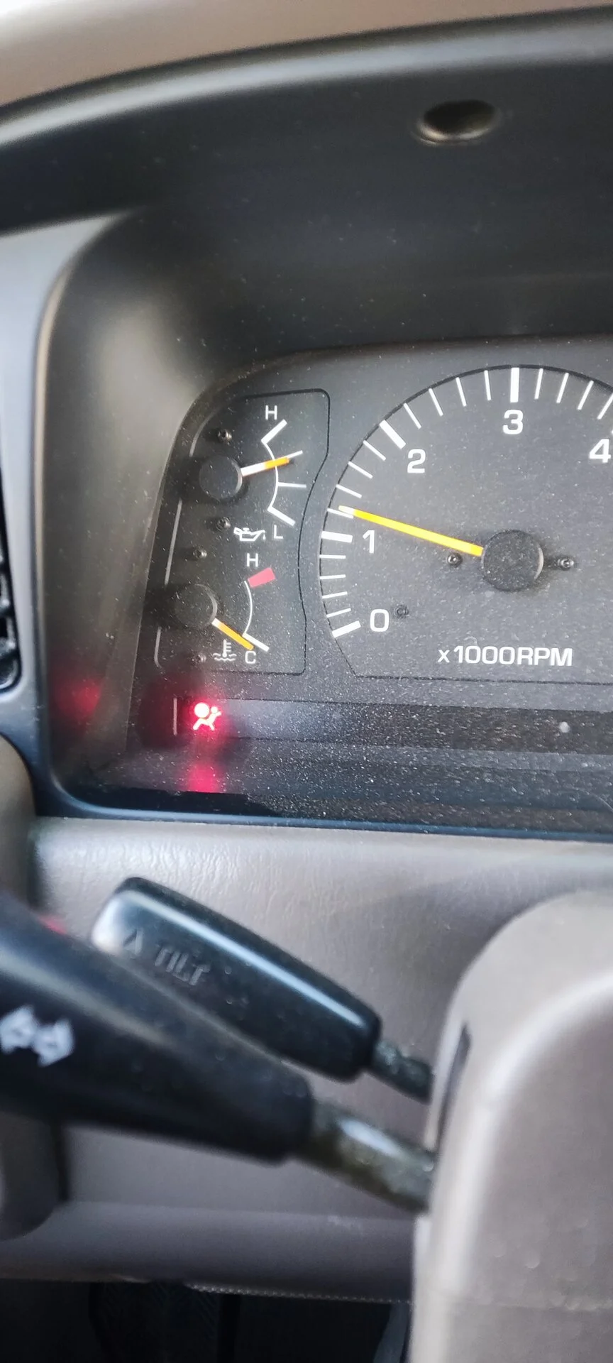

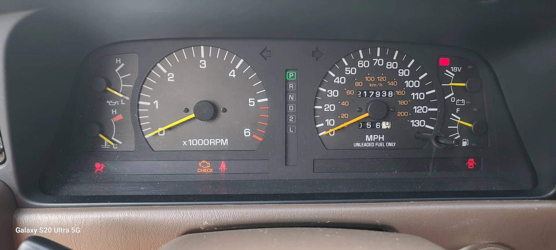

For the life of me, I can't ever remember seeing a seatbelt warning lamp on my LX450 or my 91 FJ80. Where is it on the combination meter?
Next to the MIL. Of course, if you've permanently disabled the buzzer by closing the switch, you'll never see it.
This is a Land Cruiser, not a Lexus LX450, but I would think the combo meter is the same.
LOL, I've never seen this light on either truck. OK, now I'm curious.

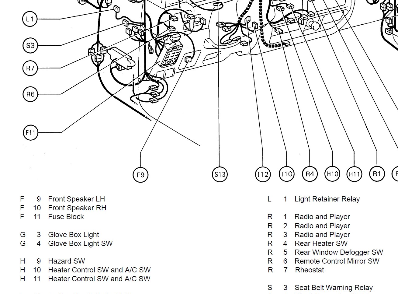

I've got to hunt for the seatbelt warning relay. It looks like it's in the left kick above the relay block. I'd lay odds that mine is missing. Never heard a buzzer, never saw a light on the dash.
You are correct:
It's tucked away in the upper corner, where you can't get at it. Fortunately, verifying it's not there is far easier than removing it.
Thanks everyone for the replies here. According to @Malleus s comment, I'm guessing this is airbag sensor, not seatbelt. Unless this light is also used for DS seatbelt. Although, I could not find any housing for it, and OBD2 is not throwing any codes. Last time when I had an ABS light throw, I just tapped the relay box and it magically went away. Maybe I am being too hopeful this could be a similar solution for this one.
That is indeed the airbag error light. The most common cause is removing the airbag from the main harness without first disconnecting the battery. The airbag computer thinks it's lost power and turns the light on. Mine's been on for years, because I did exactly that.
