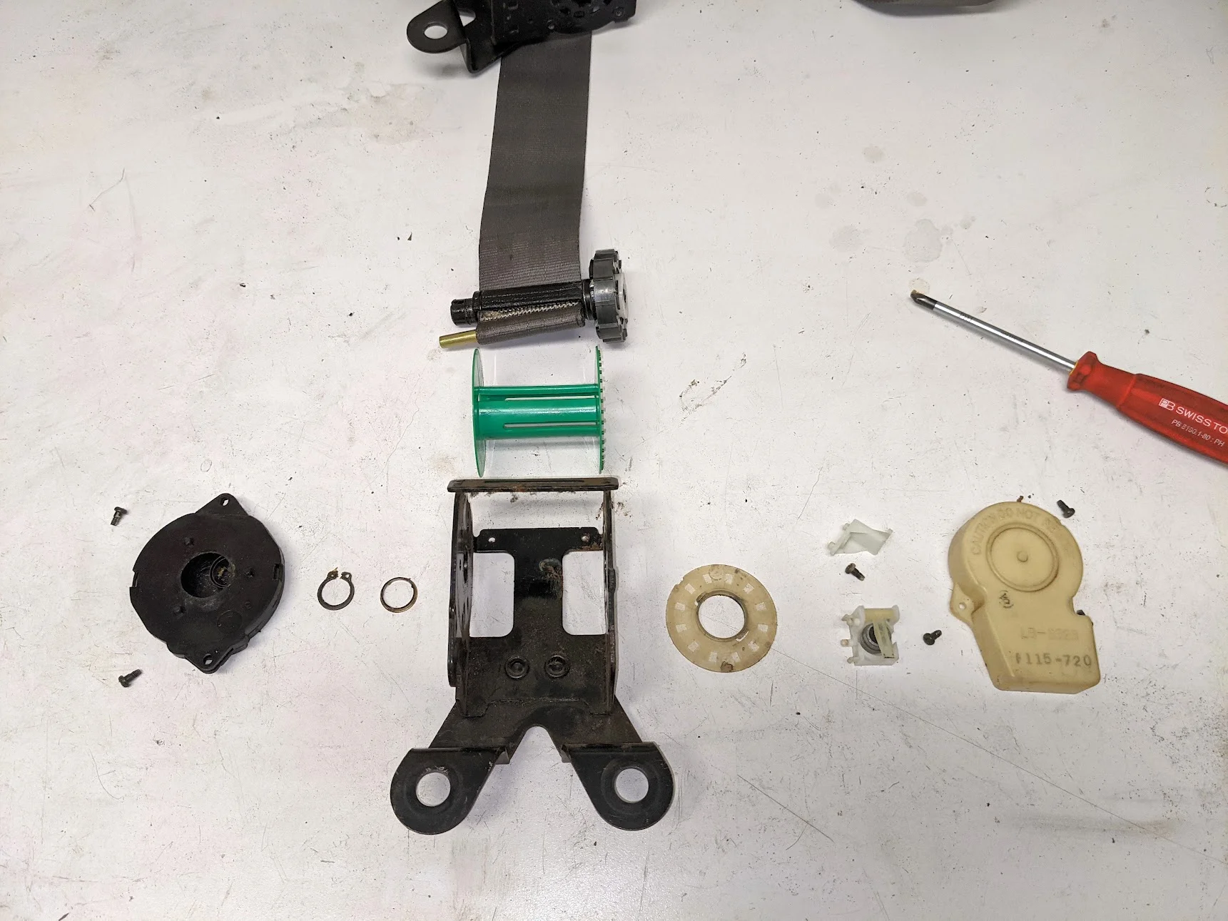

I havent messed with the front belts, but rear shoulder belts are quite easy and simple to dissassemble:
