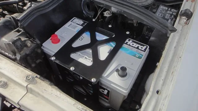

One went in my '93 FJ80 with a slight adjustment to the hold down, and the other in my '91 Q45. I'll post a few pictures of the Artec Industries Battery Mount in the FJ80 once I get them off the camera.
i'll post a few pictures of the artec industries battery mount in the fjz80 once i get them off the camera.

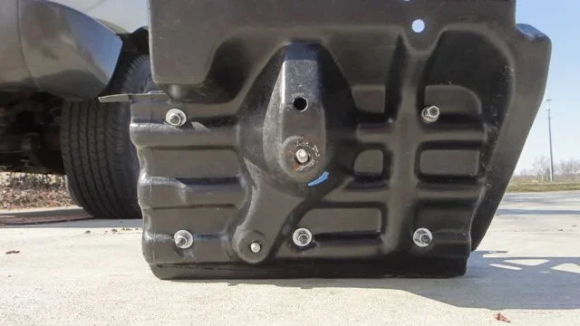

I purchased the Artec Odyssey PC 1750 mount in black powdercoat with a 6 bolt mounting kit and drilled and mounted it to my battery box. It is a heavy duty mount and holds the battery well in place. There was just enough room to access and tighten the two lower battery box bolts through the two cut outs at the bottom of the mount. I used a thin racket style wrench for that.
The back of the battery box was already partial cut out, so I cut a bit more so the flare with the 3 back bolts extended through.

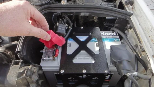

With wires connected. On the positive side a Napa military terminal and on the negative side a knob style disconnect (under the boot). I found the boots on eBay.
