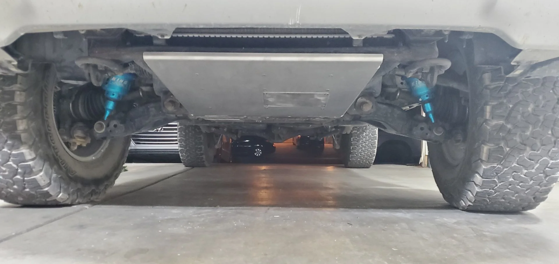

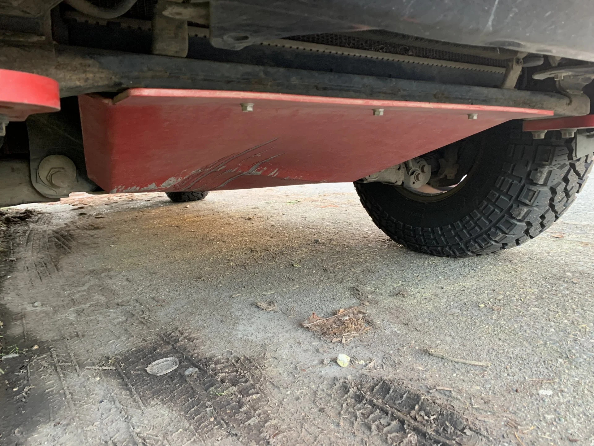

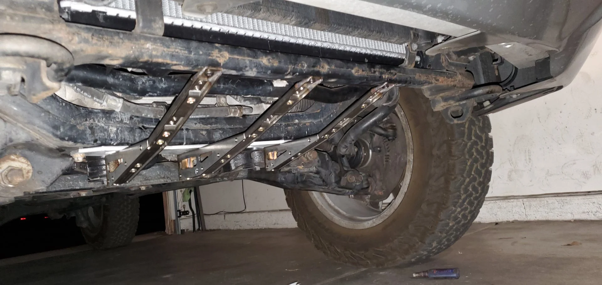

Yeah, I form fit my AL TC front skid to that front diff space going too fast and braking too late last summer. Very hard hit into a cross road ditch type obstacle. I was pretty glad the airbags didn't deploy.
This pic kind of shows the deformation into that area.
When I made mine, I made supports to to protect the middle of the skid and the diff mounts. I did not want mine to cave in like that.
It looks like it did it's job though!

I really think the 200 series would not have had any issues with the same impact. Look closely at the images below and let me know what you all think...

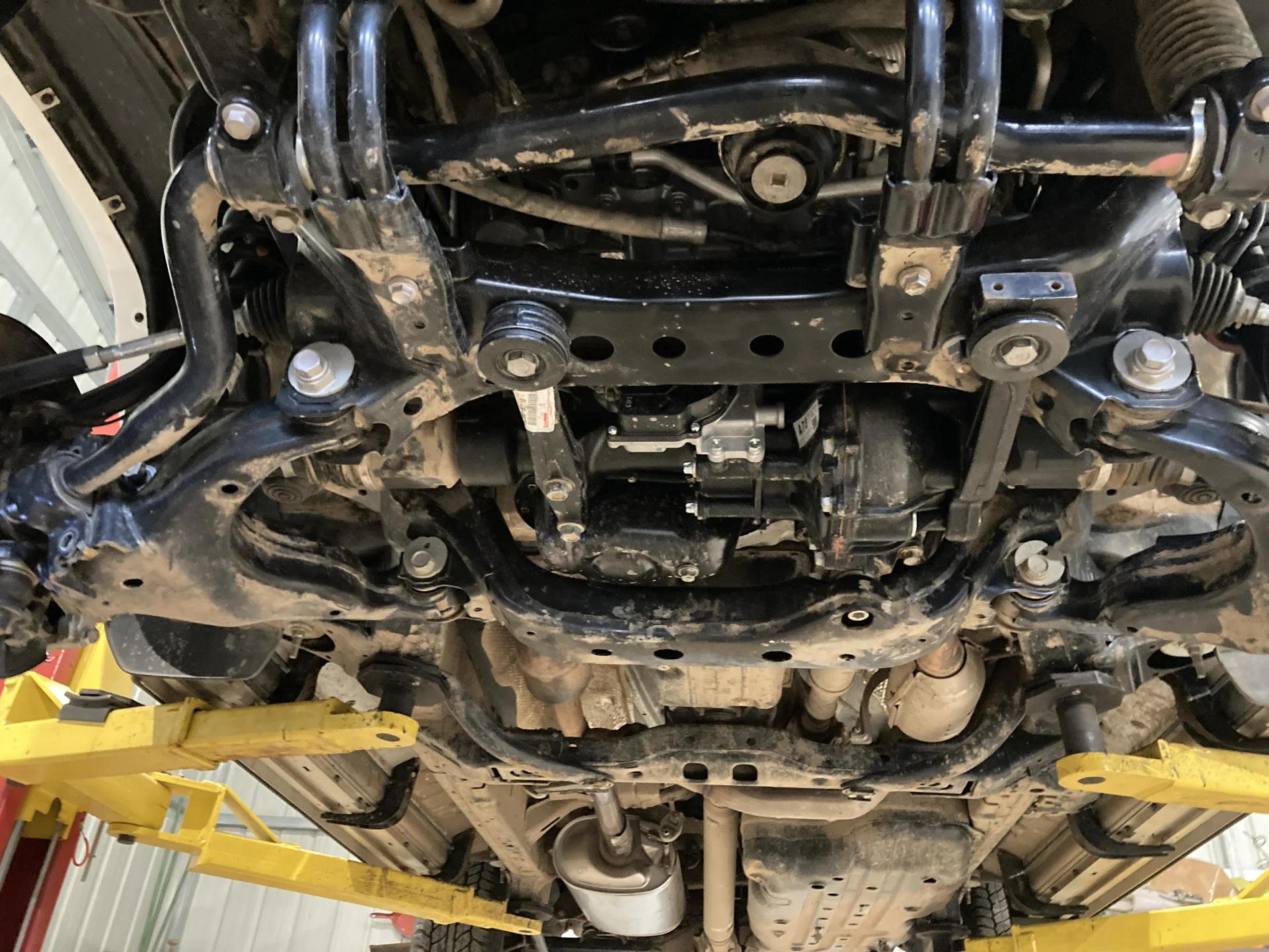

The damage to my 4Runner:

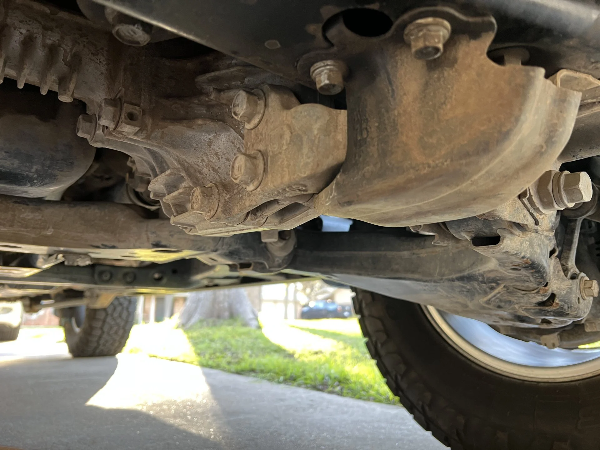

4Runner Front Diff layout and Exposure:
Your 200 series with it's diff mount guard:
Just to be clear, I do think if the tires dip down into a hole and set the diff on a rock your failure could happen here. But it would be less likely in a forward impact with a rock.

I definitely agree with your assessment, and I really appreciate you taking a look and thinking this through with me here- but in my scenario I can now see exactly why my 4runner diff had it's issue and I am fairly confident that the way your 200 front diff is set up would have prevented that from happening.

I do agree here. There should be enough beef with the LC covers to generally handle an incident like this. Once at least as they are really made to be sacrificial to absorb and protect the rest of the car from incidents. Not necessarily repeated abuse. Even the stoutest of aftermarket skids, somethings going to give, and it's not likely the rock.
Not sure if this was a factor, but one criticism of IFS is that with braking, downhill, or downward load, that clearance will be reduced as the suspension flexes. Versus a solid axle where clearance at the lowest point generally never changes. An often shared driving strategy when hitting rocks and other things is to put the tire on it rather than to straddle. This strategy can also protect sidewalls of the tire as it puts the meatiest part of the tread on the obstacle.

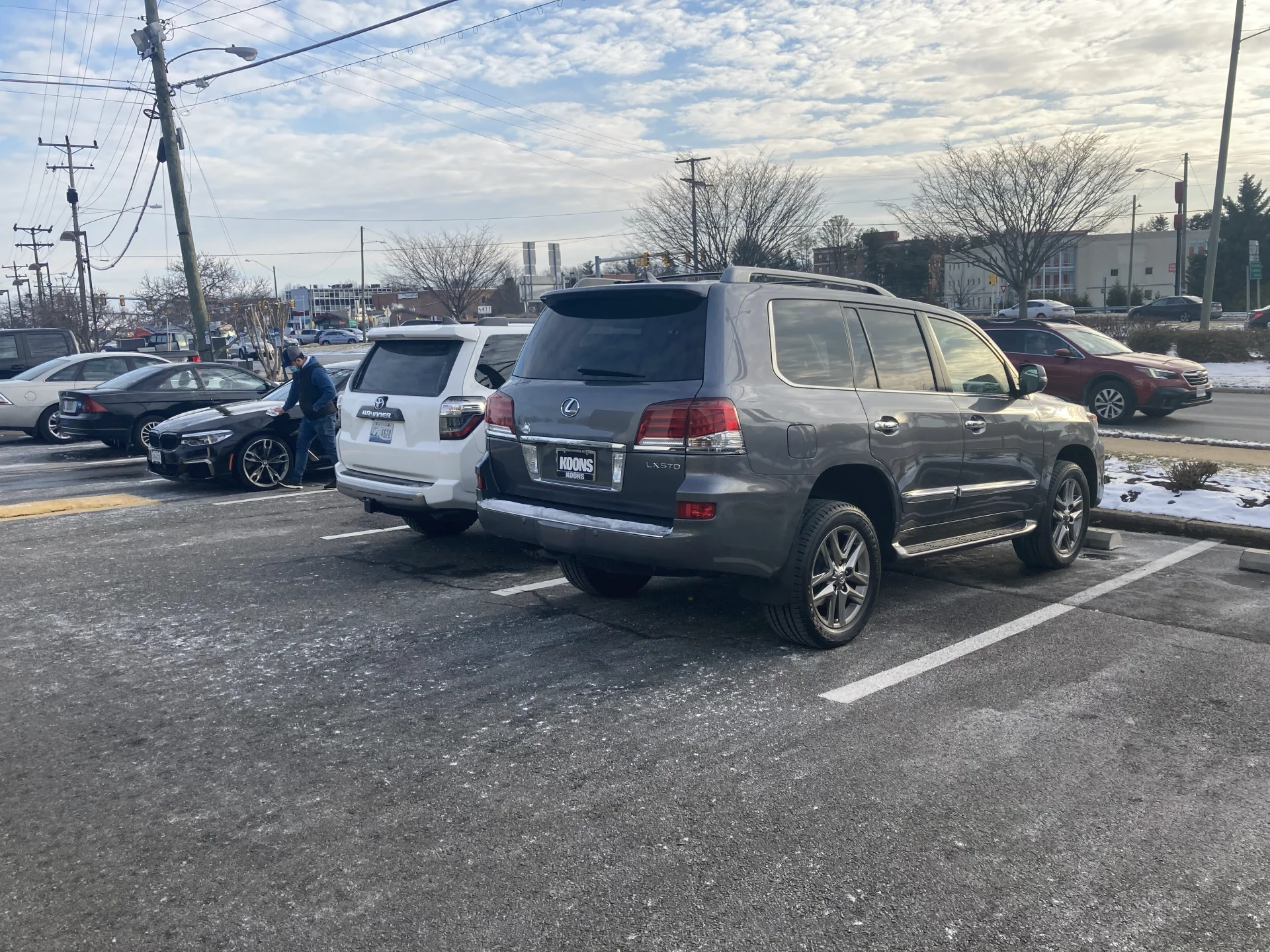

Almost... almost traded my 4Runner in on this spotless 2014 LX570 with 54K miles on it yesterday... Got really, really close but couldn't make the numbers work. It was a beaut... I'm hoping I'll snag something pretty soon or maybe head back and snag this one this weekend. The Nebula Gray Pearl is perfect for this truck 🔥, but I would prefer black or grey interior Vs the tan interior:
I love how your Airstream 27FB is just a line item in the mods on your signature... LOL... nice "mod"... :)
I love my interior but there is no option for the grey past 2015. That is a great and rare combo, less chance for staining and monochrome! Never seen one when i was shopping.
