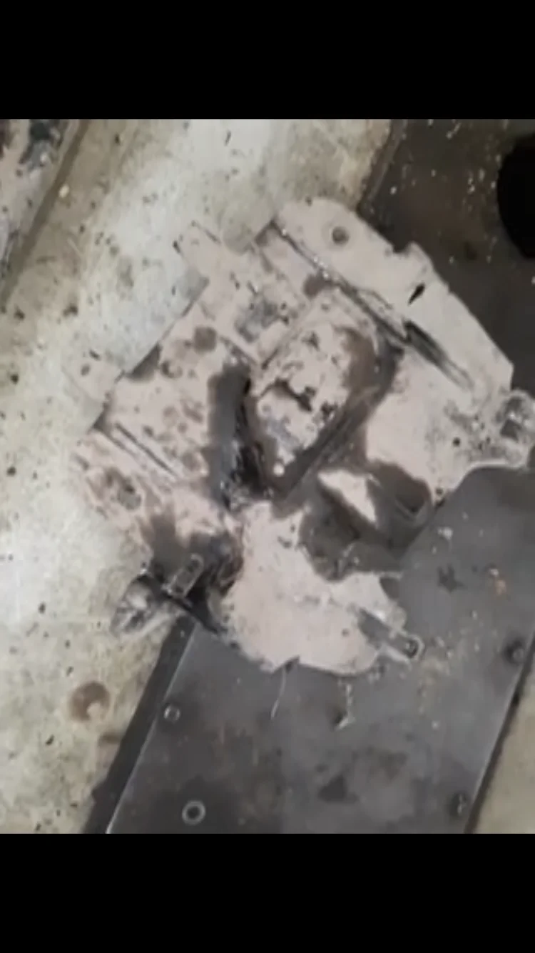

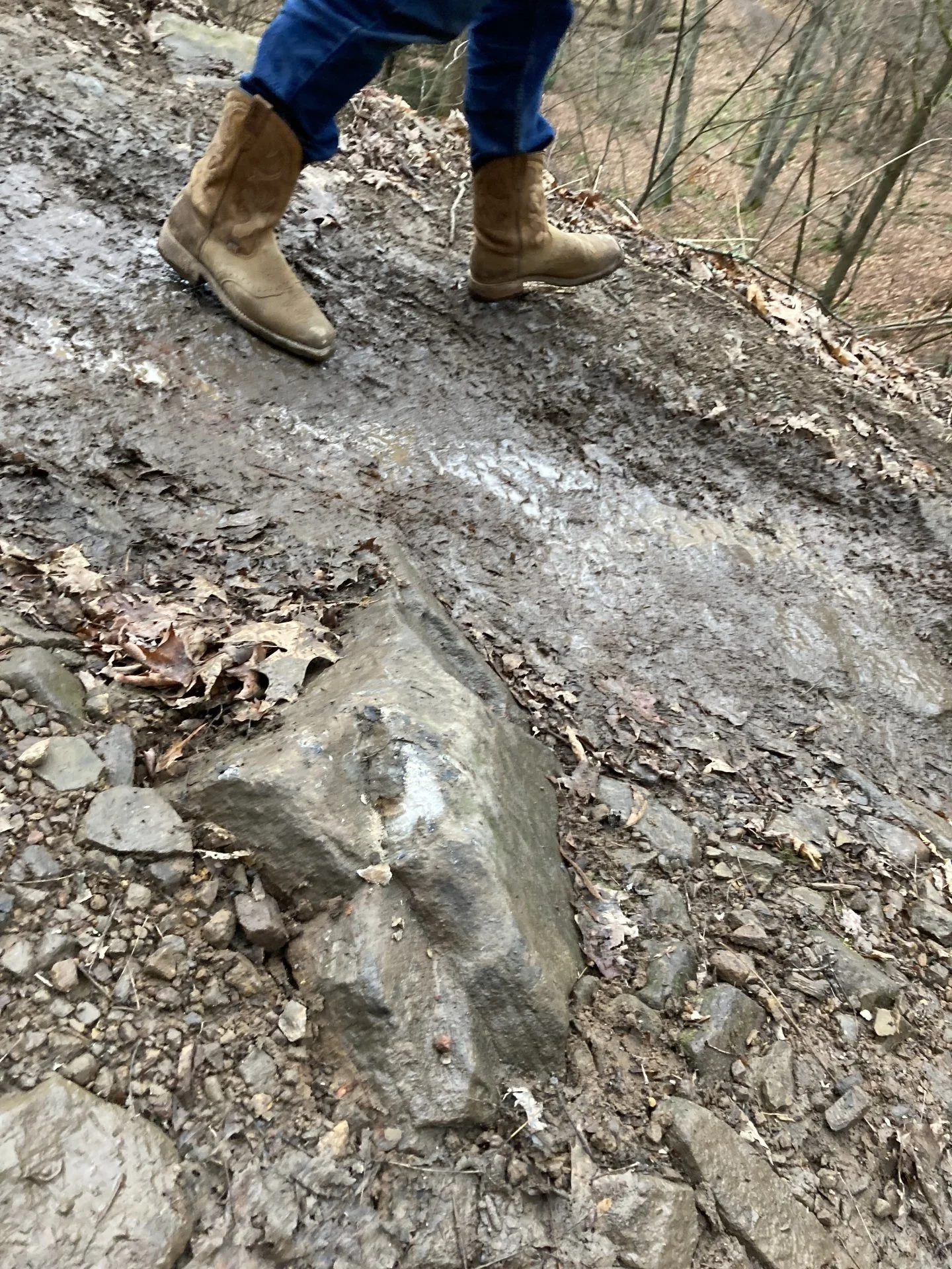

I recently had an unfortunate encounter with a rock that surprised me. In my brand spanking new 5th gen 4runner last month a rock about 3-4" tall, paired with a 5-7" dip in the trail, took my truck out of commission at about 8mph. I'm used to hitting skid plates every now and then, but this hit pierced through my OEM skid plate (Toyota calls it a "Splash Guard") and pushed the front diff up into the lower and upper oil pans, cracking all 3 of these components. I shut the truck off immediately after the impact and hopped out in time to see the oil start flowing out of the bottom of the truck.

Sorry to hear about your misfortune. It's sometimes hard to tell from pictures, but that rock looks like a non-event. I'd just drive over it with zero concern (but I'm mildly lifted and fully armored). If it is a potential issue, you could pick a line where your diff clears the rock. Tire on the rock, for example. I don't see why anyone would go offroad with stock tupperware. Even the most expensive armor is still cheap insurance.
Pics are hard to judge, but that looks like a non event to me too. One in a trillion stuff can happen though. Eventually someone wins powerball and all that.
I’d say never on the 200, but the 200 ships with a factory plastic skid under the oil pan, which I absolutely didn’t trust one bit, so I guess it would be a very unlucky maybe. No way that plastic skid was going to take 6k lbs on a point impact.
It is really hard to judge from pictures, but I can confidently say that I have hit much worse in my LX with the stock skids. Coming on that on the trail wouldn't normally even register with me.

Thanks for the thoughts here. Having been going offroad for a few years in my GX470 I’ve had plenty of hits on the factory skids and this hit felt different. It was a huge thwack not a glancing blow like usual. And the small rock didn’t even visually register as a potential threat- I saw it and happily rolled right over it. The impact really caught me by surprise and the oil pouring out after impact was completely shocking. I’m still not really sure how this could have possibly happened but it did.

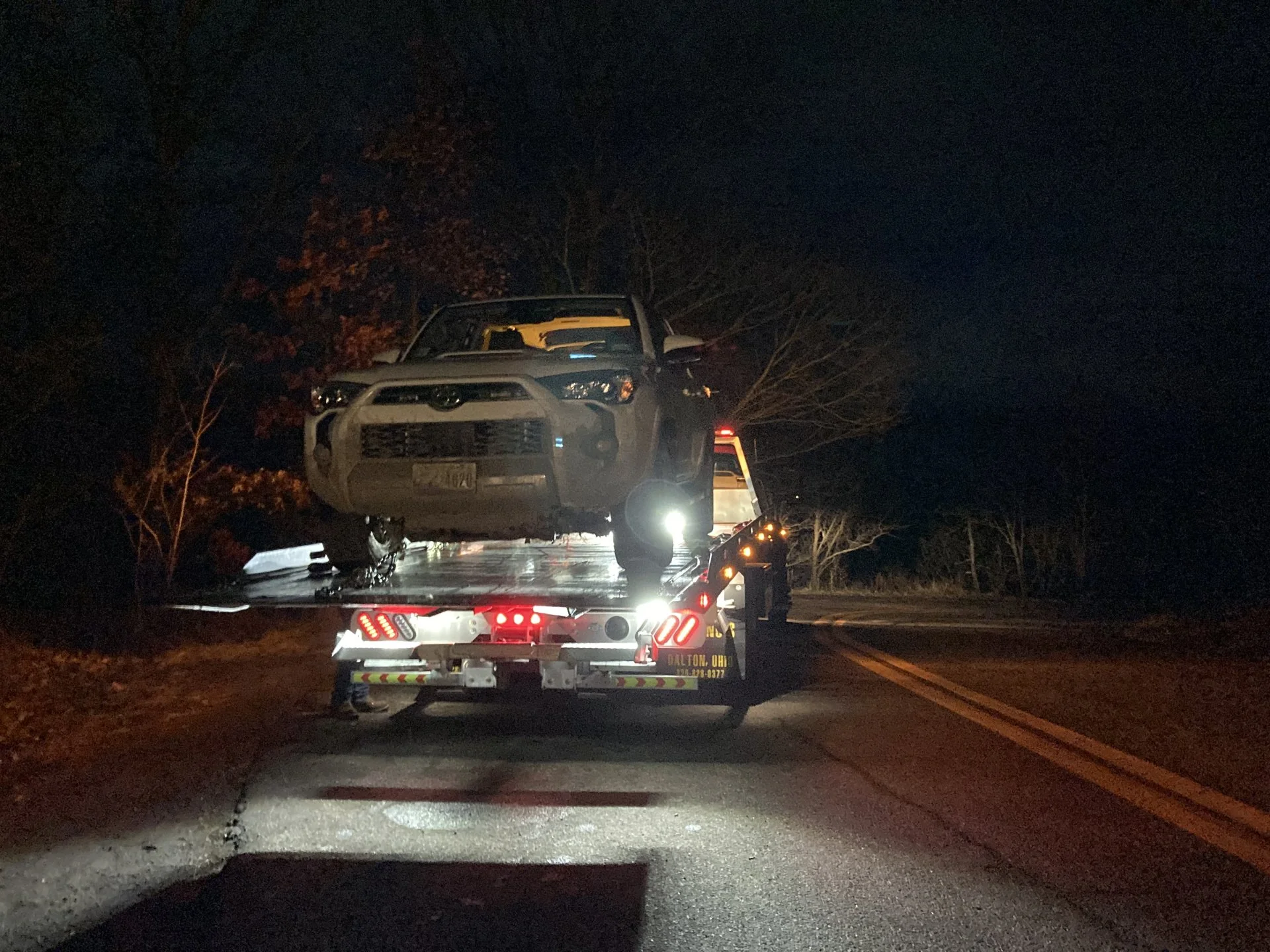

Yup, Appalachians. Getting Toyota to send a tow truck up was an "interesting" experience using their call service center that was routing through the Philippines. It took 4 hours to get a tow truck out and the Toyota phone reps couldn't get the location right so they sent out about 4 tow trucks before they finally found me. It was very frustrating but it did work out in the end and they towed it to the closest dealer who worked with my insurance company to get all the needed repairs done. Now I'm worried nobody will pay full price for the truck because of the entry in the Toyota system and carfax, etc. If that's the case I may be better off keeping it.

Just looking at the pics, the rock is not high. Can't even imagine it will cause such a damage. That's sux. Hope things get sort out.
