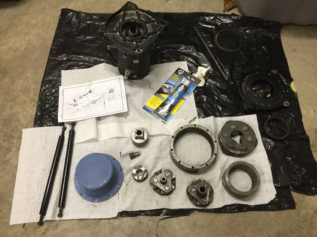

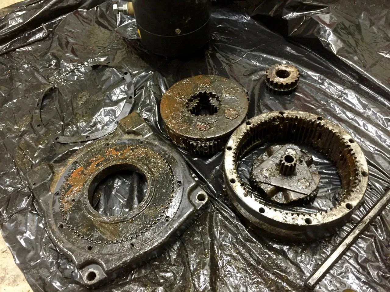

I have a Warn VR12000 that I bought back in 2014 that I've rebuilt before and it's amazing. No issues whenever I've needed it and it's a work horse. Still have the steel cable too which I don't know if I'll ever get away from. Initially I had issues with water intrusion but that didn't shock me because it was not advertised as waterproof when I purchased it. I tore it all down & cleaned it up and it was surprisingly simple; just a series of planetary gears. Used different seals & some silicone when I put it together and I haven't had any issues since. Their newer VR series winches (VR Evo) are advertised as IP68 waterproof
