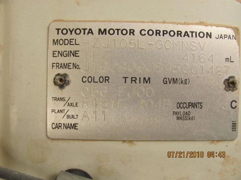

Not sure what yer building, but you might wanna think about an R150...
I know chain drives are eww, but I've never heard of one breaking... And the low range is just a tad lower than the gear drive.
I can't speak for the shifter locations and if the X member will fit, but I do know that joker's heavy duty... It's used behind the 1H(?) in country's that have a lick of sense...
attachment.php
I'd go w56. If I remember correctly from an old post on another forum, the guru Marlin claimed them to be about 20% stronger than G52. Or go all out and go for the R151, but beware that it is hard to find as it only came in 1986 and 87 turbo pick ups.
