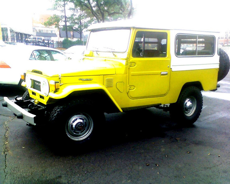

I spent the evening in my shop going over this rig. I found some stuff that I am glad I found. Plenty of loose stuff like motor mounts, seat mounts, bumper mounts, etc.
The front driveshaft is toast. I will pull it and get it rebuilt here locally if I cannot find a replacement in decent shape. The guy that imported it called it having a frame-up restoration, at best it was a thorough paint job. Everything looks nice and rust free. It had a fuel leak at the OEM filter (which is a type I had never seen), so I replaced the old filter with one from NAPA.

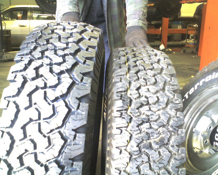

I plan on driving it to work tomorrow and then down to a fellow Cruiserhead's tire shop to swap these 30x9.50x15's for some 33x10.50x15's. I like the looks of it better with some real tires.
Henry C said this model never had hubcaps, but I will probably run them anyway. I like the classic look.

Oh ye of little faith! Didn't jtoro above confirm what I told you yesterday?! :beer:
I like the classic hubcap look too, they just weren't stock.

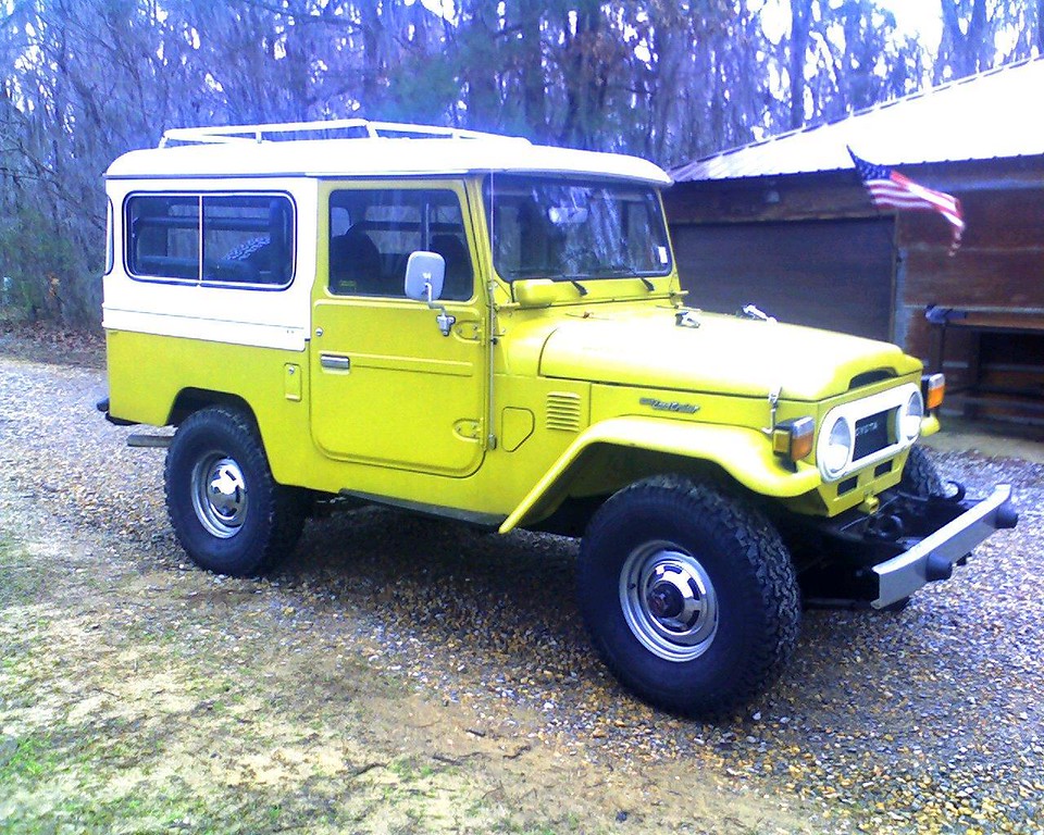

I got the tires on, the GAY chrome mirrors replaced with OEM ones and some immediate maintenance done.
This thing is unbelievable. Super tight. The 33's made a world of difference in the way it drives and handles. The RPMs with the 30's on the highway were awful. Now they are perfect.
The High Output 2F from Man a Fre is killer. I have never driven a really tuned 2F with stock tires before. Wow, it is actually peppy. The H41 has the low 1st gear and it is pretty cool.
All in all, I love it. The interior is perfect but the underside needs some love.
I want to start with the front axle and work my way back taking it apart and cleaning it and replacing all of the seals, gaskets and bearings.
It will be fun. I miss messing with Toyota stuff.
