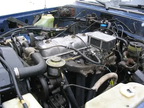

I got some metric stainless bolts from mcmaster. My P.O. did a hack job on the air rail...looked like he twisted the lines up with a pair of vise grips.
What is the correct size? Because jtoutfitters said they had some and they sent me the wrong part. and they have yet to send me replacements. (back in december)
If you haven't bought air rail plugs yet, 1/4" NPT plugs work great and they're wicked cheap.
I just want to get the correct fit. American sizes and BSPT are two different things. I'd rather get the right thread pitch if I can.
I just looked in my records and I got M14 x 1.5 x 30mm bolts to go into the air rail from mcmaster. I also got the ones from JToutfitters as well, but they were M12's
Here's a pic of my setup. Notice the bolts for the air rail. I left that mechanism in the intake to fill the other hole but it is blocked off. I have added another vacuum port for the PCV valve which is not shown here.
So those bolt right into the head? not to those things the rail bolted into? its hard to see from this angle
correct, these bolt directly into the head and they were pretty damn tight but you might think about using loctite to ensure that there is a good seal.
Thanks a lot dude.
Now if i can only figure out what size that vacuum thingy is
