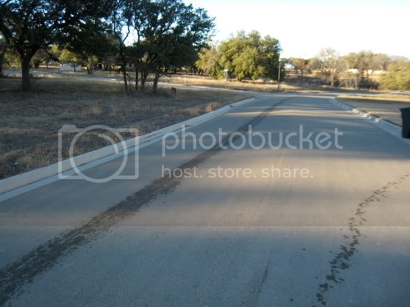

Hmmm this can't be good...
Found this little bugger at the start of the stream.
I somehow managed to blow a freeze plug :lol: :lol:
