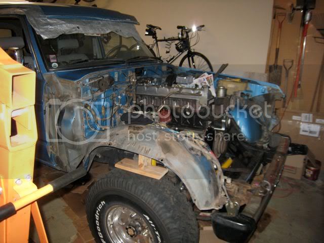

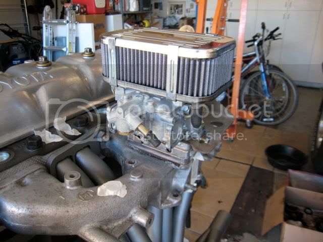

Got the carb on.

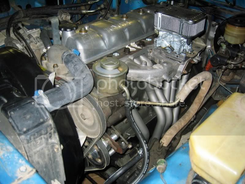

This weekends progress...

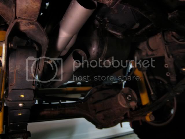

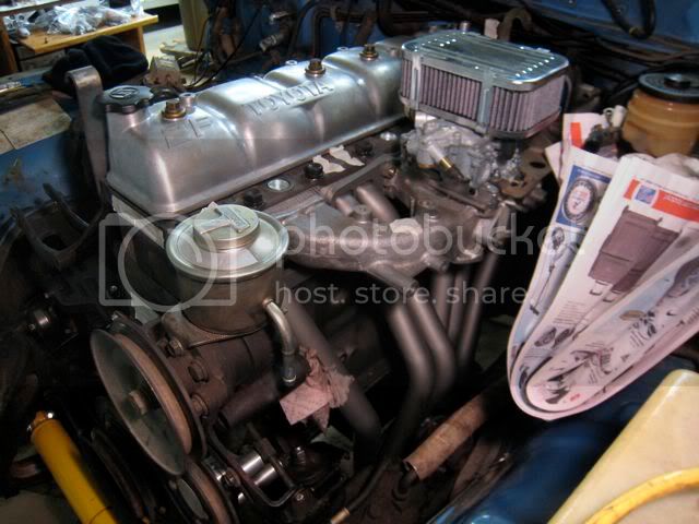

Weber and Header.
Trying to show where header exits.
Told ya'll i'd get something done :flipoff2:

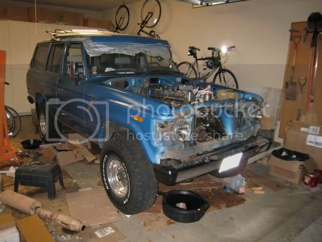

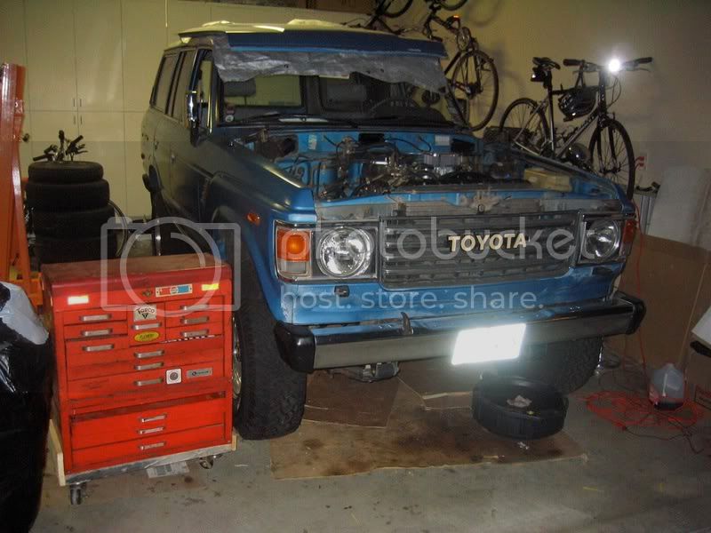

It looks like a car again!

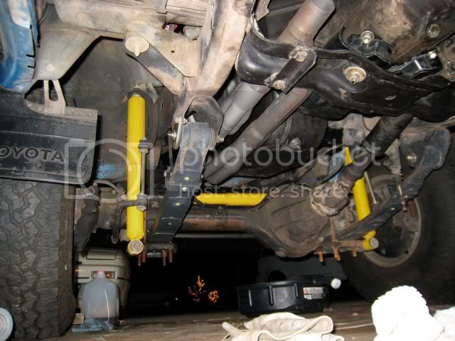

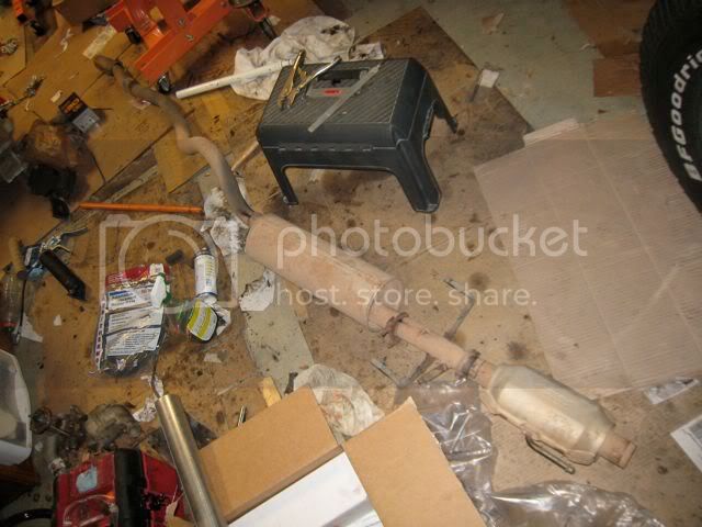

Y pipe attached

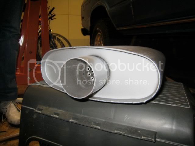

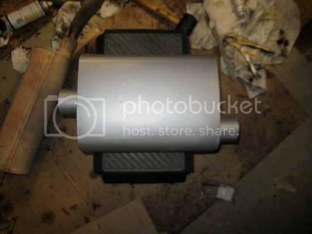

Summit Fully Welded Muffler 2.5 inch in/out $37 :banana:
Here is the old. Thats the original muffler :eek:
Summit is awesome. Ordered on Monday night here today at 3. Ridiculous. I also got 4ft of pipe and a Catco cat (all 2.5) plans are to put together what we have then have the exhaust shop bend a tailpipe.

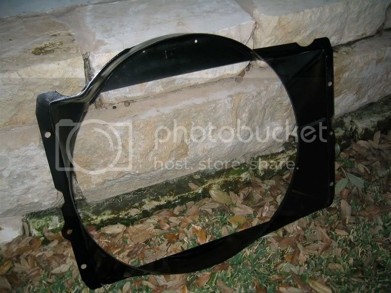

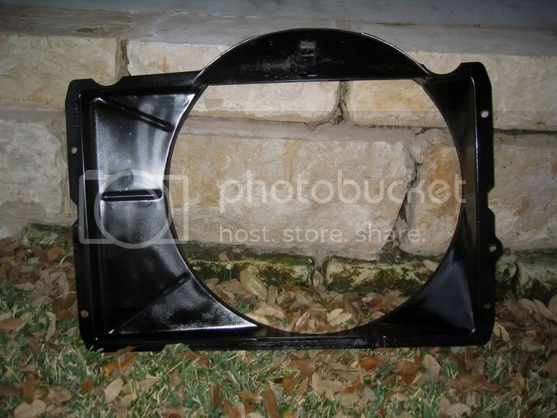

Felt like painting because I am waiting on my parts that should get here tomorrow.
Almost like new!

It is looking good. So when you going to start the engine?

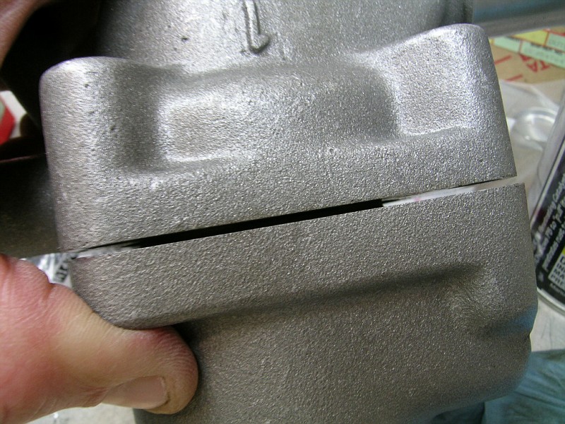

Dude, i'm curious as to how your thermostat housing seals up. Please let us know.
I mock put my new stuff all together with the o-ring and thermostat and it looks like it will need some torque down to squash that o-ring. It was minus the housing gasket mind you.

Hopefully before I go back to school which is January 5th
Have you read about splitting the radiator shroud to make future access easier?
Nope, that sounds like a good idea though. I'll look into it.
Joe
I'll let you know. If my parts come today :hillbilly:
I was planning on using the housing gasket and some blue RTV to make sure i have no leaks.
Got my parts today.
Installed thermostat, fuel pump, and a few hoses
My housing also had gap when placed on thermostat and o-ring.
Got 4 new bolts from Autozone because one of the old ones broke. I think size was M8 1.25x40mm. Had to have them all match :) Just tightened it down with gasket and blue RTV and no gaps!

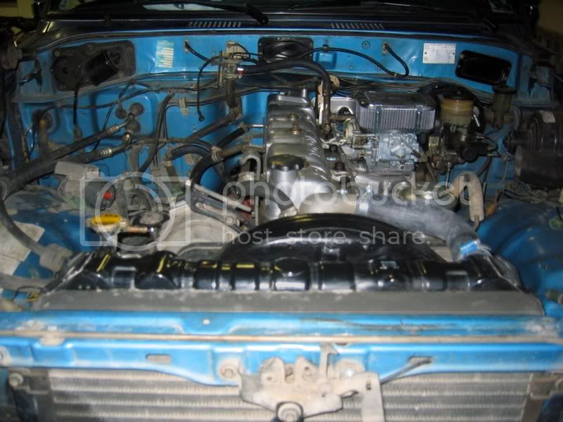

I got some work done today.
  • Belts on
  • Radiator/ Fan/ Shroud in
  • A/C Condenser on
  • Heater hoses and radiator hoses on
  • Power steering lines on
  • A/C Lines installed
  • Front end put back together
Still got a lot more to go. But i'm excited about this progress.
I forgot the grill went in before the headlight trim it has been so long since i messed with it haha.
Once i got going i didnt feel like cutting my freshly painted shroud so i just left it

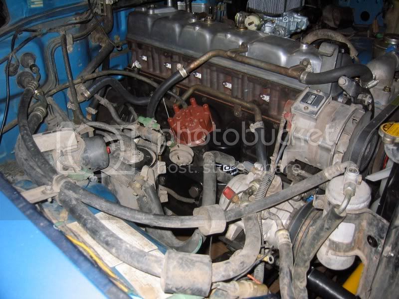

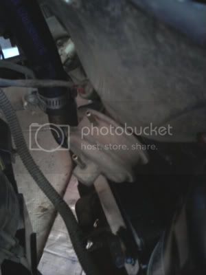

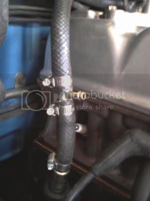

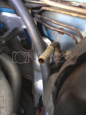

So I got a few loose things to tie up before I can get things ready to go.

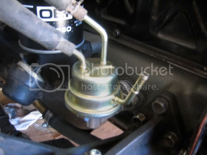

Just need to know what these things are / where they go.
I know thats where the T goes but where does the line go?
Brake Booster Vac? it comes from charcoal canister
Vacuum to something I don't have? (desmogged)
This is on the passenger side fender right next to the battery. No clue. haha
Thanks Guys!
Pic 1 is the PCV circuit, and I believe it connects to the air cleaner ( I believe ).
Pic 2 is for the EVAP system. Hose plugs into the hole in the middle of the carb insulator.
Pic 3 are the two vacuum advances for the dist. The secondary ( smaller ) one is the HAC compensator, and I don't recall where the primary one connects to.

Well sounds like I'm removing the first one.
Plugging in the second one to the weber
and capping the ports on the dist.

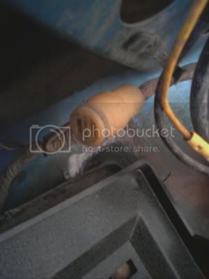

Any takers on the random plug? :D
