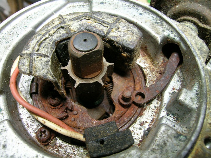

The port on top of the dist cap plugs into a VSV that clips onto the bottom of your stock air cleaner. It draws air through the dist to prevent any detonation of fumes inside the dist cap.

The idea is that it draws air through the dist, with a regulating valve to control when it draws air......

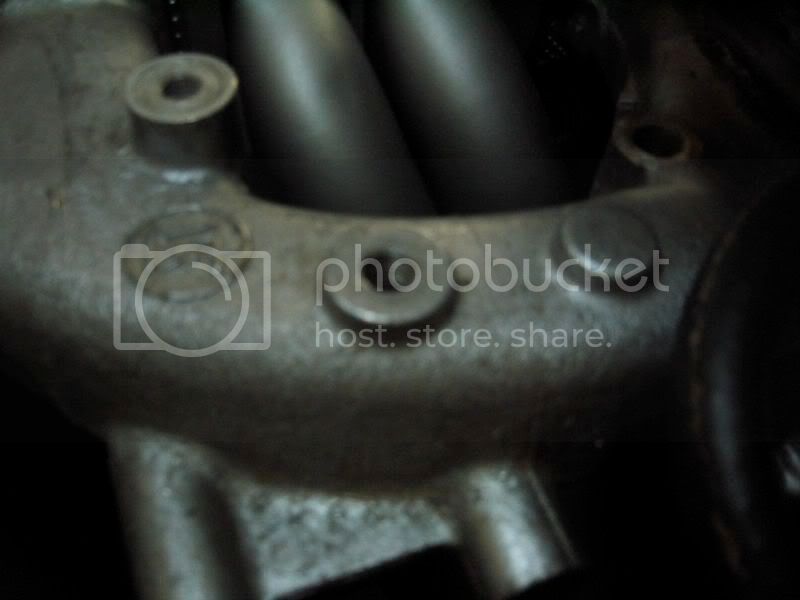

Got all the PVC/ Vacuum Lines hooked up. Tried to make it simple, and hook up things that make the most sense and are as close to OEM as possible.
What size bolt will fit in here?
Thanks Guys!

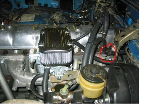

Do you have a vacuum line on the primary distributor advance? My truck doesn't run properly without it. Actually I just checked my setup and the secondary port on the distributor goes here:
Not sure if this is really correct, but it seems to run fine.
