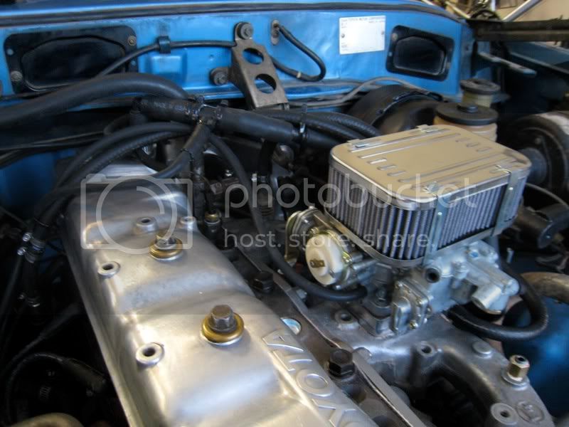

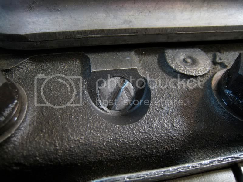

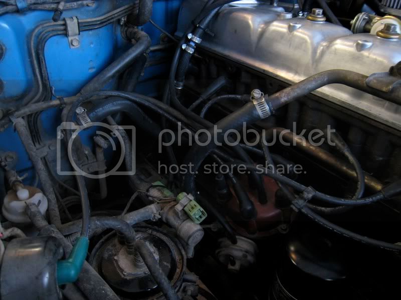

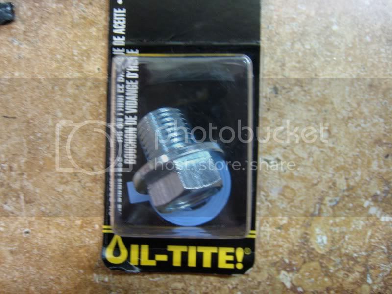

Got Air rail holes plugged, intake hole plugged, and vacuum lines redone.

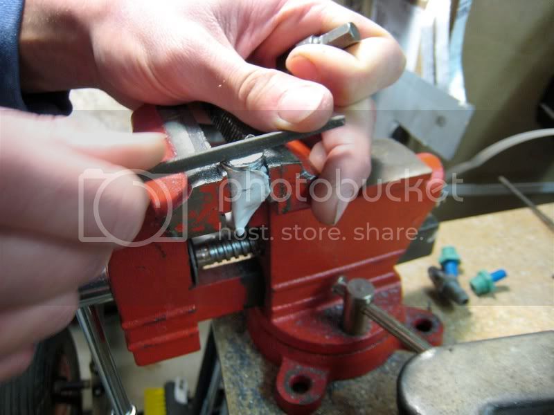

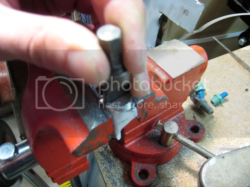

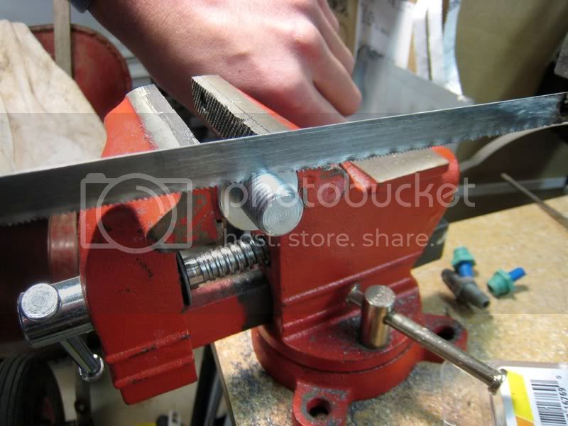

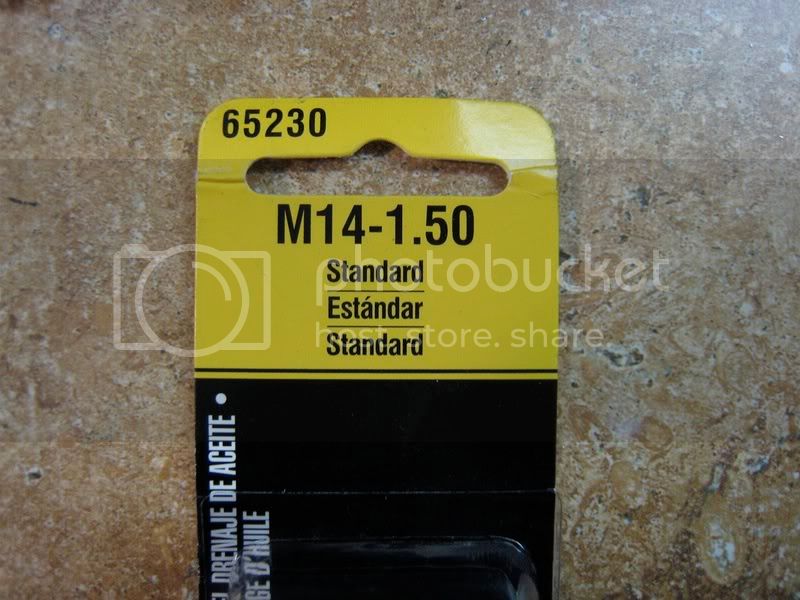

For the Air Rail holes I used Oil drain plugs (M14x1.5) that we slightly modified :grinpimp:
Doorman Part Number 65230
Here's how you do it:
First hack off the head of the bolt.
Then use hacksaw to make flathead screwdriver slot. And file for more width.
Make sure it's a good fit.
Install with thread sealant.
Now for the intake hole:
Found Equus part #9841.
And some pictures of my Engine for good measure:
Hope to start her tomorrow after we bleed the brakes, bleed the clutch, install fuel line, and I'm done with my Statistics Final.
Here are the ones that I got. 30mm long so that the head and socket would not interfere with the engine. I think your solution looks good, but not sure how easily you will be able to get them out if needed in the future...I guess it depends which thread lock you use.
