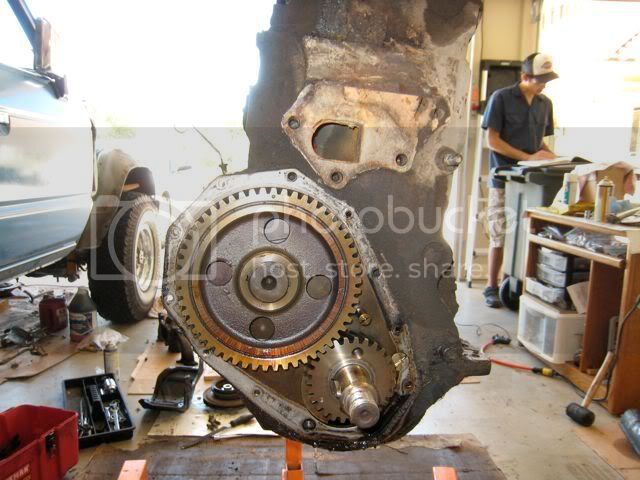

So after a harbor freight ratchet set, a bolt, and a piece of angle iron later...
Finally got the turd off. My brother drilled a hole in an 1/8" thick piece of angle iron and bolted it to the block so that it was in the teeth of the flywheel. and we bolted it down reall tight and then we got the wrench on there with about 3.5 feet of leverage then i stepped on it and it popped loose.

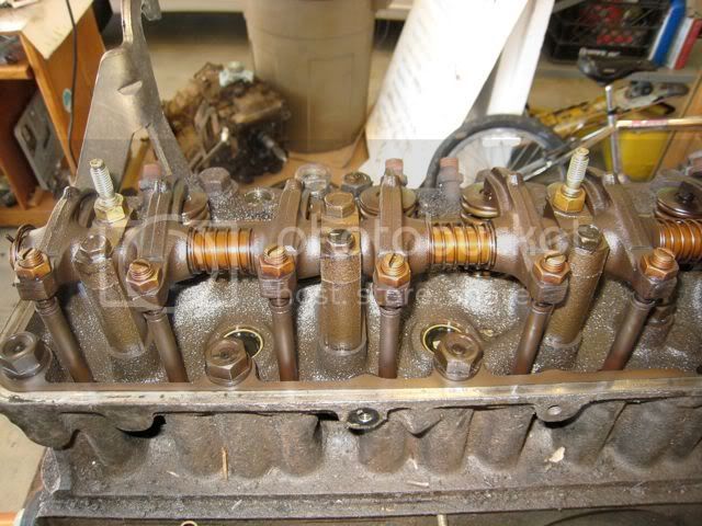

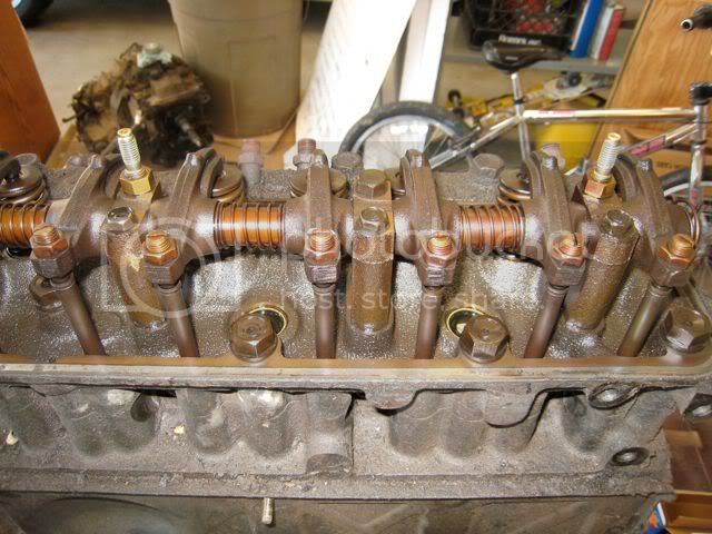

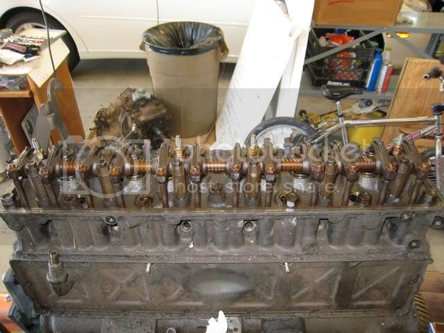

Popped the valve cover off.
1 through 3
4 through 6
Gonna tear the top and bottom end apart tomorrow and hopefully get it ready for the machine shop to do its thing.
Booyah! Lookin good, but make sure that the machine shop remembers where to put the studs back. I've heard a couple of shops putting studs into the wrong holes.
