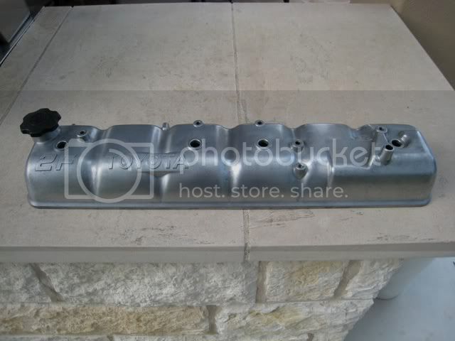

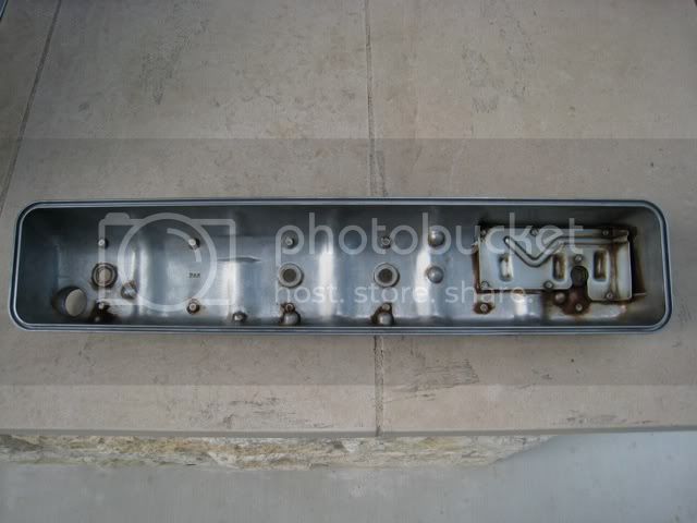

1-3
4-6

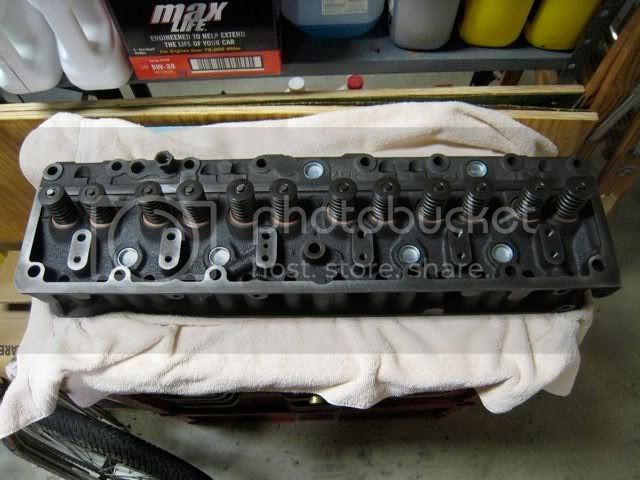

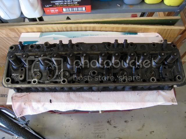

The Head

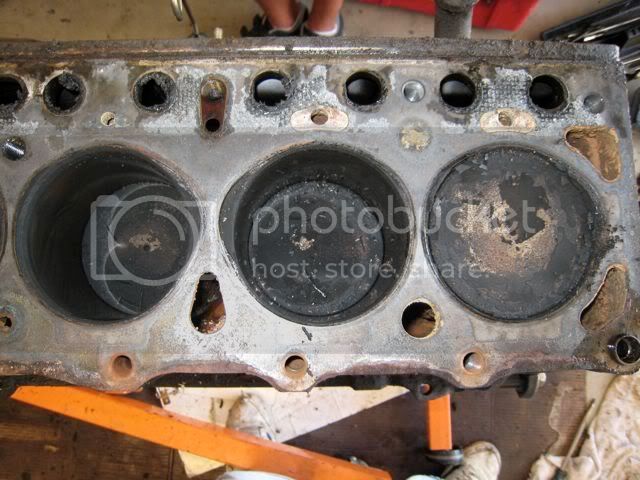

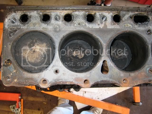

I should have took pictures after I cleaned the head gasket off the block. :doh:

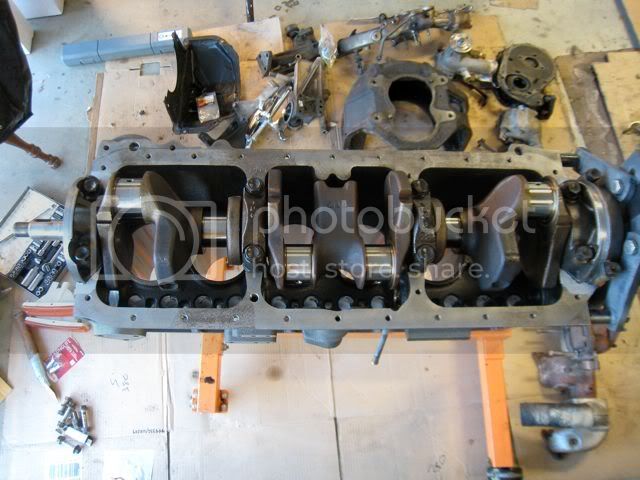

More Progress :bounce:

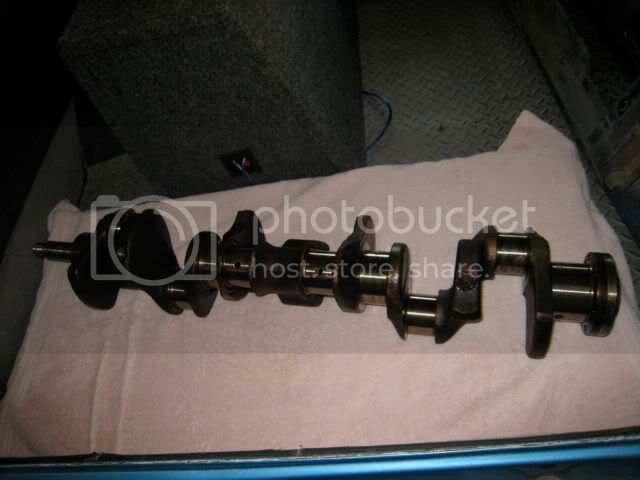

Picture of the crank. It's in the back of the cruiser haha.
Block, head and flywheel going to the machine shop tomorrow morning :banana:

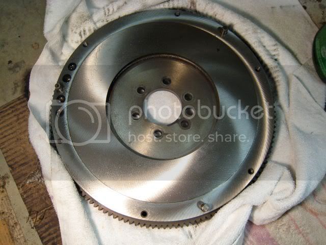

oh the flywheel is fine. the starter doesnt spin the engine very fast and none of the teeth were bent or badly scratched. so were in business. :D

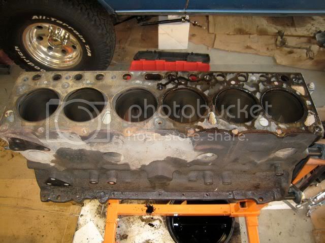

First off it wasn't in the machine shop this long.
I have been really busy with Marching Band, it's state year and we haven't advanced since we won back in '96 so our directors are making us work harder and hoping to do well in state competition. And by "work harder" I mean I have more time now that school has started then I did during summer. No Joke. But anyway...

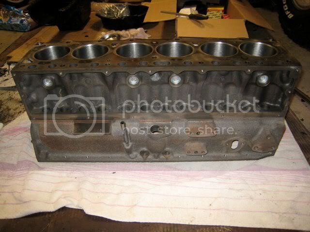

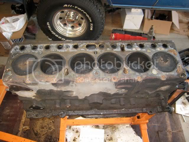

I got the block, head, and flywheel back about a week and a half after I left it there. Only $234 :)

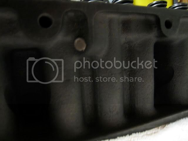

It looks like the machinist may have replaced the galley plug? I can't tell though. It looks kinda new...
And a shot of the mess

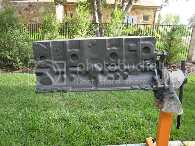

Gonna pick up some paint this weekend, and get her coated up. I'm not sure on the color yet though. I was thinking maybe Cast Coat Iron Block, Low Gloss Black Head, and cleaned up and clear coated valve cover. Any thoughts?
Thanks Guy's :beer:
That engine block is waaaaaay too clean for a 60 :flipoff2:
Oh don't worry. The only reason I am painting it is to keep rust off but trust me it wont be clean very much :flipoff2:
Hey the block looks great. I had my machinist tap the galley plug and put a set screw in it with some loctite...makes for worry free driving!
As far as clear-coating the VC goes, aluminum is hard to paint. You need to etch it with a special solution (2 in fact). I use Gougeon Bros. West System 860 Aluminum Etch Kit - might be able to find it at West Marine (no relation).

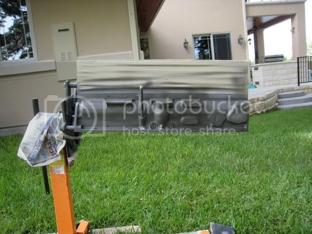

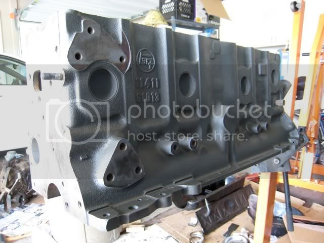

PROGRESS :bounce::bounce2::bounce::bounce2:
Tell me what ya'll think :D
Masked
Un-Masked
I'm excited about this as well....
I'm happy :banana:

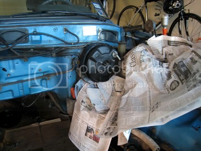

Long needed update.
Crank installed. Finally.
Brake Booster.
While bleeding the master cylinder we discovered the proportioning valve is bad. No brake fluid goes through the "R" marked section. Gonna have to get a new one.
