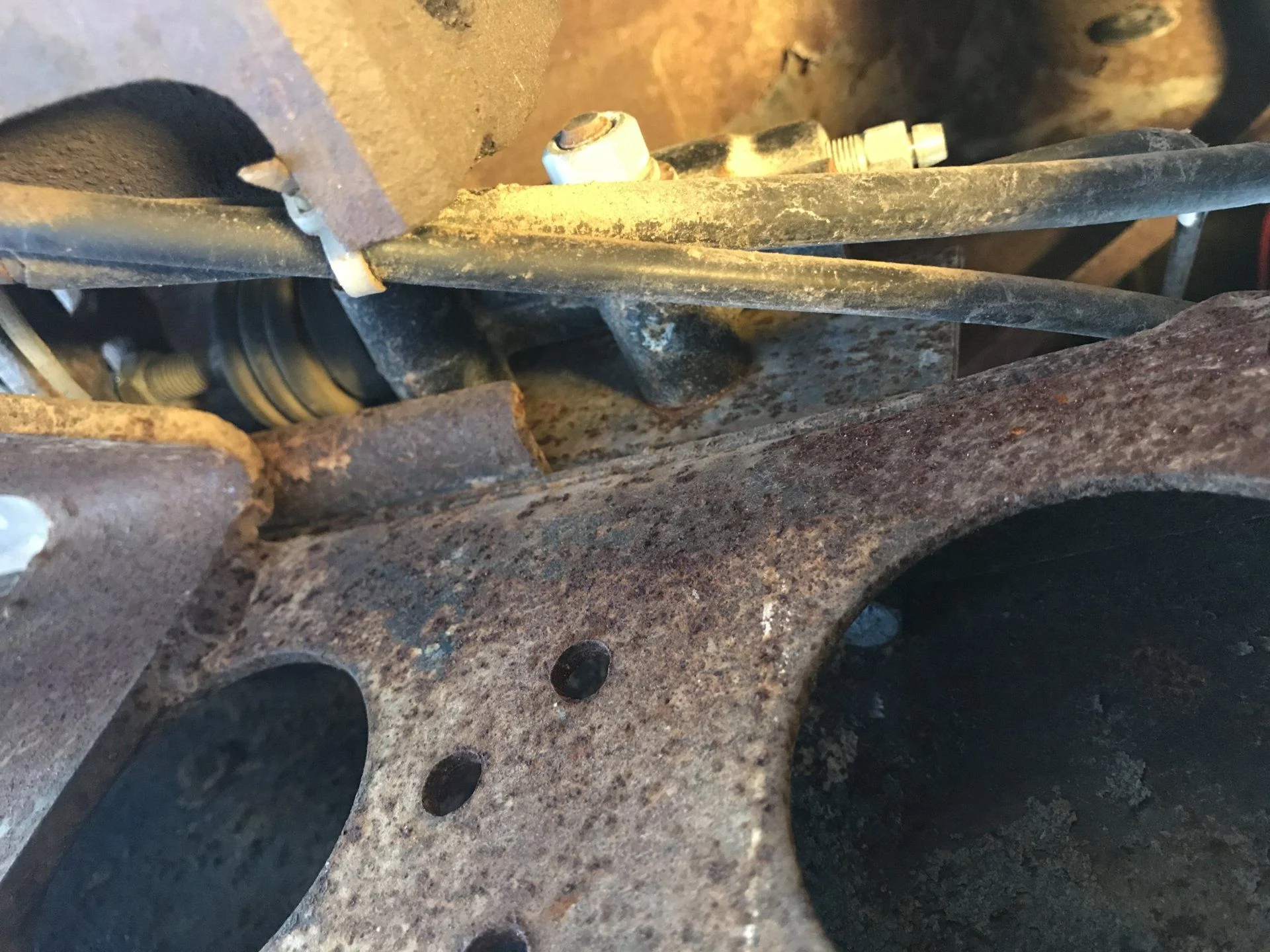

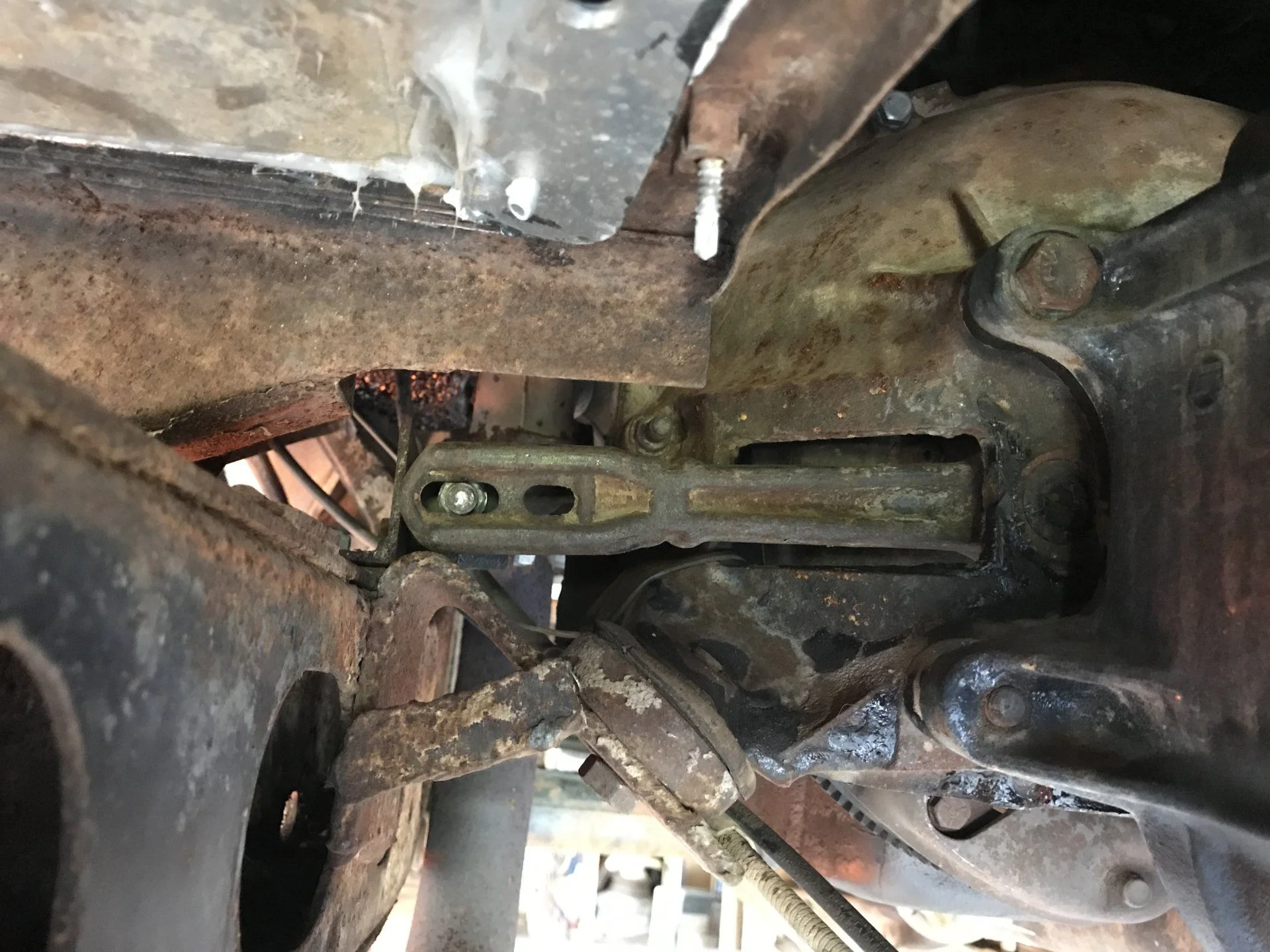

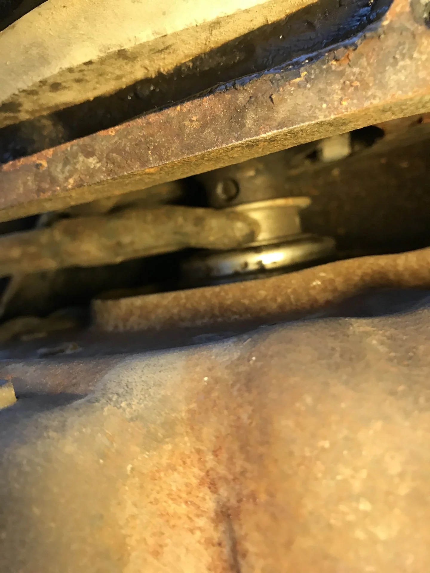

SBC, 3 speed. Hydraulic clutch.
I think my throw out bearing is going out, squalls when clutch pedal pushed in. Clutch fork keeps the bearing touching the clutch fingers unless I push the bolt back into hydraulic and take pressure off fork. I can see that I can adjust the preload (?) on the fork by moving the nut. That bolt/threaded shaft has a plain nut on it's end, just wedged into the fork, kinda moves around...is there a specific adjuster nut that fits the fork better than that? Seems like a rounded one would work better. Tried the search but didn't work for me right now.

Yes, I'm pretty sure most have a rounded nut with a lock nut. Looks like your missing a return spring too.

I'll second @pb4ugo - there should be a round adjuster nut that indexes in the clutch fork. There should also be a return spring to provide constant tension to "pull" the throw out bearing off the clutch slightly. With neither, adjustment is nearly impossible and you'll wind up with the bearing riding your clutch, and premature failure.

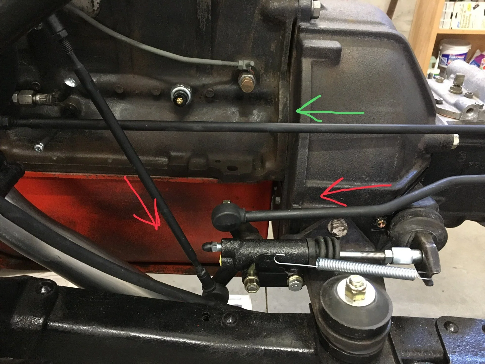

Something like this. Ignore the arrows.
I see some real issues with your set-up that I would discuss with you privately. For starters though, it appears your slave cylinder is mounted to a bracket that is welded to the frame ???. To correct this, look at my ebay #264275501163, 3rd photo. This is a slave cylinder mounting bracket that mounts the slave cylinder onto the bellhousing where frame flex/movement won't affect clutching. This bracket could be modified so that it points your slave cylinder push rod directly towards the inside hole in the shift fork- - -your push rod is presently pointed to the outside hole in the shift fork where it takes more slave cylinder travel to disengage the clutch. My guess is you were not getting enough travel at the throw out bearing to fully disengage the clutch, sooooo the slave cylinder push rod was adjusted to where the throw out bearing was always riding on the pressure plate fingers ALL the time, and that waisted the bearing. My other guess is you are running a regular Chevy clutch, which takes more travel to disengage than my Chevota specific clutches take.
I actually thought the OE clutch fork did not have those slots in them, only a dimpled area for the rounded nut to ride in. Also, side note….it looks like you may have a crack on your bellhousing mounting bracket (vertical weld from the bracket to the frame.)

That’s looks like the correct low profile pressure plate to me. ,he just needs to sort out his slave cylinder location and get the push rod in the other hole and it should work a lot better. That is if the TO bearing isn’t toast
That bellhousng looks funky. He might benefit from your rear tcase mount
Downey (Jim) also ya don’t see bellhousing mounts used very often on a V8 conversion. Shift fork may be worn out also sometimes the bearing will spin in the fork also wearing away the fork tips
