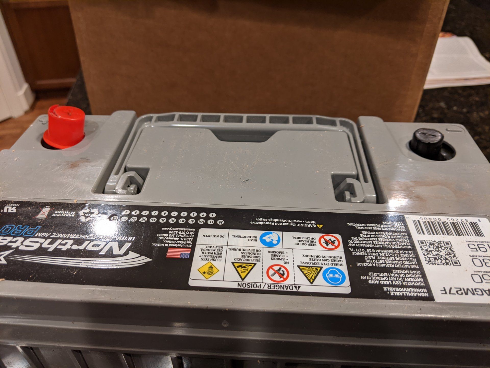

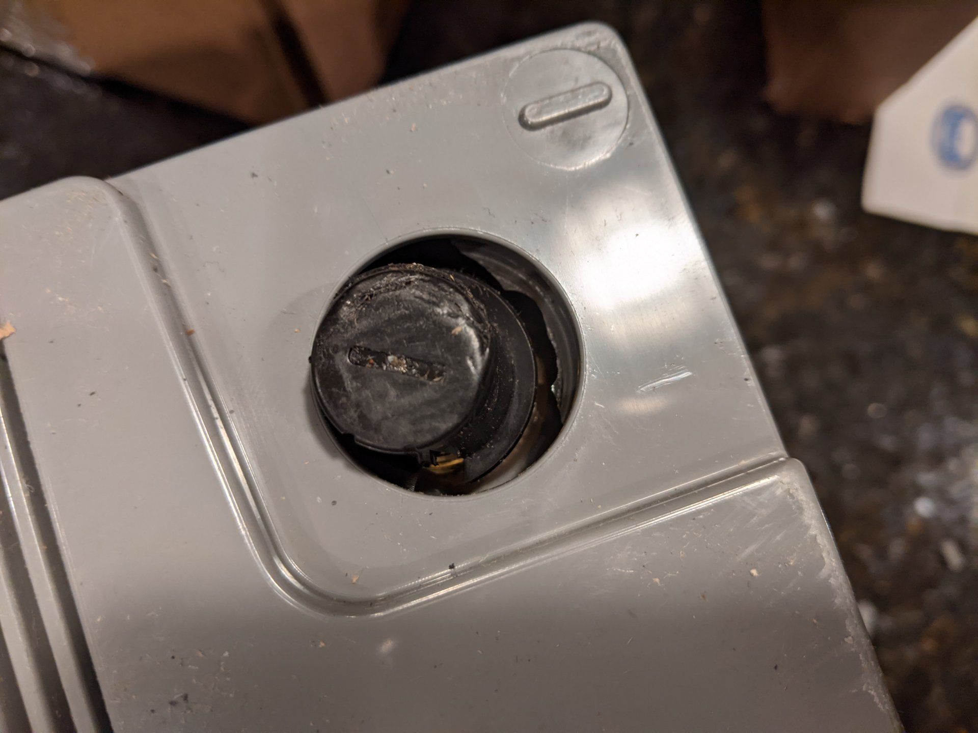

Man, the laughs keep coming. Batteries should look like this when they arrive, right? Thought it was a little odd that a 65lb battery was in the shipment box upside down.

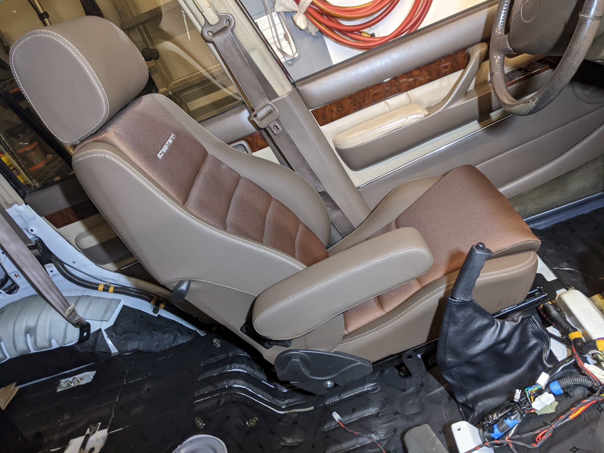

Scheel-Manns went in over the weekend. REALLY impressed with how much more room they give in the driving position. At 6'5" I'm maybe 75% of the way back on the slider.
Wasn't sure I'd like the color. Didn't realize the brown was such a good match until I got them installed.
Planted brackets fit flawlessly and with the addition of the Sheel-Mann bolt pattern when I ordered there was no drilling or modification required.

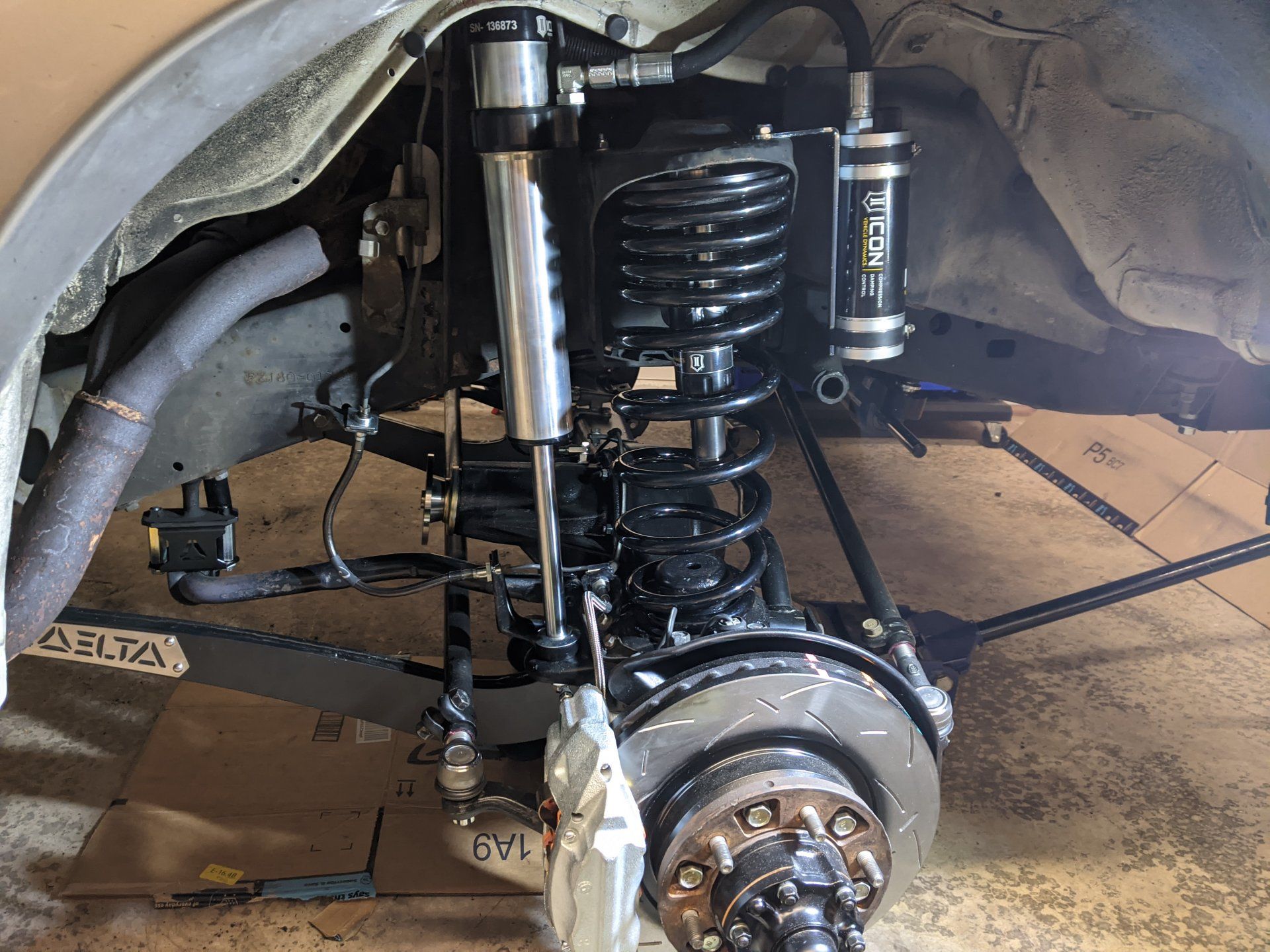

Front suspension finally on.
Threw the wheels back on and went to move the truck so I can work on the rear. No front drive shaft so I put it in low to lock the center diff ...no ABS light, no locked diff and one pretty hot viscous coupling by the time I got the truck back up the driveway.

What stage ICON set up is this? Just curious, didn't see where you mentioned it.
It's actually the DVS kit: Delta Vehicle Systems - FJ/FZJ80/LX450 DVS+ICON "Full Kit" - I went with the adjustable RR shocks. Decided on this kit since I had planned to use Delta components to correct the ride and caster after the lift and this package had everything I was looking for.
Dave from @Delta VS was a great help with configuration following a visit to the shop in Idaho. I added a Dobinson's steering stabilizer and some spacers to the rear (heavy rear bumper and a big spare). Couldn't be happier with the quality.
