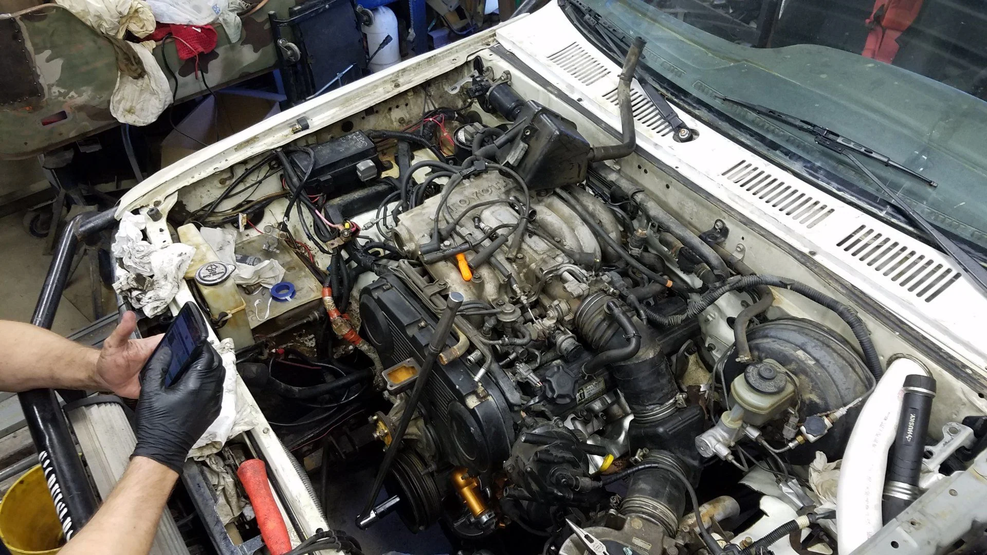

there are options out there, +/-$1K to rebuild mine, $800+ for a used motor, $1100-1500 for a rebuilt short block or $2k for a replacement truck. Figured I'd find out whats going on with current motor before I make any hard decisions but a rebuilt short block seems attractive.
seems like as you noted a rebuilt short block or long block assembly would be a good option...especially since no other engine related mods would need to happen. Don't know if there are some good options out there in the re-build world...I assume new yota stuff would be $$. Or you do the rebuild locally or have a machine shop do it.
My only suggestion is to do something about that crossover pipe while it's out. Either reroute it, make it smaller, remove that cat(?), and/or heat wrap it.
yes, been thinking abut that myself and have done a little investigating but not much. From what little reading I have done taking it down the passenger side conflicts with the drive line but I've not actually investigated myself.

If the exhaust manifolds happen to have the same bolt pattern (fat chance though), could you take a DS manifold and put it on the PS head to point the exhaust forward and wrap it around the front? It'll be a lot longer pipe, but a lot easier to work on - for other stuff too I imagine - and help eliminate heat-related issues of having it all tucked up into the firewall and back of the block so tight.
I have seen guys flange the passenger side and just extend that side down instead of across the back and then just blank off the rear cross-over connection on the DS. I would expect you could work it down the PS side and then either dual it all the way back or tie it back together aft of the t-case.
That cross-over is the main reason that those engines kill the #6 valve. It dumps into the manifold right on top of the #6 exhaust port. If you can figure out the exhaust routing, I would try to separate those when it goes back in.
And as far as voting, I would strip the intake and heads and pull the pan and remove the rod caps to see of the damage is visible. If you can find a reputable shop, and the crank and block are salvageable, my vote would be bore/hone/deck the block, turn the crank, new bearings, rings and pistons. Balance the rotating assembly while you're in there. Have the heads checked and decked. Put it back together with a quality gasket set, new water pump and timing set and then slam it back in and rock out.

Tore it completely down today and everything looks pretty good actually minus the new rod bearings installed a few months back so this is the exact path I'm taking. Gonna grind the crank, new pistons, rings etc. and add a new oil pump just to round things out and carry on about my business.

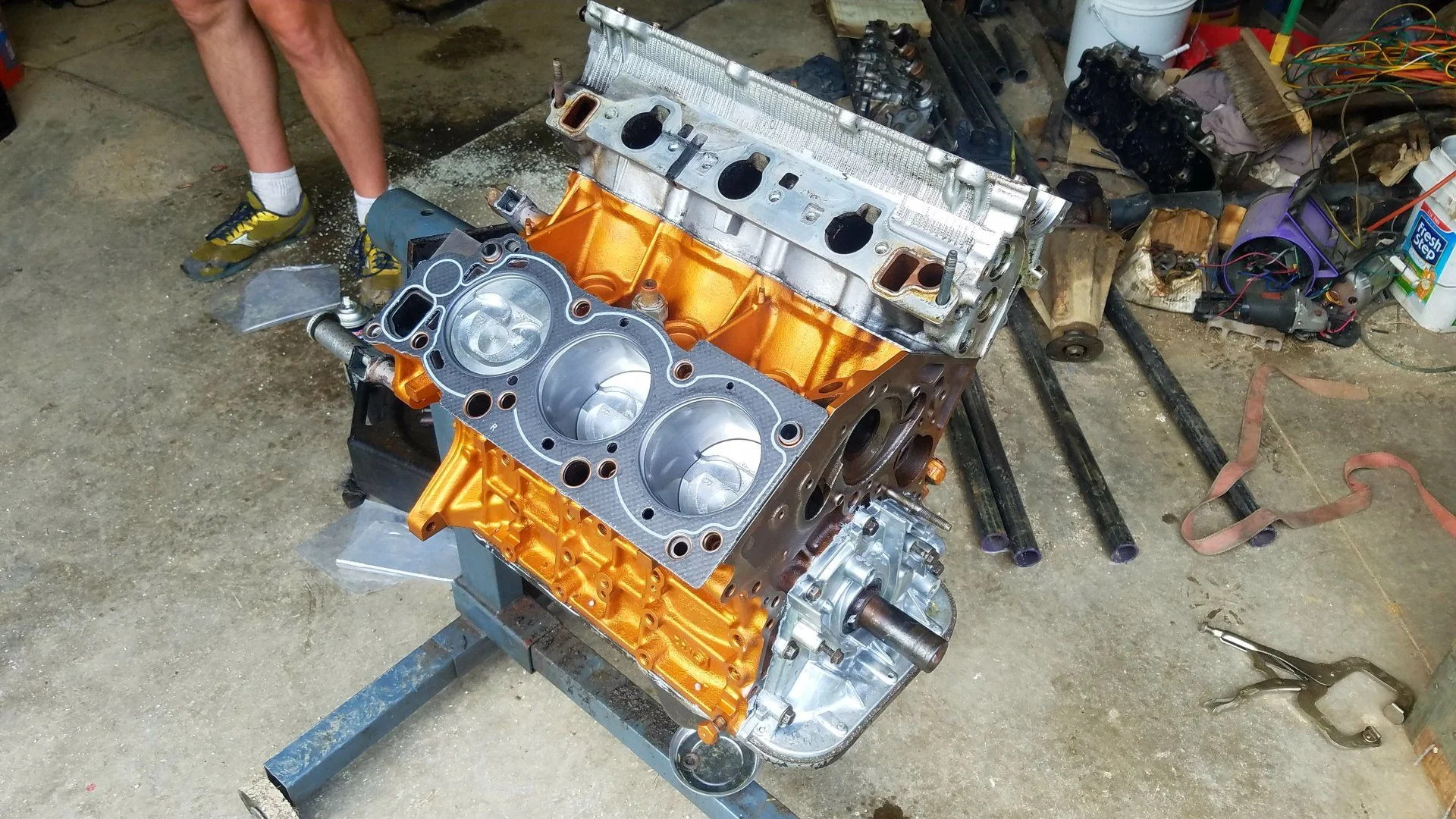

waiting on parts but they are trickling in. Unfortunately the new pistons look like they could still be up to another week away. To date with crank grinding and parts I'm right at $500 into it.
Tried to find the most obnoxious color i could. Think i pulled it off.
As much as I am going to catch hell for it, I like it!
For some reason I heard Barry White's voice "Yea Baby".
told you guys it would take awhile but im about 90% there. Heads are on, water pump etc all bolted on. Stopped only so i could pick up a new thermostat since Toyota put it in such a convenient location.
