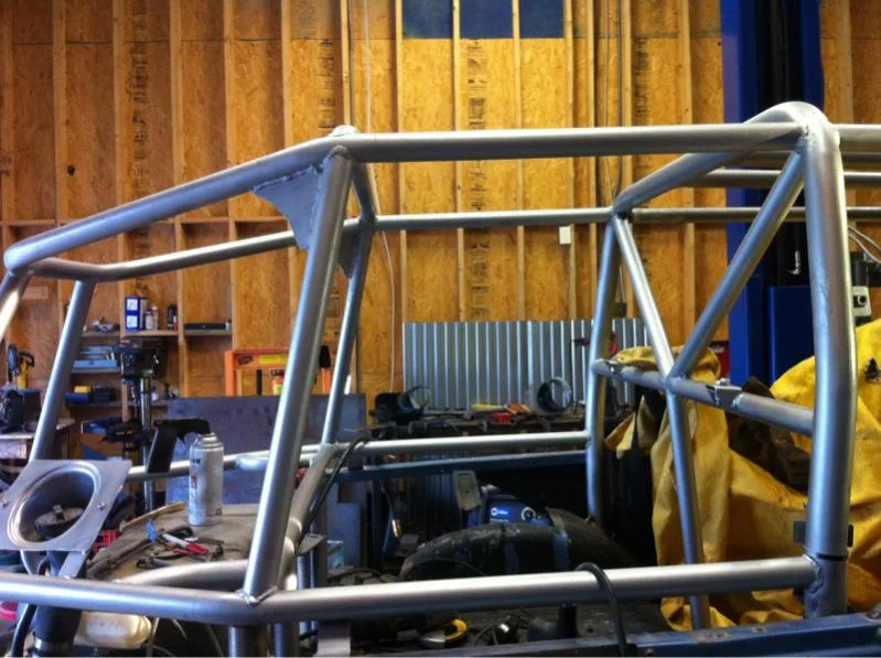

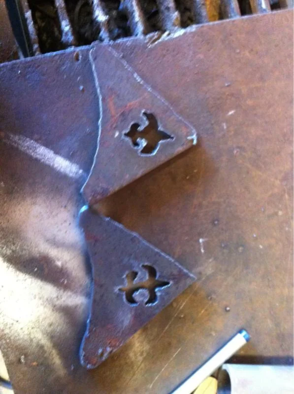

Tried to cut fleur de lis in my cage gussets.

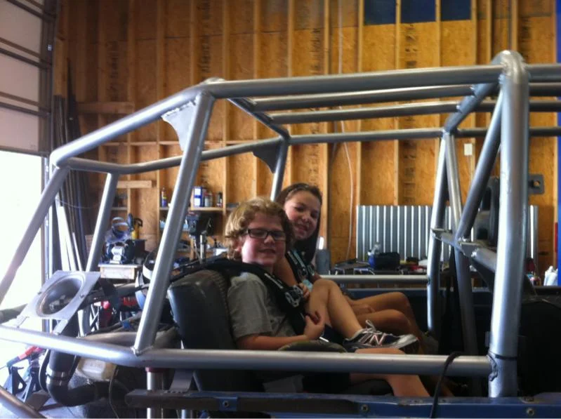

Turned out as fleur de p!s. So ixnayed them and just put some solid 1/4 inch thick suckers in behind the C hoop instead of side cross bars. Won't be able to get in back seat easily with cross bars. So these will do.
May add some more behind the B hoop.

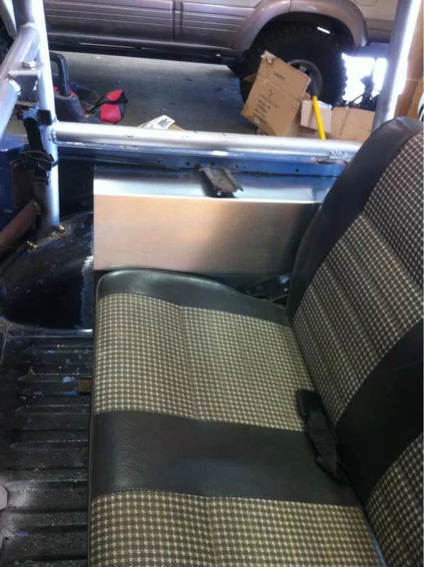

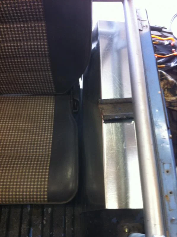

Decided to work on the rear inner fenders. Jrob was kind enough to let me have some scrap metal ge had lying around so i can mock up some fenders.

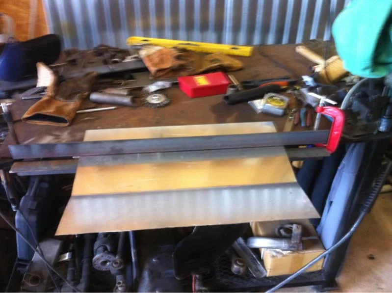

My sheet metal brake i made previously wasnt wide enough for the sheet i needed to bend so i built this one. Worked well.
I have them tacked in. Just a little more to do then the kids can ride and not get covered in road/ trail grime.
Thinking about tying each fender into a back piece of sheetmetal to shield rear passengers from gas tank. Havent figured that one out yet. I want to be able to remove rollcage and not have to deal with the body interfering with the cage.
