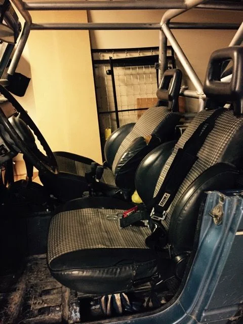

Bumping this old thread to show the passenger seat is in and ready for action ! LOL

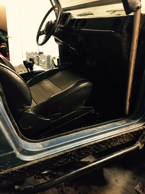

Sits a little higher in front due to the floor modification to fit the dana 300...but it's comfy.

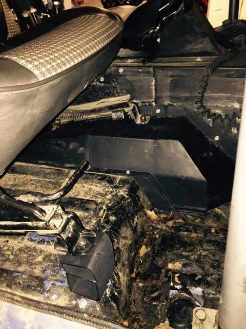

Simple bracket to raise the front and match the height of the left side.
