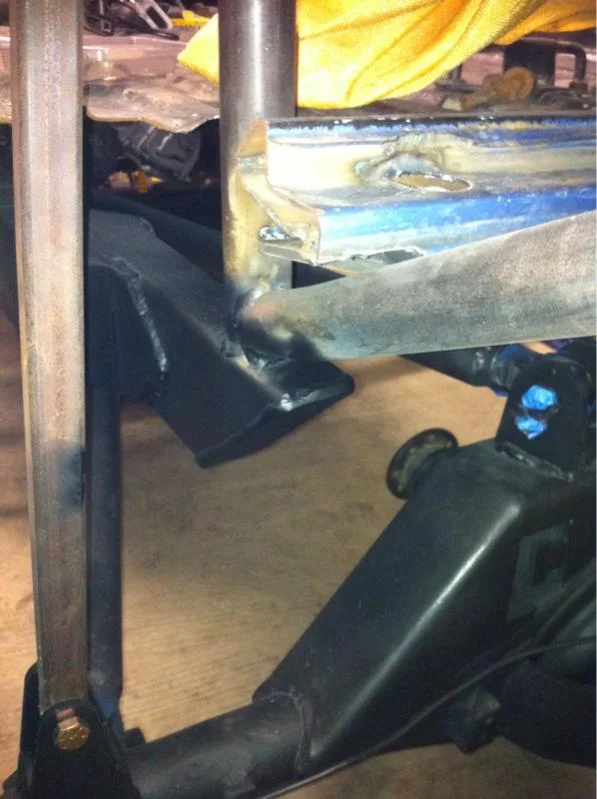

Finish welded whatever was needed to be welded.
Cut the rear frame and capped it i like the way it came out.
