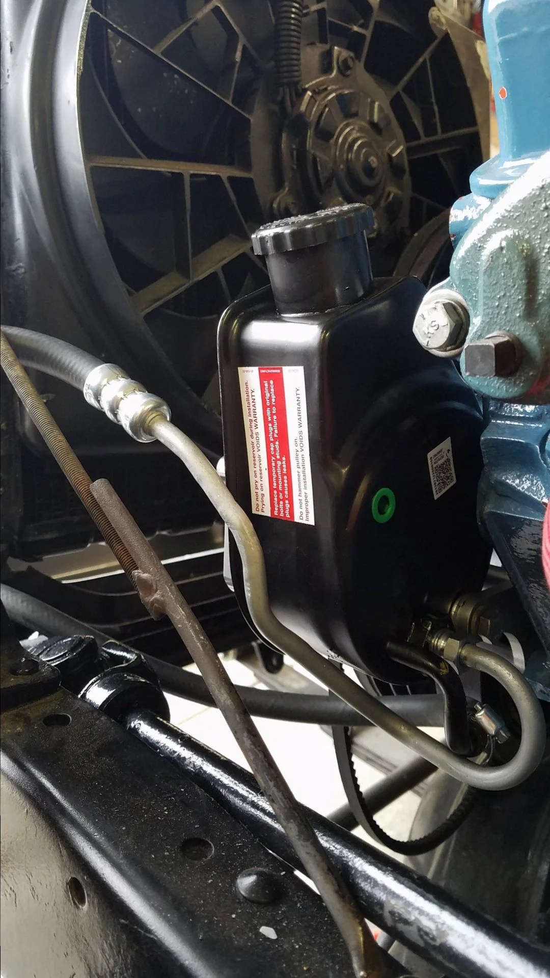

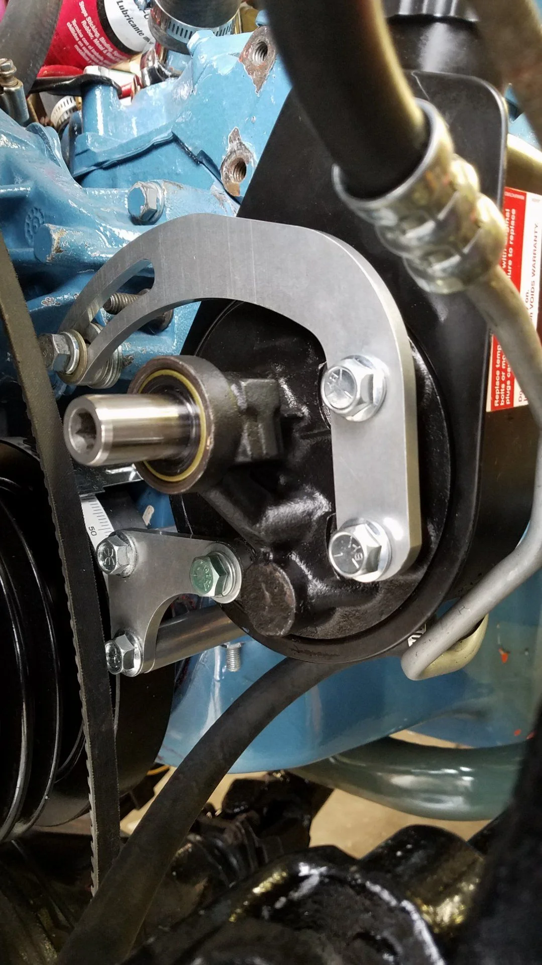

I put together this about 2 months ago. ETA: The pump is a Cardone 20-6800F.
