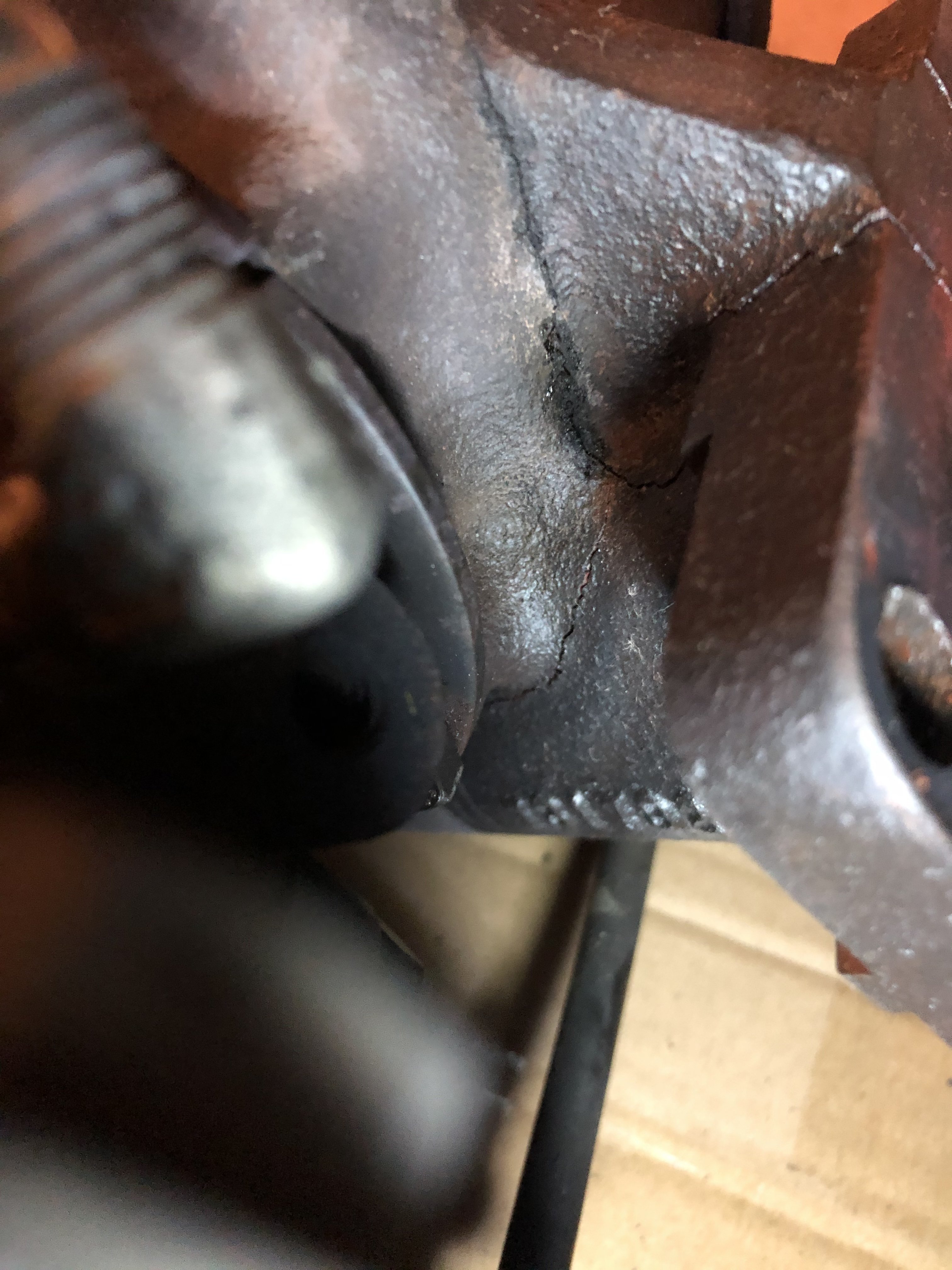

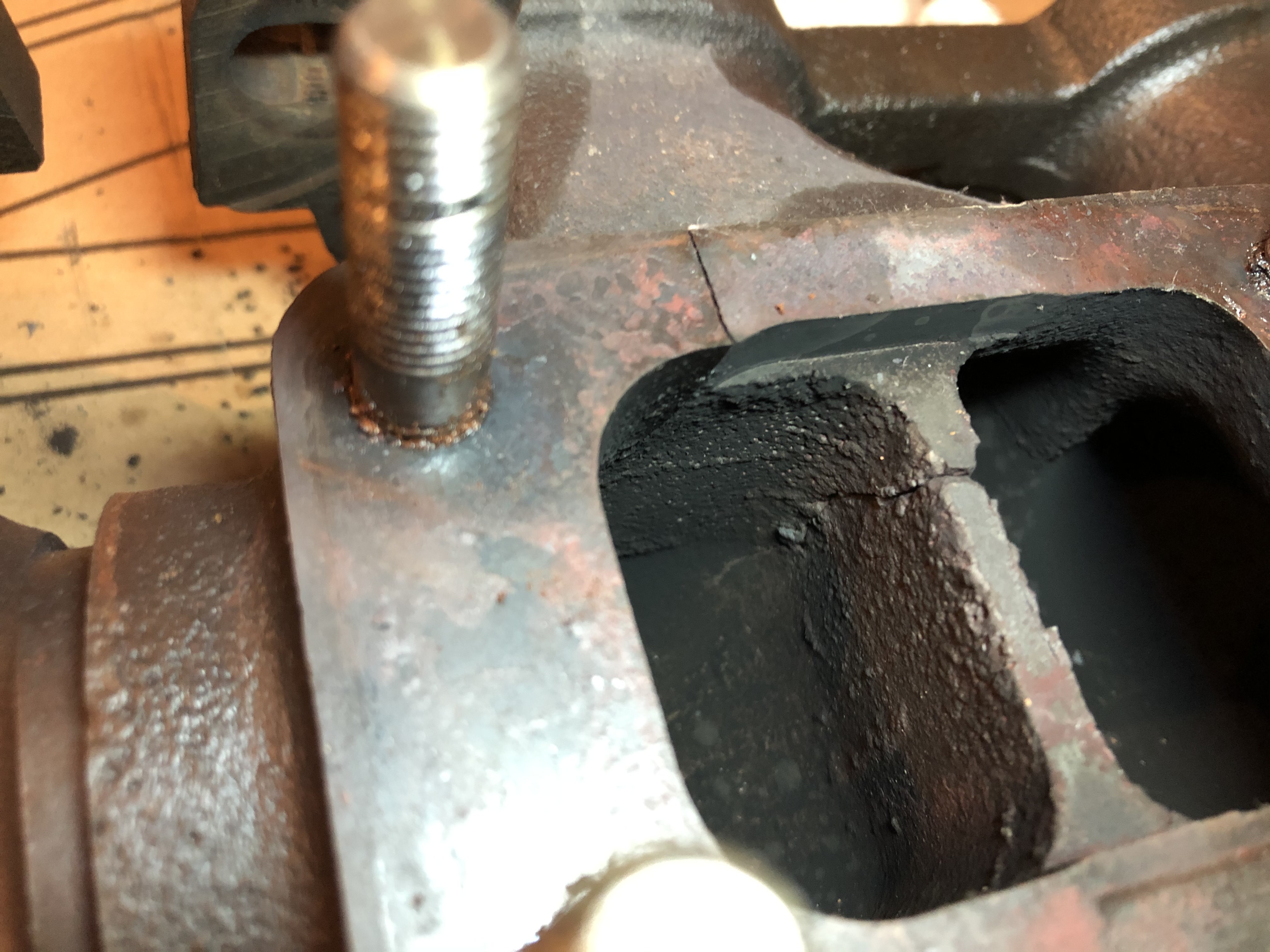

it started with the turbo seizing on Friday.
took it apart Sunday night and found cracks. The turbine housing is cracked.

The manifold is also cracked:

Now the turbo can spin a little, but it binds on every revolution (edit now spins freely but has play in the shaft). But it’s a moot point because the housing is toast, so I think that means new turbo time. This turbo uses Garrett internals but has a custom turbine housing that was specially made for this application, though I know different replacement turbos have been used because it’s a standard 4-bolt flange to the manifold. Hopefully I can figure out a replacement.

They are willing, but it's not cheap and will take some time to get. I found a welding instructor that seems confident he can drill the end of the crack, gouge it out, preheat and weld with high-nickel rod, then slowly cool while stress-relieving. I don't know if this will work though. If it doesn't work I can do the Turbo-Glide, though it is over $1000 to get stateside. I don’t know of any other manifold that will line the turbo up in the proper place for the rest of the Safari system to work.
I really want to be sure of the root cause, and make sure it doesn't happen again. I assume it's heat. The system did glow orange last summer because the cat got plugged while on a trip in the mountains, but I tried to be careful on the drive home and stopped on hill climbs to let it cool. I generally don’t abuse it. Would one time glowing orange be enough to damage it like this?
Glowing turbine housing is not uncommon, but less common at low boost. Probably a combination of heat, mileage and vibration. How long has the turbo been installed?
Turbo was installed approx. Jan. 2003 at 75,000 miles, now at 226,000. So 18 years and 151,000 miles.
Yep, it's lived a good long life. I'd be looking for a modern update like a gt35rs. I'd take up that welder on his offer for the manifold first before importing a new one. He may have to adapt your downpipe to the exhaust dump on your new turbine housing as well, as I imagine the shape and configuration has probably changed in the last 20 years--especially if the safari is a one-off specialty turbo.
