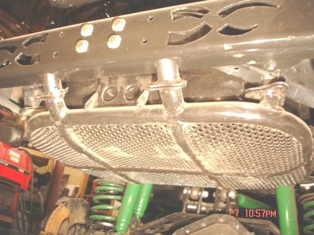

Here are some pics of the 20 gallon tank I installed last summer in my 73 fj40. Mine went in without issue. I only had to dent in the tank slightly for shock clearance. I also built a cage for some protection. This is one of the best upgrades I have done to the 40.
