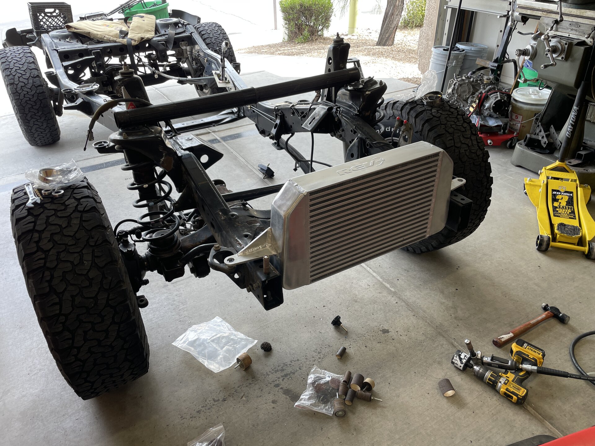

Once I got that out and rolled the chassis back for some room, I started laying out and double checking the fit up of the intercooler and piping. I did not get any pics of the process of cutting the holes in the forward-most crossmember, but you will get the idea. The intercooler, or ATACC if you are steeped in the power equipment world, mounts on top of the front body mounts with a sleeved iso-mount.

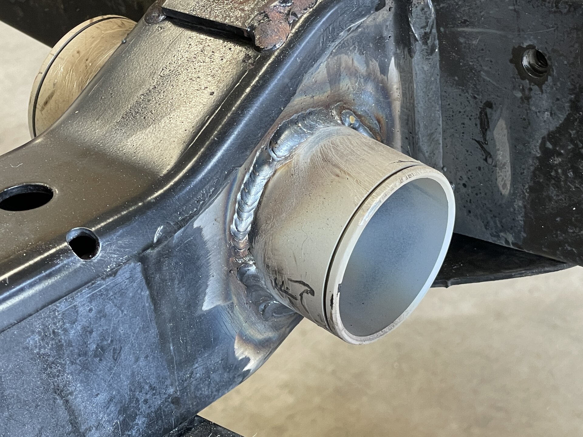

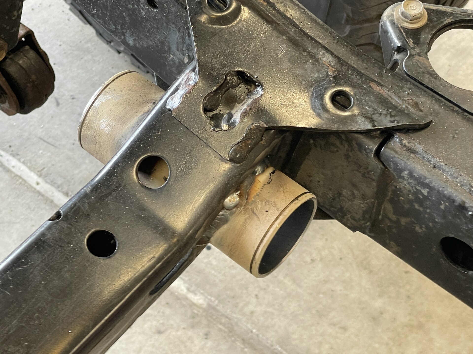

Before welding the tubes in place, I gave them a coat of weld-through primer. This stuff is expensive, but it is great when it comes to protecting bare metal that you may have to weld to. I will be giving the frame a respray after all the mods are done, so this just gives me extra insurance it'll all stick.
Here are the tubes all fitted and the frame hand finished to have a tight fit up with minimal gaps.
RH side.
LH side.

After I was convinced that the fit up was good and there would be no issues, I got out the metal caulk and prepped myself. For reference, the frame rails and crossmembers are closest to being 10ga sheet. I used the recommended setting backed down just a bit because I am really freaking rusty on laying down angry pixie metal glue. A smarter person would have taken the time to find some scrap and practice a bit. That was not me. I laid into to by starting with the most visible side first, and well....the rusty hand didn't disappoint. My first few welds were boogery and not the finest displays of skill, but by the time I got to the backside of the work, my hand had steadied and the settings were fine tuned. Funny thing is the backside was much harder to access and yet I had better welds there.
My trusty Millermatic 251. These old transformer welders flat get it done. I love this old thing despite it needing a little TLC.
Front right side was the first one, and my hand was shaky and the heat was set a bit too low.
Getting better, but not quite pretty.
More heat, more wire, and a steadier hand for the rear right.
Same here on the rear left.

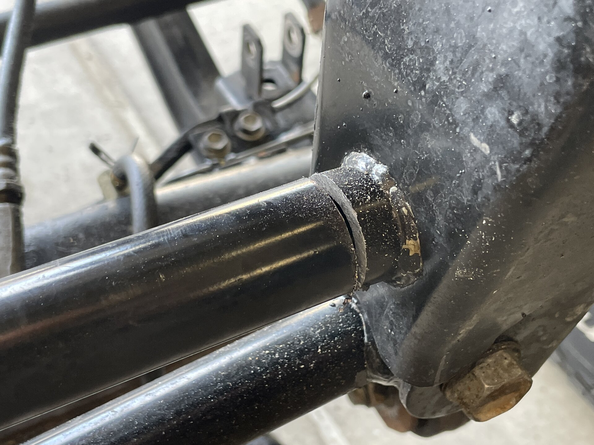

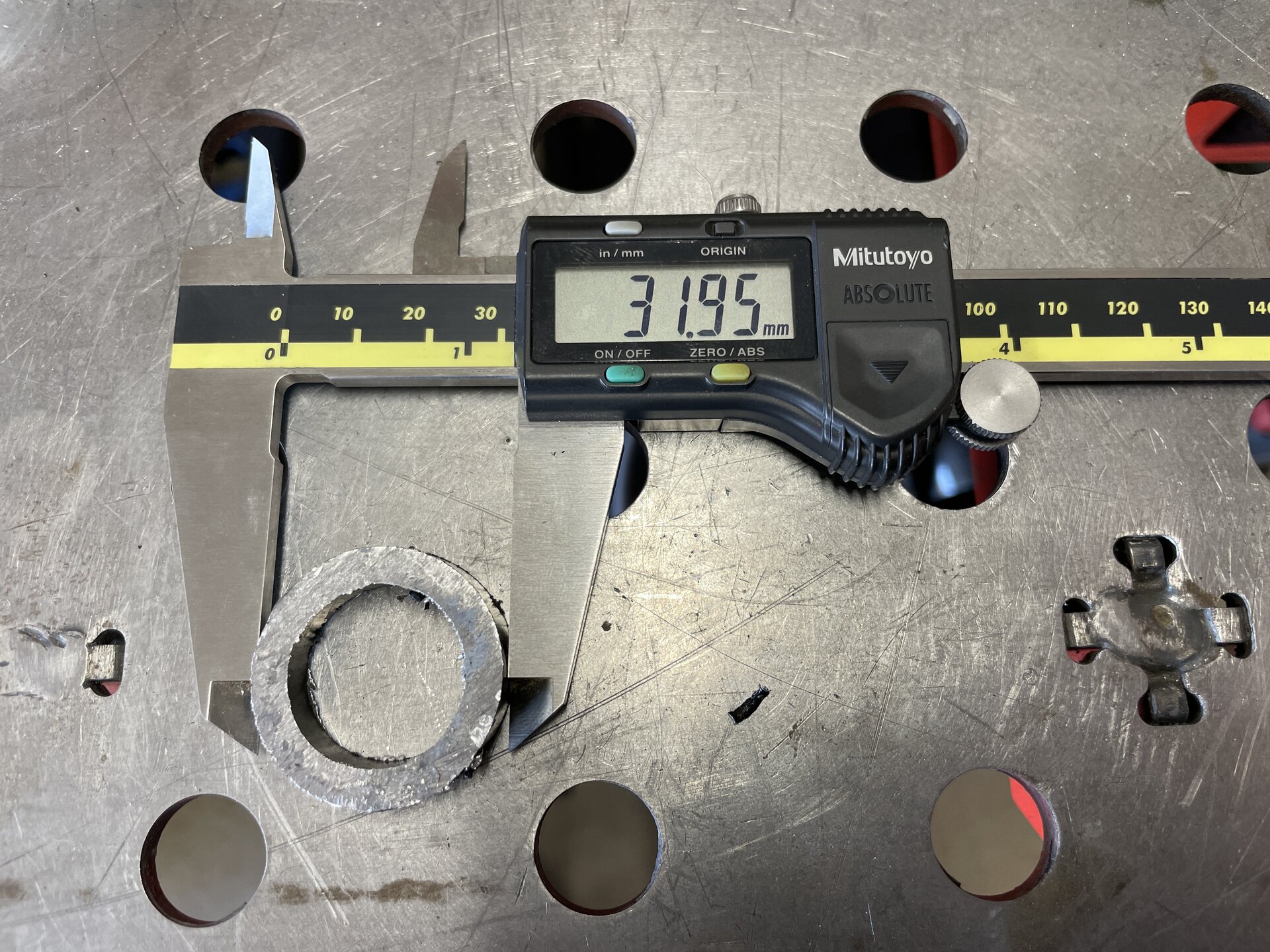

Next op was to prep and chamfer the PBCM for welding. I had to remove about a 10mm section on the tube to clear for the weld in bracket and gusset.

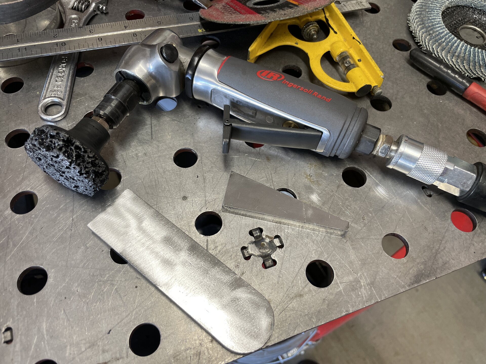

Drop plate and gusset prepped and ready to be tacked in.

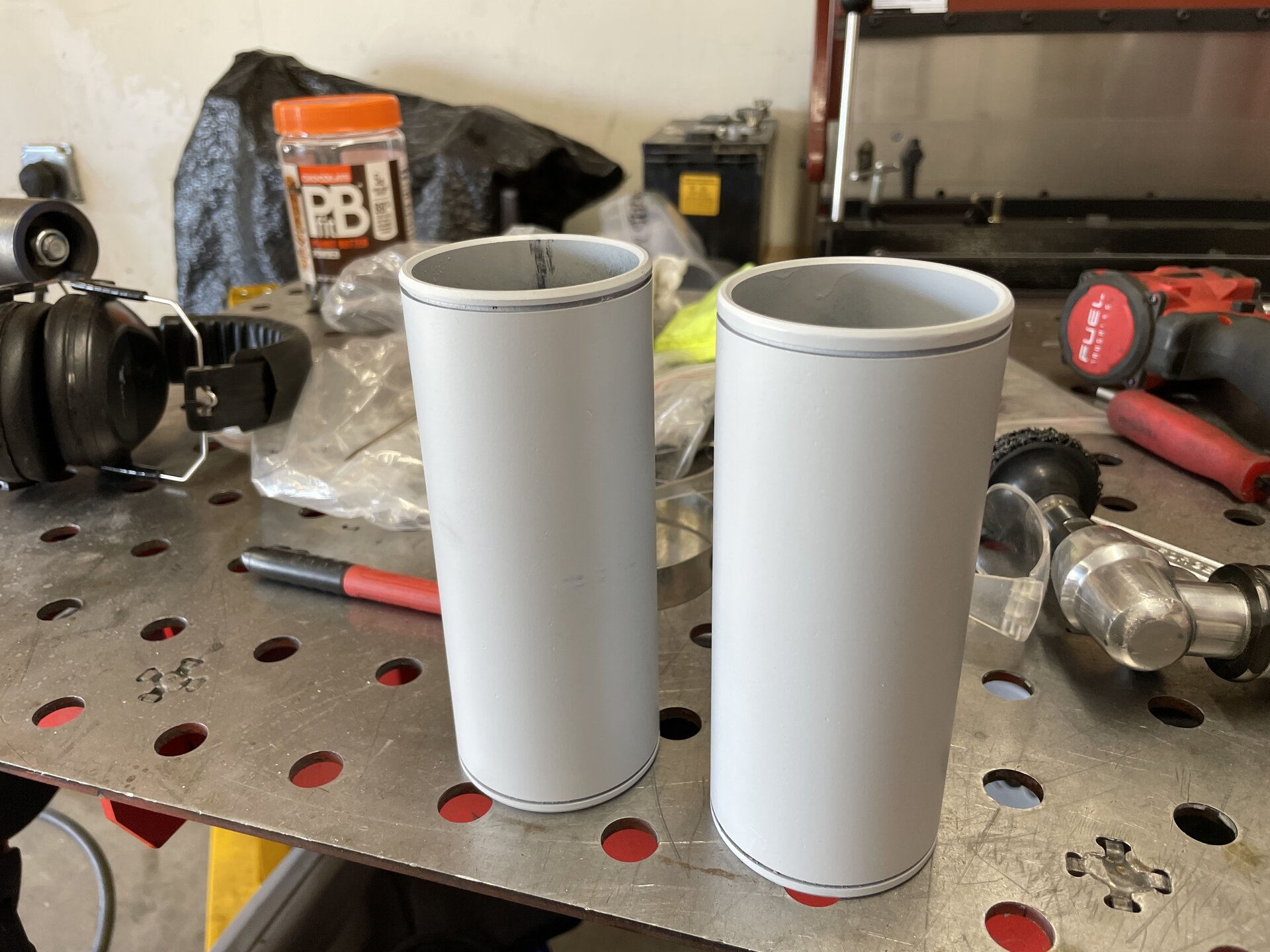

As a general sharing of knowledge, the PBCM is about 1.25" on OD with a wall thickness of about .180". If you wanted to do roll cage couplers here, Trail Gear makes 1.25"x .160" wall couplers.
SAE
Metric
I hit the turbo button at this point and failed to take incremental pics along the way. In short, I got it all tacked, double checked, and finish welded. Once done there, I took some time to smooth and blend the welds before spraying a layer of primer.
light coat of primer to ward off flash rust.
Drop plate and gusset welded in place. Still a bit rusty on the welder.

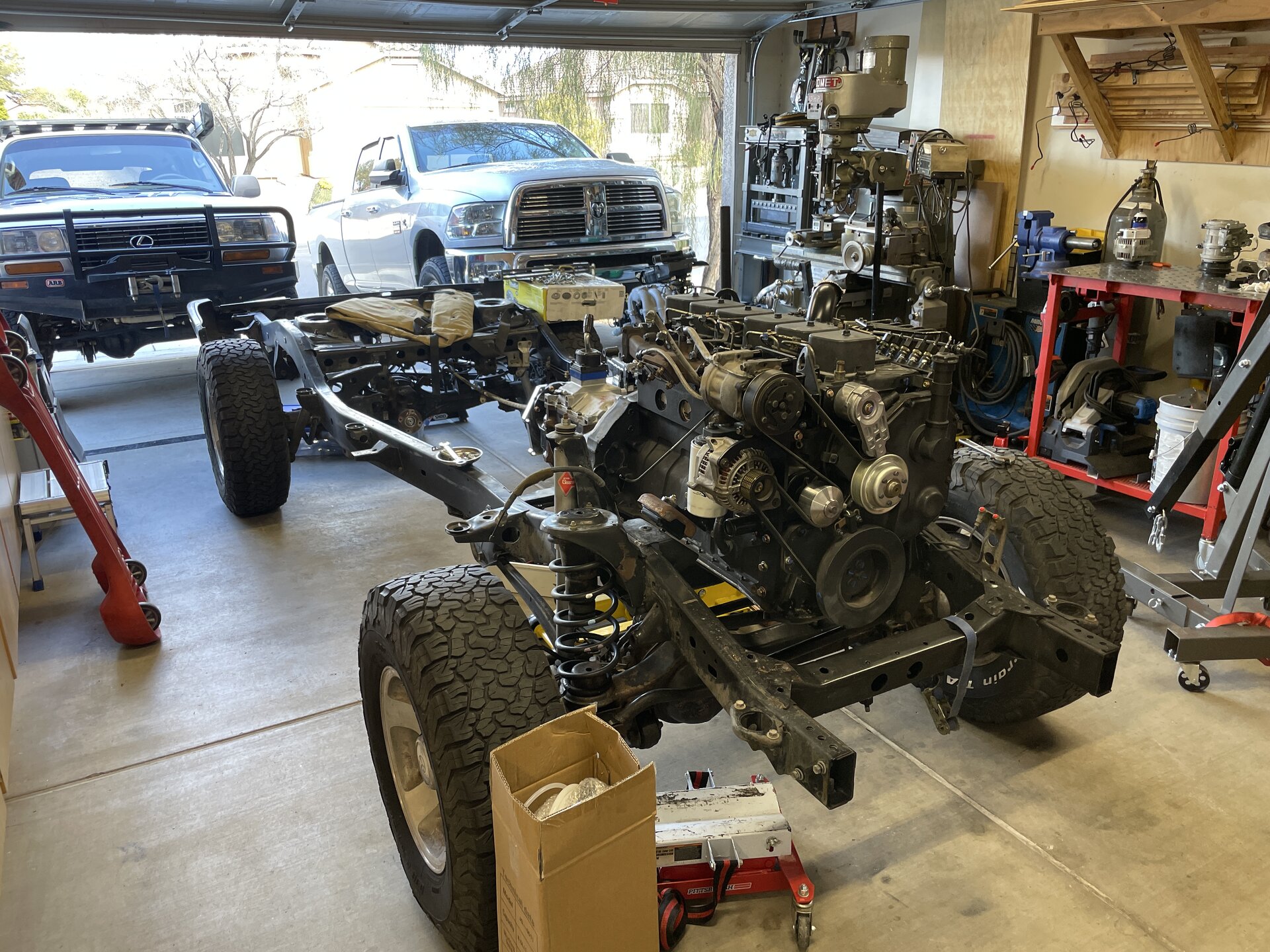

The day concluded with a refit of the powertrain to the chassis. This was necessary because I needed to fit the freshly rebuilt/re-geared transfer case in order to check for clearances, and because I am working my small garage and have to Tetris my way through these jobs. I do have to make some XMSN mount modifications to give adequate clearances to account for shakes and vibrations. Stay tuned, that's all for now, but much more coming your way.

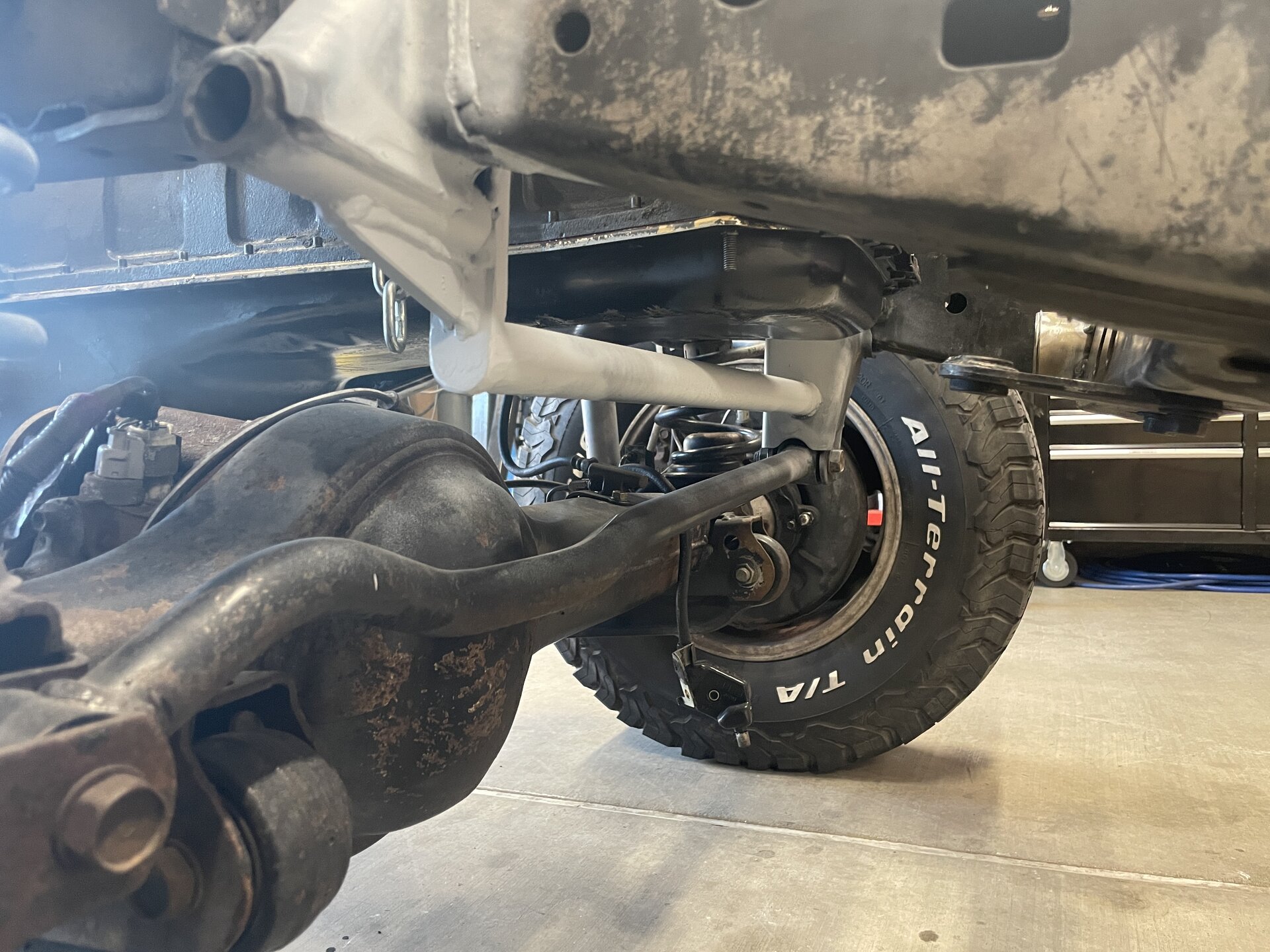

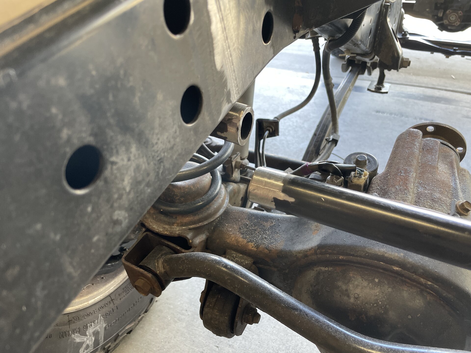

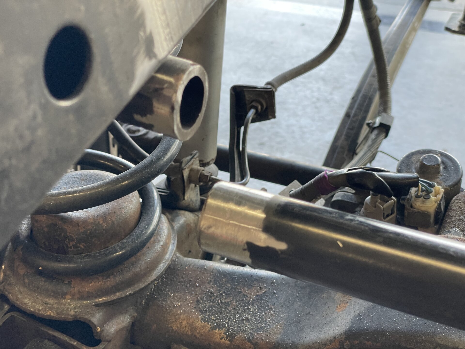

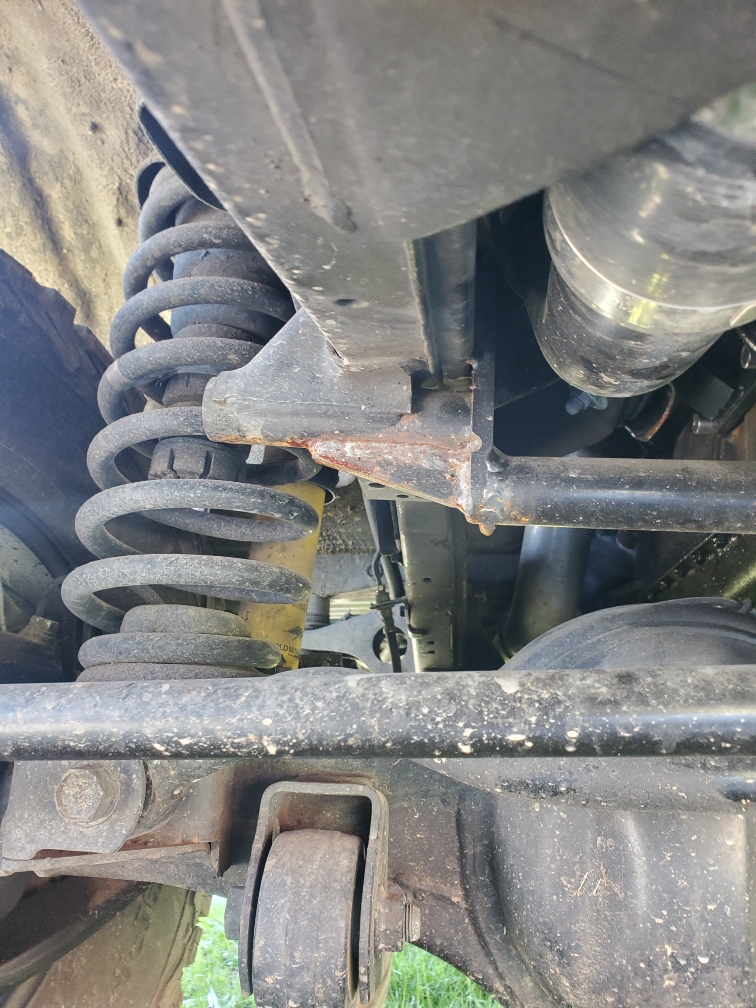

@-Spike- asked me a good question today and it made me double check a few things. The question was related to the PBCM mod, or specifically if I had checked to ensure there were no interferences in suspension when bottoming. The short answer is yes, if left stock. I happened to have a set of Slee 2" front bump stop spacers that I put away a long time ago. After installing the extensions, I lowered the rig down on to them and double checks all the key points. Thankfully, no issues with clearance.
In looking into the question deeper, I got out some of the pics I was sent for examples of the mod to the PBCM. What I found is that in my drive to make it level and give more room in the even I need to remove the pan, I ended up dropping mine a bit further than others have. I am not too worried about it, but I will be watching this and checking for cracks quite often in the shakedown period. As an additional bit of insurance, I may further gusset the RH side of the bar mount.
Reference pic #1
Reference pic #2
I think I will further gusset this to ensure it is fully supported.

There are some kits on the (Australian) market to reinforce both ends of the PBCM and the steering box mount area; you could take a look at some of those and maybe get some ideas about what fails and what to do about it, if it's a concern for you. Especially with that extra 291.311 pounds on there... :hillbilly:
