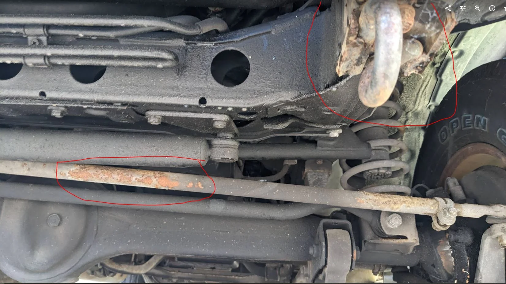

Hi All, first time poster - thanks for all the wisdom out there!
Looking at purchasing a 105 and it has some rust (photos attached) - the main concern is the rust around the left front (passenger) tie-down point (excuse the poor photo angle.) - I've circled in red.
Is this a common rust spot? any thoughts what caused it, would this be a concern? I'll try get a better photo later in the week but any initial guidance would be appreciated.
Vehicle is East Coast Australia
Thanks in advanced.
I would have zero concern about that.
Thanks for the initial feedback - yeah the photo isn't great - I should be able to get a couple of better shots this weekend. Any other "key areas" to look at under the chassis for rust or areas of concern? Thanks
ends of crossmember above rear axle, close to where it meets the main frame
