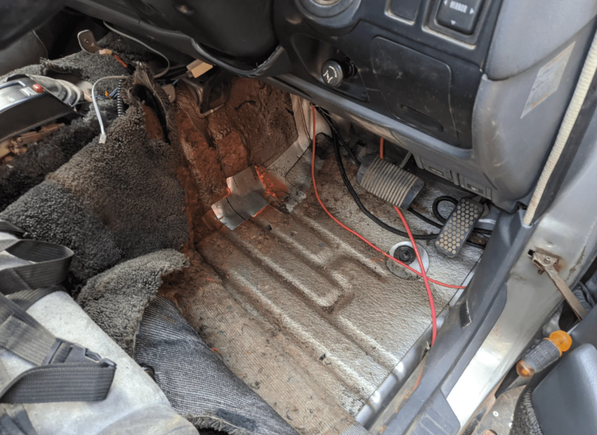

So during isolation, decided to give a crack at fixing the rust problem i have in the 80. Decided to use a steel epoxy putty instead of welding as it is a couple of spots all over the body. Grinding, scraping and sanding the rust spots first, applying a rust converter and then putting the putty over the top. The putty has turned out really nicely and if anyone's wondering, i filmed myself doing it in case anyone else wants to do it the same way.

One of those things I hate to admit doing... But thisll have to do until I strip the interior and weld it. Stainless and rtv.
