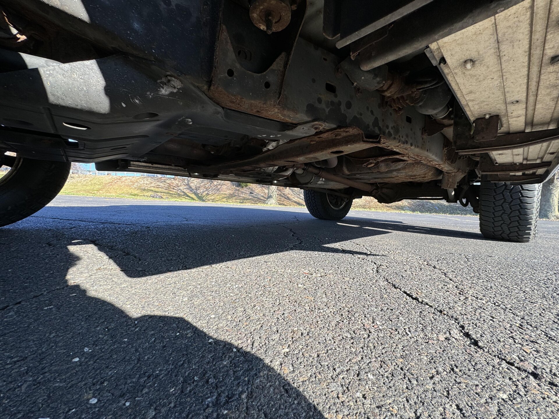

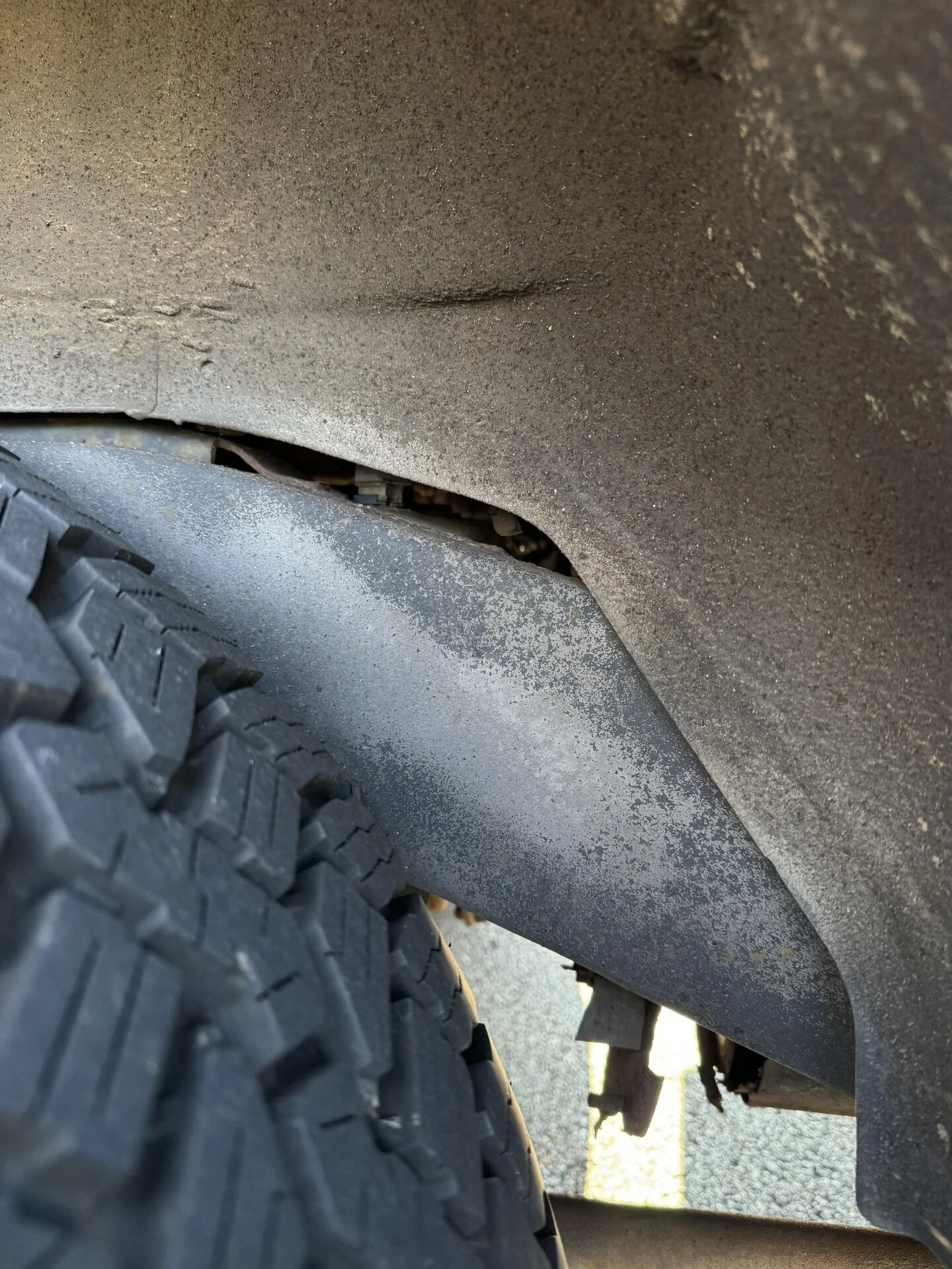

I found a low mileage 2004 lx 470 with the following pictures foe the undercarriage.
Need someone experienced opinion if you see anything. It looks like rust is surface and on the cover but I'm no expert.
Appreciate anyone's help
Things look like the early stages of crunchy. Depends if you care or not. It will not fail in any areas. Depends on price and what you want to do with it. If you want to do basic PM and enjoy it and price is right, makes sense. If you are planning to dump money at it and call it your forever baby, maybe, but I would not. Just hate working on crunchy bolts and such. Look below the rust belt if you are wanting “a forever baby”.

Honestly not enough info to give any advice.
If getting it for a few grand, sure why not, fix it and drive it. But as the price goes up the value goes down, only because you're going to have to potentially put several thousand into it regardless.
The frame looks decent and can clean up easily. If the body is good even better. The rusty parts, bits, nuts, and bolts will get swapped out over time thru repairs and maintenance.
Some of those areas don't look great, some areas look fine. I'd pass unless it's less than maybe $5-6K and you aren't going to built or overland it. To and from Costco it should be ok IMO.
The bad part of 100's in my experience is always above the spare tire/behind the rear bumper. Can also be sneaky inside the rear upper hatch. Both areas almost impossible to get pictures of from the average seller.
If it looks this bad on the easily visible parts, it is definitely worse in the hidden ones. Doesn't look unsafe to me (yet) but I wouldn't put it through many more winters.
Have a decent deal on it, im located in a non salt non snow state aka your neighbor here in NC. The car is located 9 hours away, and made an appointment with a mechanic for a pre purchase inspection. Hopefully, they can dig into it deeper and let me know the ins and out before making a final decision.
I bought an 07 a few years ago that did not look that bad , but once home and looking UP behind all of those areas i sold it! rear shocks almost rusted away, rear bumper had been painted in place due to all the bolts rusted solid..i would pass on it..

I actually took the ride yesterday and had a mechanic look at it,
They said the excat same thing, it looks good on the surface, but digging deeper he would 100% pass on it. Back to the hunt
Keep looking they are out there, i opted for the grey 06 in my avatar , it had 186k however all Lexus services AND flushes and no rust ,it was a southern Virginia car since new and looks great underneath! Now with this mileage it does need a few things as in my post but i bought it at the right price to address these issues, miles do not hurt the ride a solid feel of these rigs..and now a great rust free driver For a looong time :)
