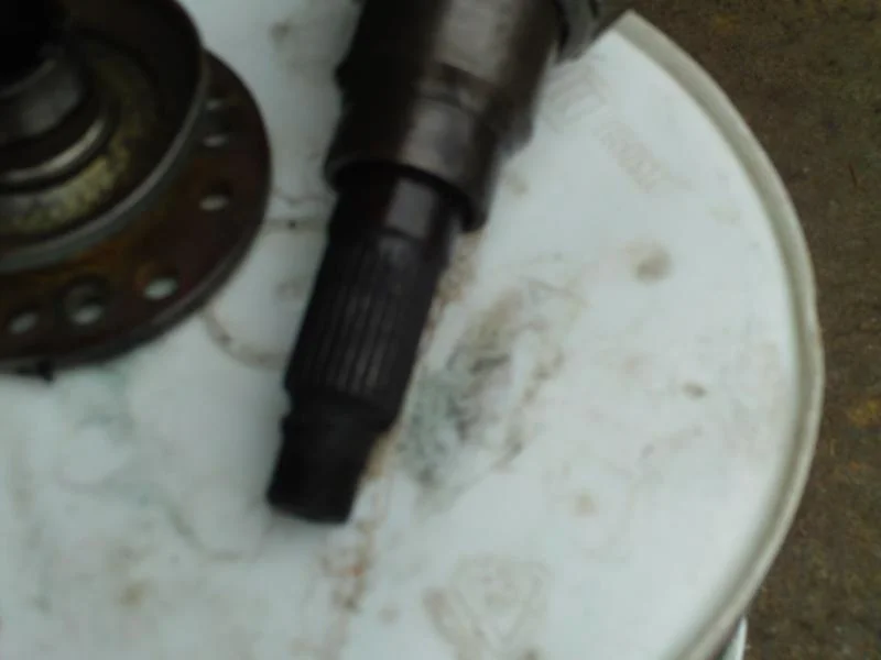

Well, I was finally able to dissasemble my 3rd and the problem is the spline on the pinion and the yoke stripped out. that's why it was so difficult to figure out on the trail.
Now it's just new parts and form some sort of rescue down from Cadillac to the Springs.

sorry for the clarity on the pics...

Why did it strip out ?????? are you sure that is a 529 R&P ??? might also need new bolts for lockouts ? You might want to go back to the springs when the work crew go in ??? July sometime ???? Marlin crawler roundup in august ?? any Ideas Guys ???

Apparently, there was a little side movement in the pinion and all the wriggling around weakened the assembly. Just before dissambly my buddy was moving it around and noticed that. And that is probably why we didn't see the failure immediatly on the trail when we took the darn thing out and had to reinstall it to confirm. Sorry the pictures suck but it is obvious now. I was even sceptable on the breakage, but being a 1 :banana: :wrench: I concede to the pros being you, Glen, Clif and Dale.
They are 5.29's that is certain. i replaced them a few years ago due to a faulty crush sleeve. It is now a solid sleeve so that is not the issue.
