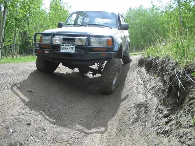

Some small testing was done this weekend up at Crystal Mountain, the Horsetooth 4wheelers (we) were building a gate to keep people out at certain times of the year. So this was a good time to test a few poser flex spots.
1st Pic: rear droop, everything was normal, no swaybars, hitch pin IN,...don't think we have a problem here :D (nevermind the superstar driver and his batgoggles)

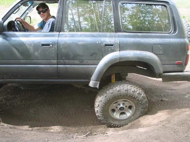

2nd Pic: hitch pin pulled, shocks almost maxed in the pic, very level body, axle slightly rotated.

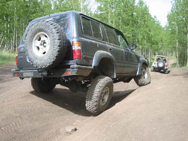

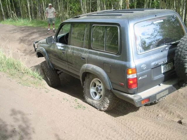

Next 3 pics in true poser fashion...Hitch pin pulled, springs slightly loose at droop, the body is VERY level in these pics, the two tire were fully stuffed, the others pretty well drooped...I didn't lift any tires except for this spot on the way up with my hitch Pin IN, I lifted the rear just barely (fwiw my friends TJ lifted his rear tire in that same spot :D )
The main things I gathered from the small short trip was definitely helpful.
We drove a canyon road on the way up, fairly fast (over posted speeds NOT RECOMMENDED DON"T SPEED) and the rig performed much better than I thought it would. I don't think my swaybars are ever going back on. We didn't air back up on the way back and the sway was more noticeable (mostly the tires)
The rig performed great, stayed extremely level all through the day. the hitch pin and swaybars DO make a difference. At that pic of me on the rocks, there was another 80 series/thing/FJ40body on an 80 series, with the 2" OME lift, and he lifted tires in the spots I didn't. Did that stop him from the obstacle...HECK NO! Just an observation. The ride was very stable/level and smooth...definitely impressed. I think I'm going to beef up the opposite brackets just to be sure.

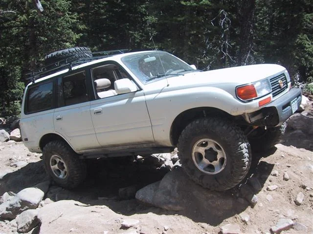

thanks man! here's a "sorta" compare shot....friend TJ, (with toyota badge on the grill! ;) ) I know I'm going a different direction and our wheelbases are GREATLY different, positions aren't quite the same, but you can see...defintely comparable...I think I'm actually articulating front/rear more than him in this pic, more twisted anyways. but the front still needs a bit more to compare...VERY close tho.
FJBen said:
The rig performed great, stayed extremely level all through the day. the hitch pin and swaybars DO make a difference. At that pic of me on the rocks, there was another 80 series/thing/FJ40body on an 80 series, with the 2" OME lift, and he lifted tires in the spots I didn't. Did that stop him from the obstacle...HECK NO! Just an observation. The ride was very stable/level and smooth...definitely impressed. I think I'm going to beef up the opposite brackets just to be sure...
That's the first thing that I noticed, even with the sway bars connected with my setup. The front and rear flex is much more equal or balanced making the cab ride more level, reducing the side to side motion on the trail.
