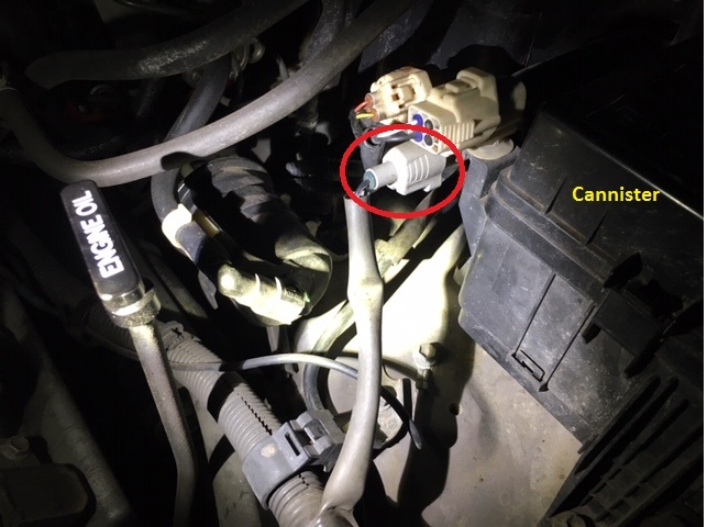

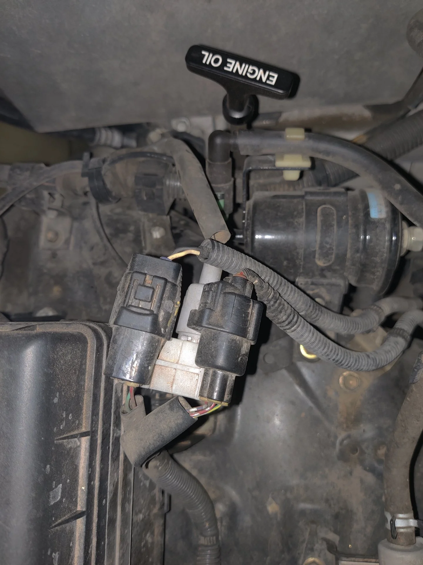

Here’s a plug that’s disconnected near the fuel filter and oil dipstick. I have a feeling it has been like this but I can’t confirm
I don’t supposed anyone is able to snap a pic of where that you plug terminates? I’m unsure if that is one of the many unused plugs since mine is a ‘00 LC, but the contacts are unusually clean like it’s spend its life plugged in. I can’t find any other connector near it that would fit it.

Yes, I'll get you a pic, but it goes where the cluster of the connectors are at your Evap Canister
@Grego @flintknapper yall are awesome thanks so much! I guess that plug was hidden by the two on top when I looked. I’m not sure if that would be the cause of my issue but I figured it would be worth a shot.

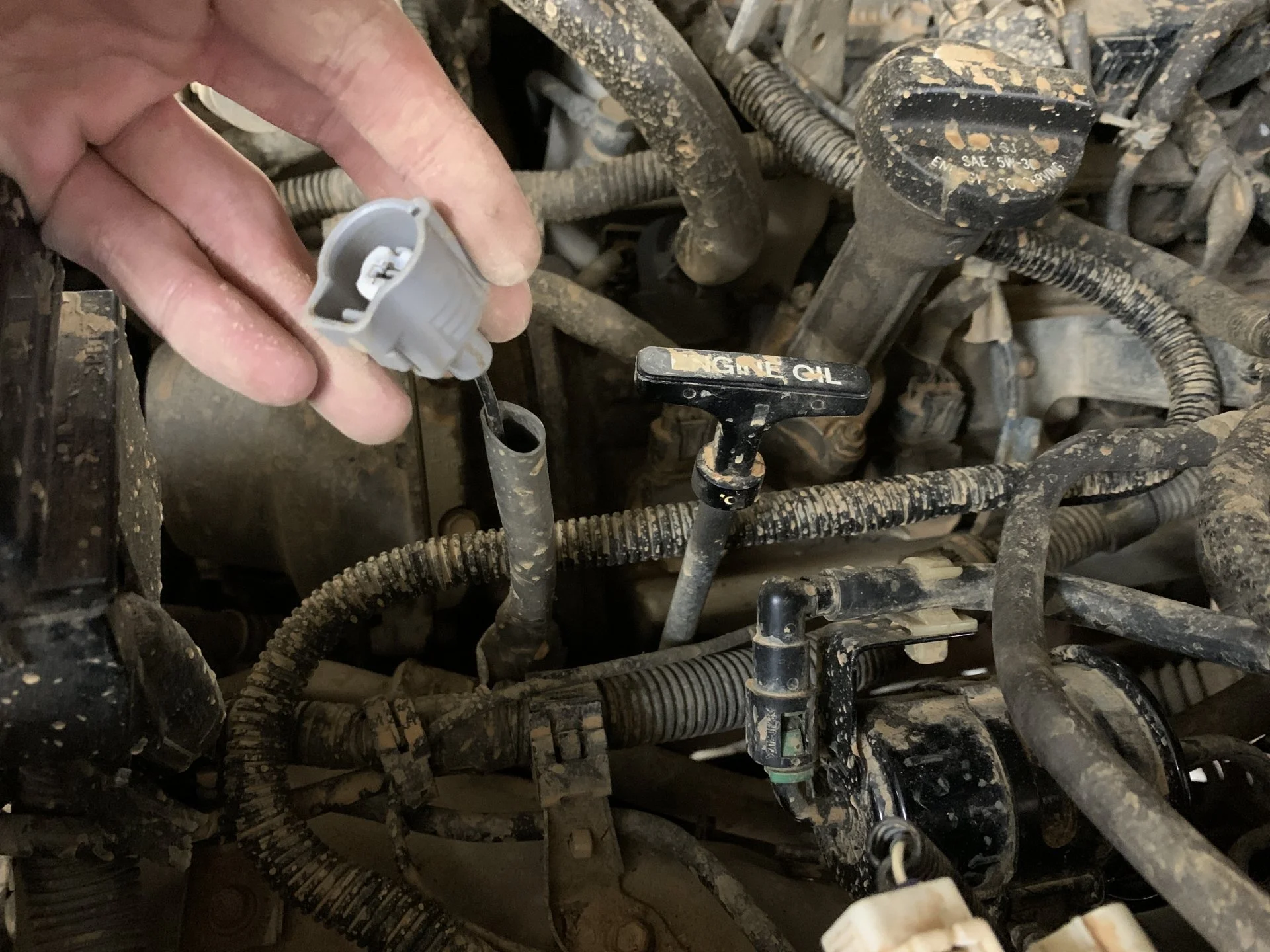

Did you ever get around to trying this? I have it on my list but other things have been taking priority.
I confirmed in another thread that it will indeed disable your truck (at least it did for my 2000 LC). Give it a shot, only takes a couple seconds!
I thought it was pretty crazy too, I have no idea why that would interfere with your ability to start the engine but it most certainly does for me after experimenting with it several times. To clarify it will not even let the engine crank. It seems to completely disable the starter all together. Turn the key and it’s pure silence.
