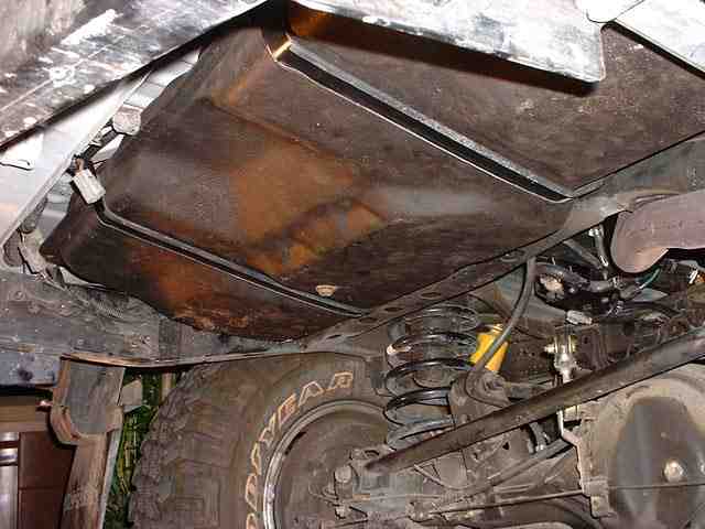

I cut back the factory exhaust and added a turn down tip all out of the way to avoid off road damage
img_5516-jpg.1284270
That's similar to mine now but I cross the tank to about the fastener closest to end of the frame in your pic Phil. Actually mimiced your install for mine.
Obviously no troubles? Tire doesn't get hot spots?
T
If your concern is heat I can assure you if your looks like mine you will have no issue with heat. It was 92° yesterday here, do you ever see 92° during the year.
