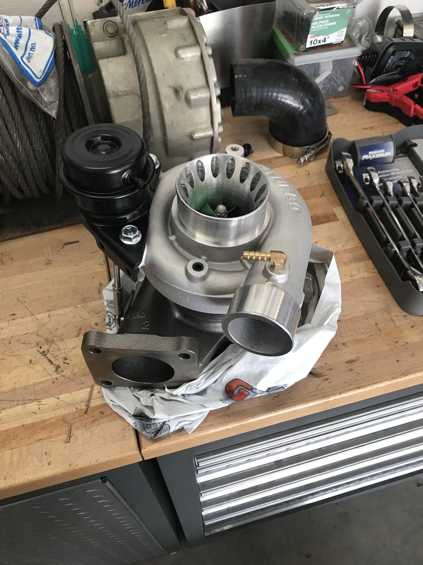

Replacement turbo has arrived! Looking like install will be in about 2 weeks.
YES. It looks pretty. I hope it performs to suit. I was just thinking about how much I like the Gturbo/PDI combo on my rig and remembered yours. I can't wait to check in and hear about what you think when it's installed.
