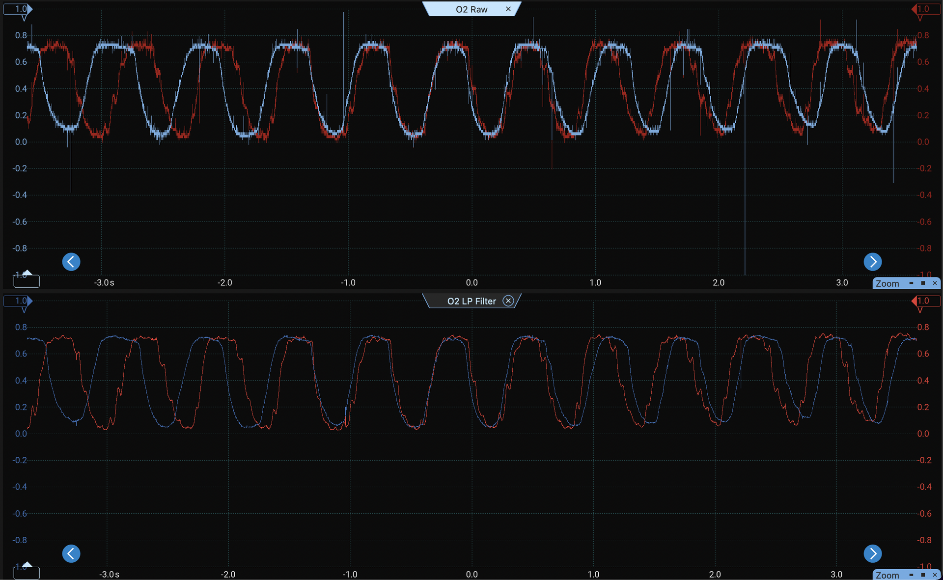

Well, you may have just replaced those O2 sensors but something may not be right still. The OBD keeps pointing you back to O2 issues, it has literally hit like 4 codes that reference back to O2 sensor or o2 circuit issues, so I wouldn't just disregard that. I'd spend more time checking that circuit to verify that the O2 sinewaves are making it to the ECU, you would need an oscilloscope to perform this test. The test and example waveforms can be found here: Picoscope Automotive Test Library | Lambda O2 Sensor Waveform Test

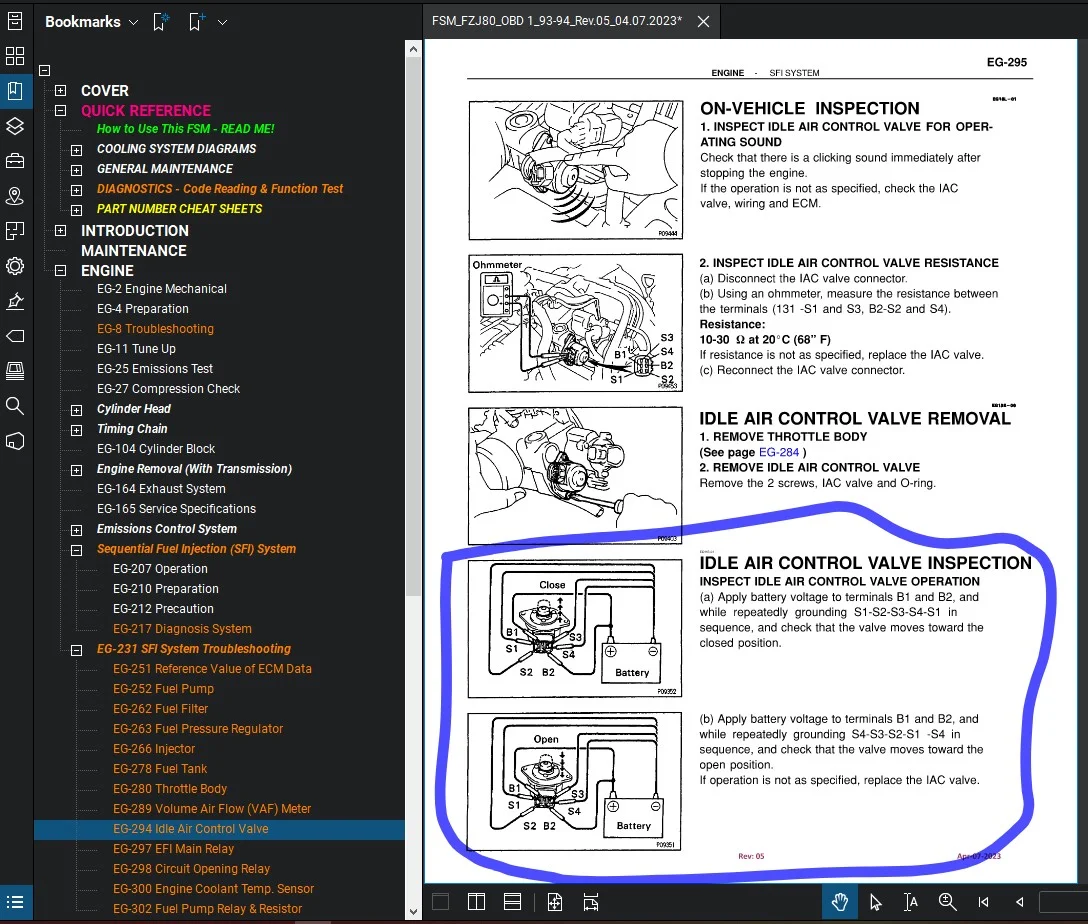

Also Also the IAC is a stepper motor so you don't apply contestant voltage to move it instead you provide pulses of voltage rapidly, see the IAC valve inspection bench test in the FSM (EG-294). You should get my most recent revision to the 93-94 FSM from the link in my desc its well worth the free download

This is what the signal the ECU gets from good O2 Sensors looks like, I captured this image when I was scoping my 85' e30 tracing down a hesitation issue.

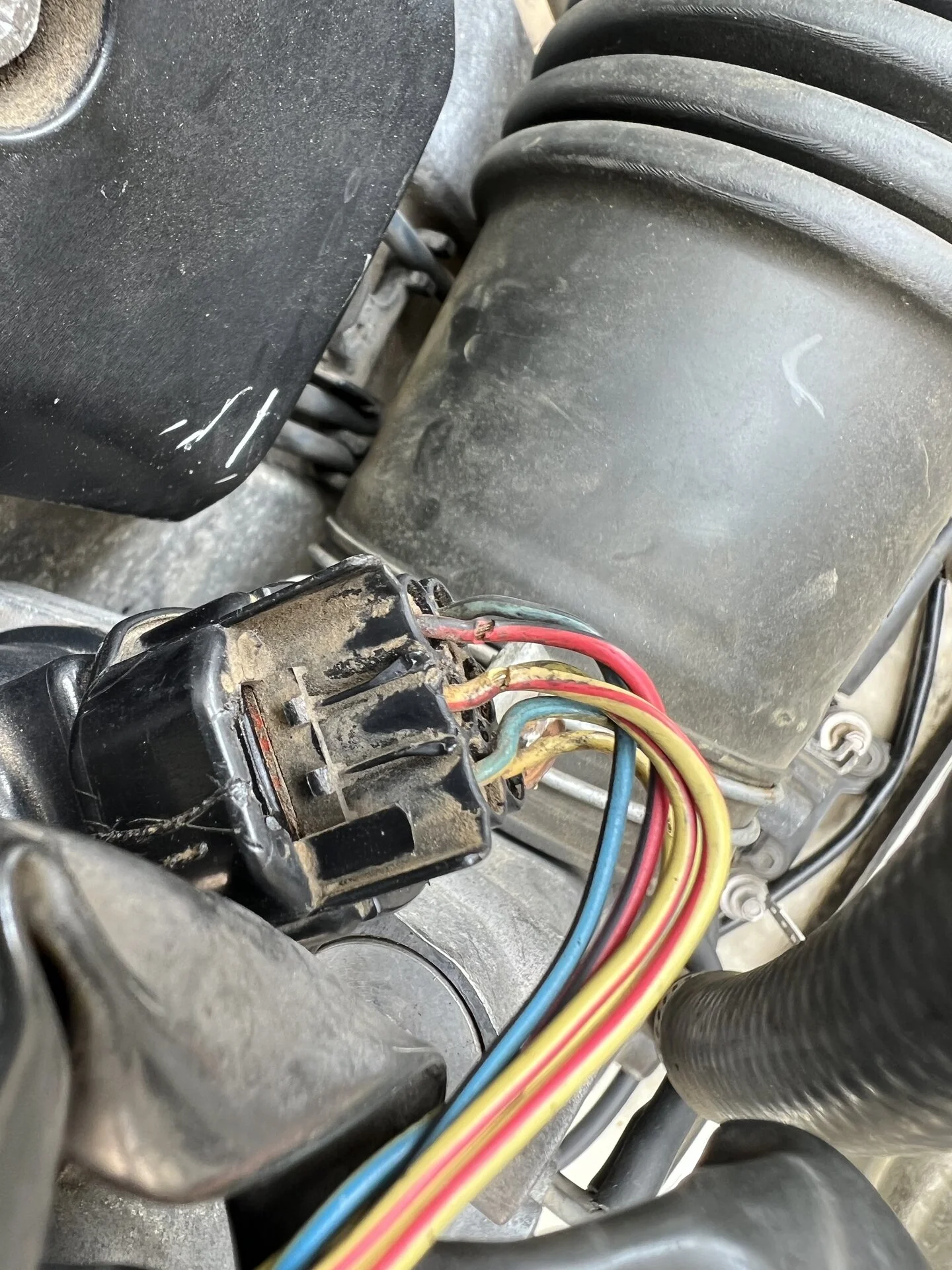

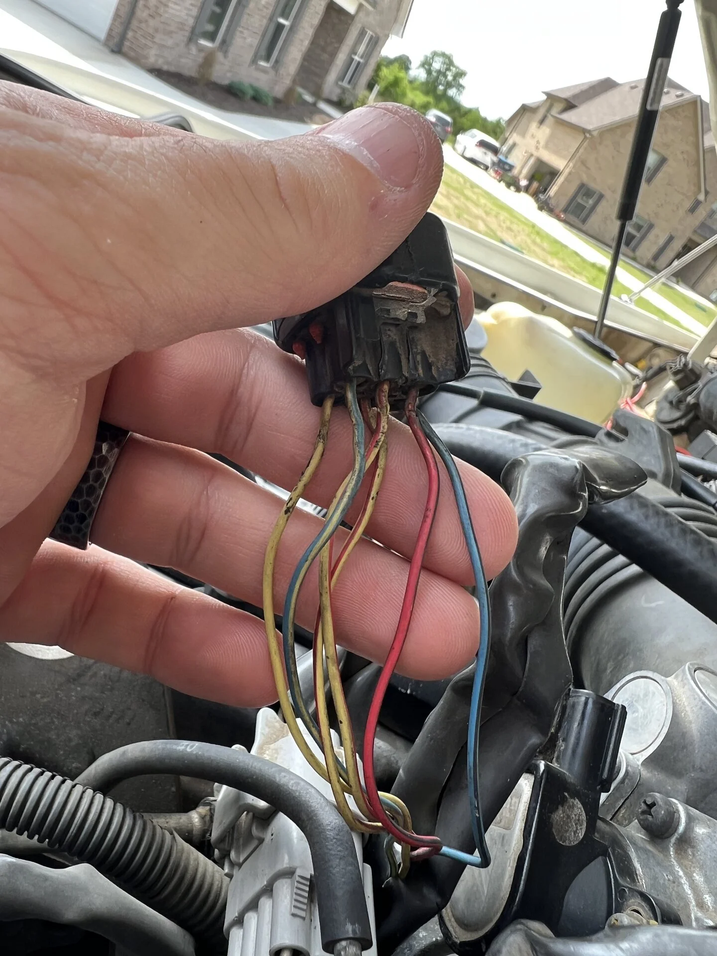

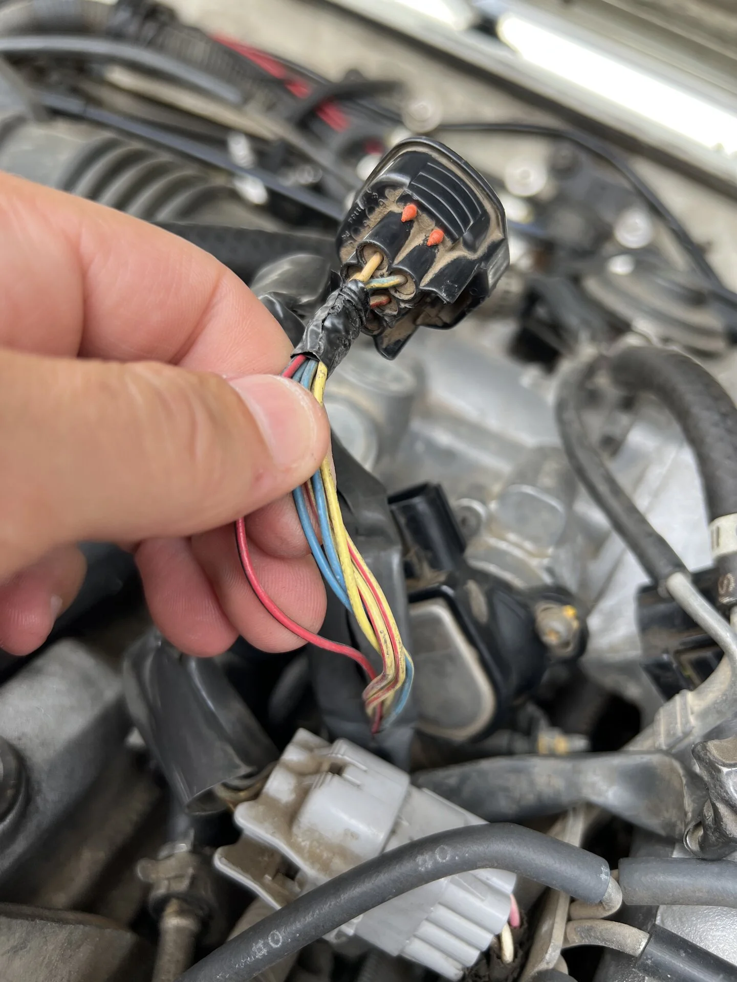

While the idle was chugging, I wiggled the harness to the IAC and it stopped it momentarily. I removed the covering to the harness and it looks like some of the wires are exposed. I checked them all with a meter but couldn’t pinpoint any exact wire that was having issues. I ordered a new pigtail and will splice the wires to the new connector and see if that solves the damn issue.
