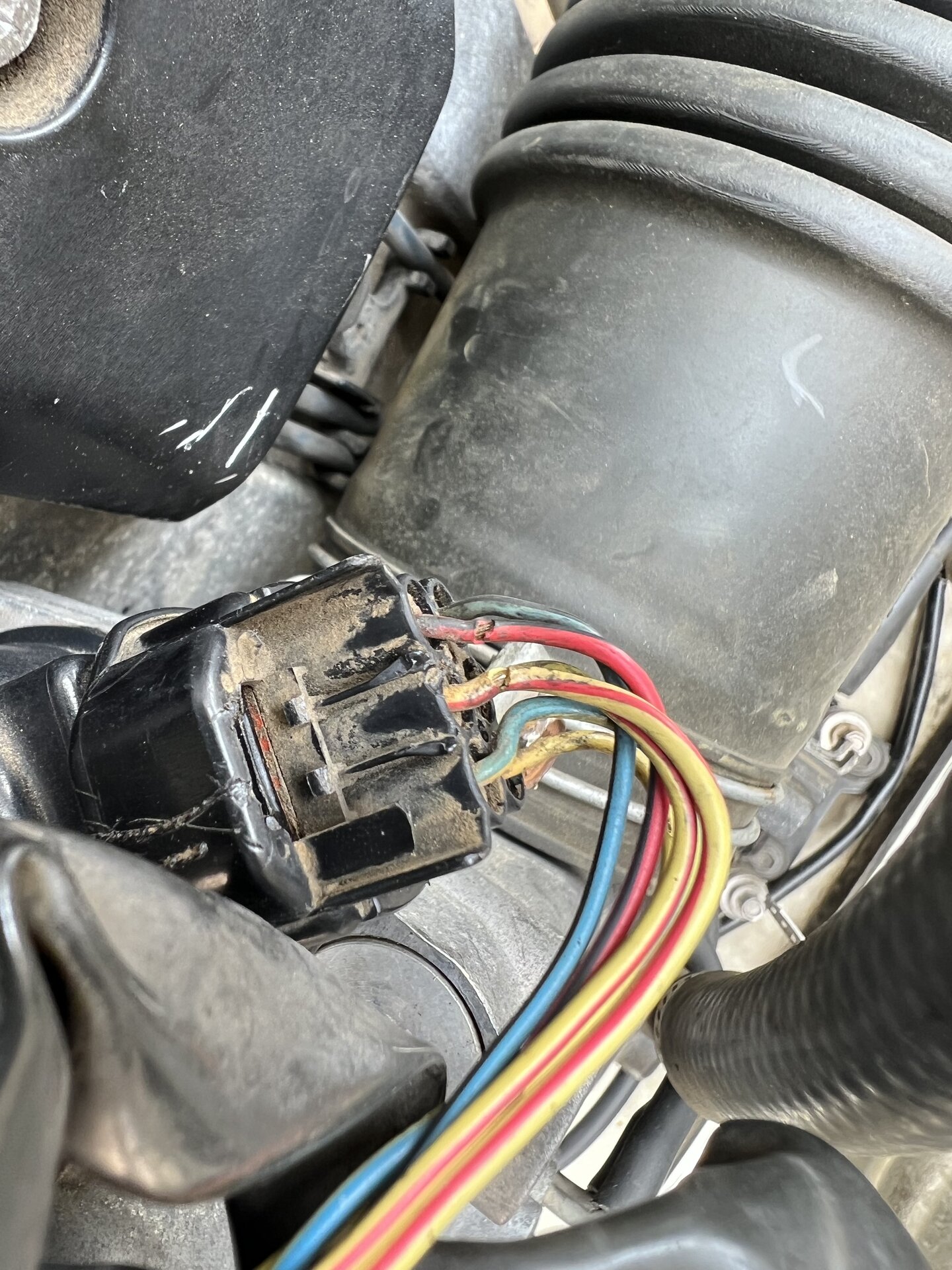

So the issue showed it’s ugly little head again.

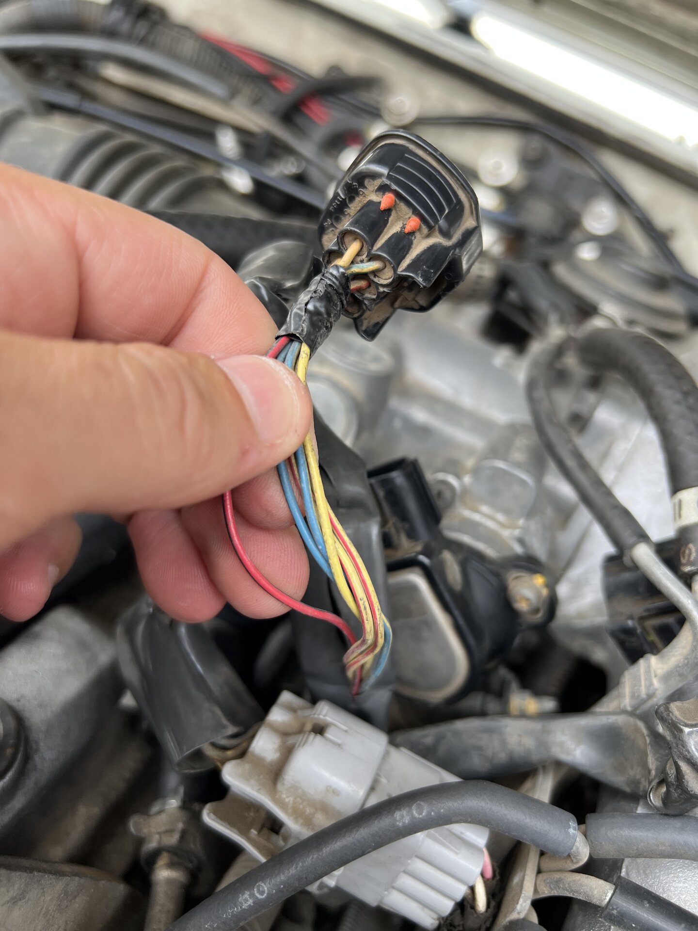

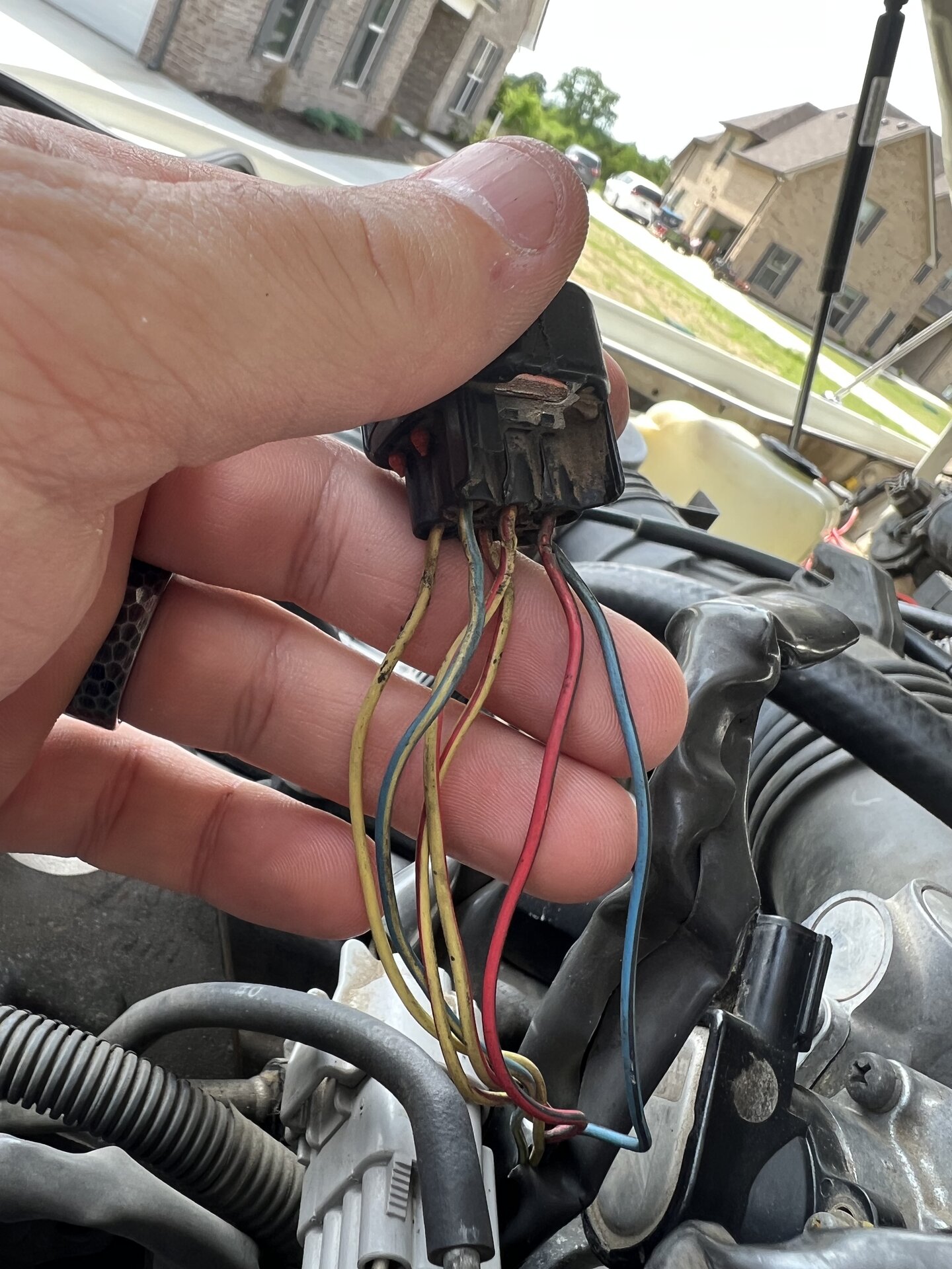

While the idle was chugging, I wiggled the harness to the IAC and it stopped it momentarily. I removed the covering to the harness and it looks like some of the wires are exposed. I checked them all with a meter but couldn’t pinpoint any exact wire that was having issues. I ordered a new pigtail and will splice the wires to the new connector and see if that solves the damn issue.
Ouch!

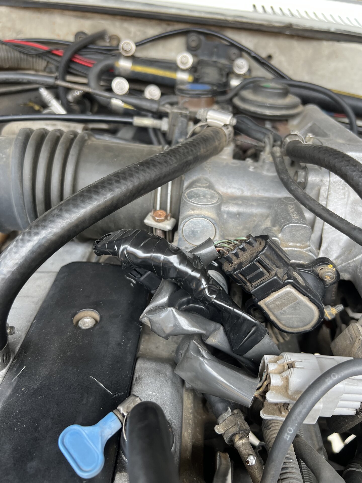

So today I replaced the pigtail for the IAC. So far so good. I’m hoping this solves the issue permanently! The tape isn’t as pretty as the factory covering but it’s nice and secure.
