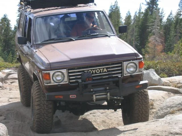

HERE she is guys. the VETTE60 rig.
The reason I call her VETTE60 is that it has a fuel injectred corvette motor in it.
Anyway... it all started when the wife and I started popin' out kids. I could no longer fit in the FJ40 that I had done a frame off resto on, so I always wanted to get a 60 and here was my chance. I bought a stock 1984 fj60 with 164 on the clock, in poo brown color, some of you refer to this as rootbeer. being that I have a problem leaving well enough alone, I have significantly modded it since then.

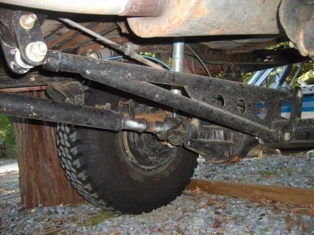

Home brew wrap bar

How about a pic of the wrap bar?
here's the wrap bar. I used ruff-stuff (gravelmaker) brakets for the axle and shackle.

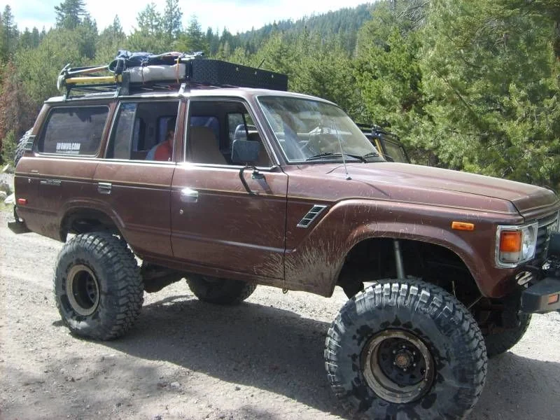

here is a pic of it now (only add some fender damage to the front right)
the shackles will most likely be 3-4" eye to eye for ride / travel I was thinking 35's would be to small... guess ill start pricing 37's and 38's now and see which way i wanna go....
Thank you for the picture it heps my decision alot as far as tire size is concerned as our trucks will be bout the same height.

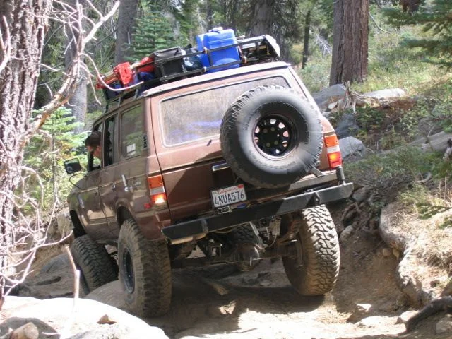

so what did you do for the rack clamps on your homegrown roof rack?
could I talk you into some detail shots of said clamps?
