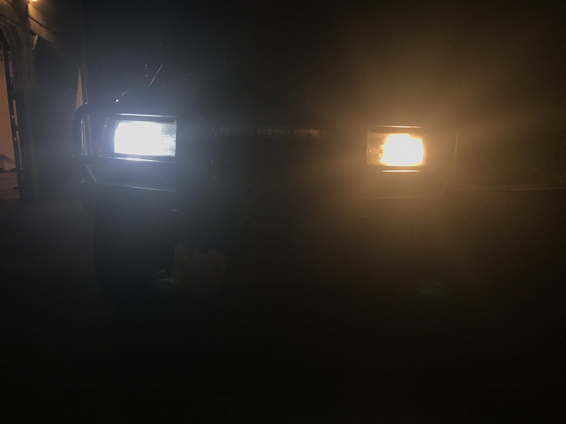

View attachment 1422038 View attachment 1422039 Lifetime led bulbs vs. HIR they replaced:
Certainly looks like at least your truck was a slight downward aim adjustment for the Lifetime LED's. Confirms what I wanted to do based on what I'd already learned about these from you - install one side and do a comparison like the pic you posted here and adjust as needed. It clearly shows the LED aimed higher than your HIR.

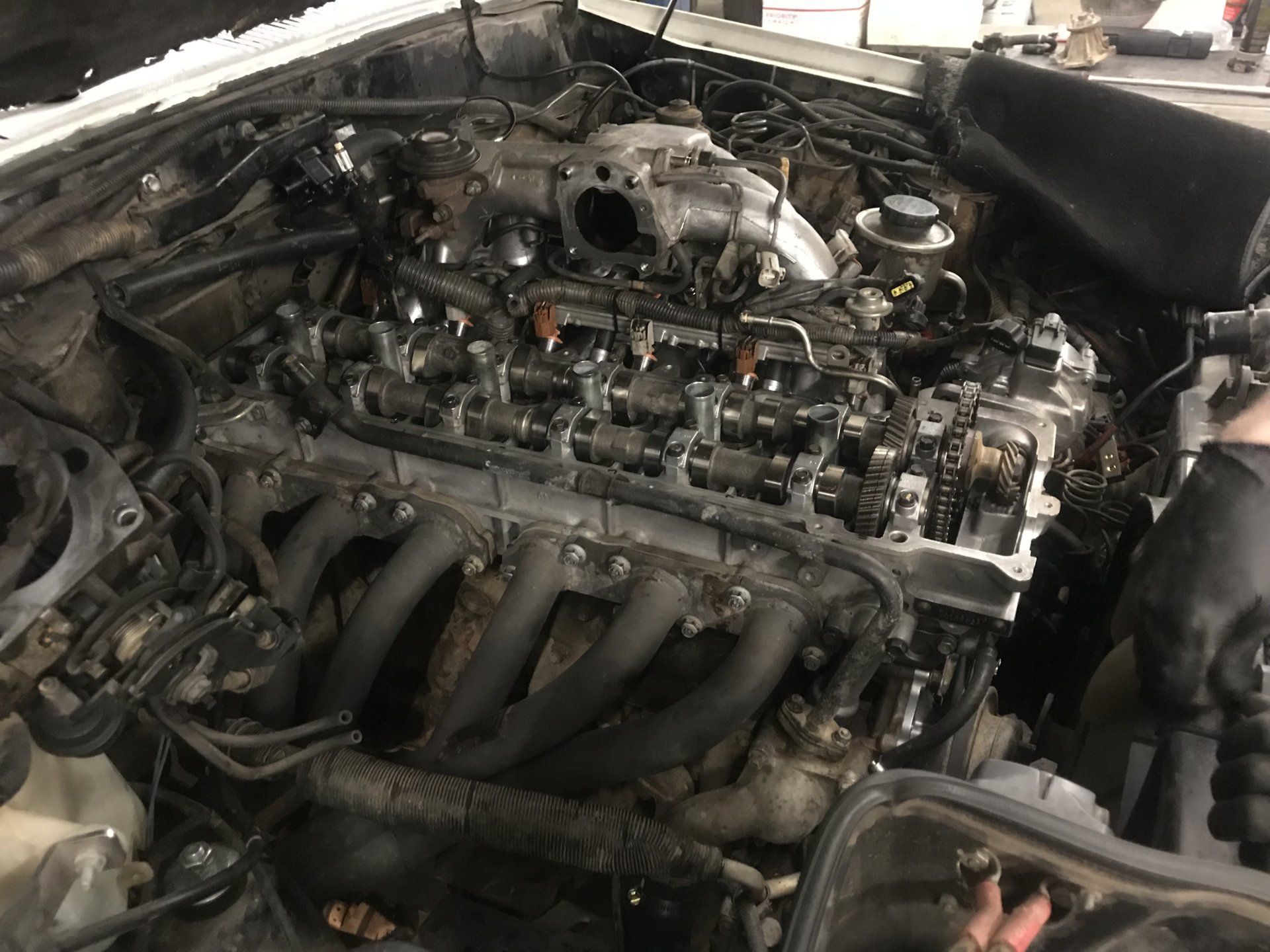

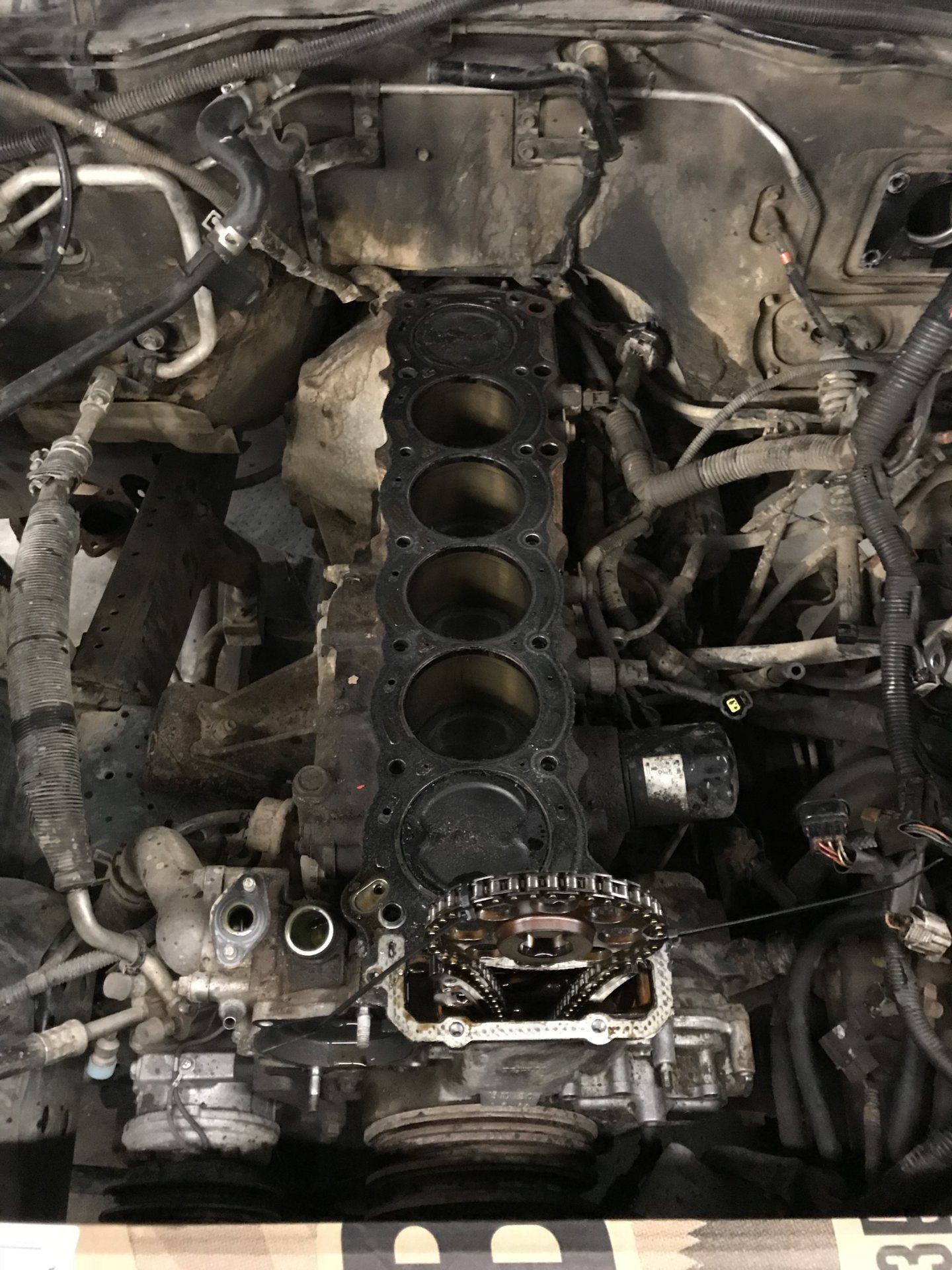

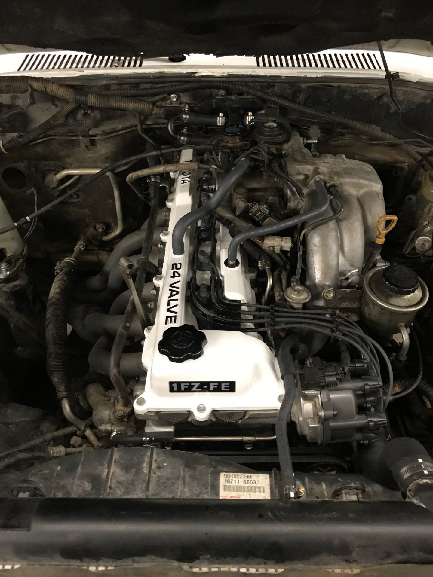

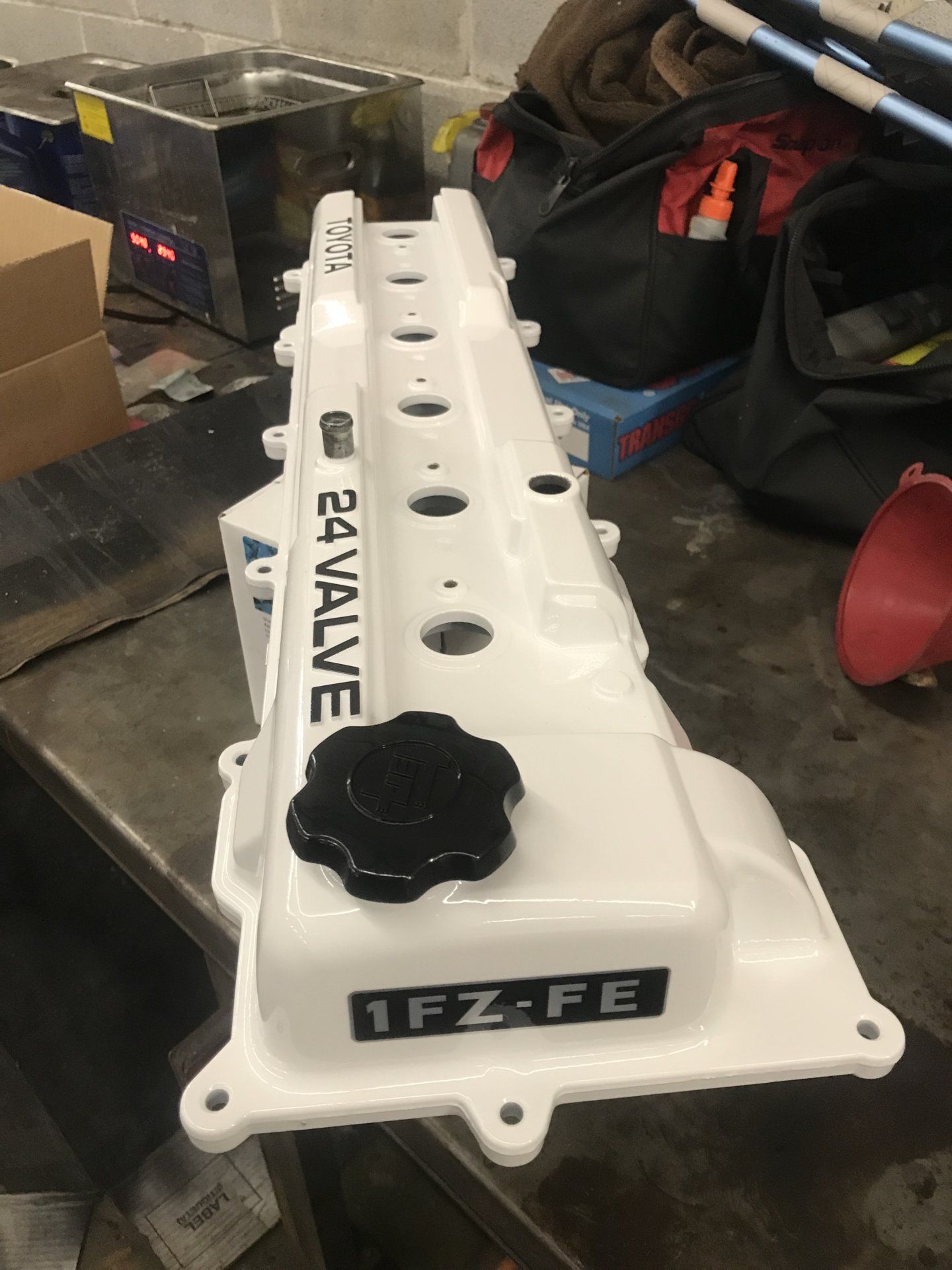

Big thanks to @ACC Toyota for their spa treatment on Michael Jackson. After 265k miles he was burning some oil and overall just tired. ACC rebuilt the head and changed a ton of other parts to refresh. They even installed a Storm Trooper under the hood for more angry horses. I have a ton of power back now! I can really feel the full benefit of the headers and exhaust now too. Such a joy to drive this machine. For the record, the head gasket was still intact.
