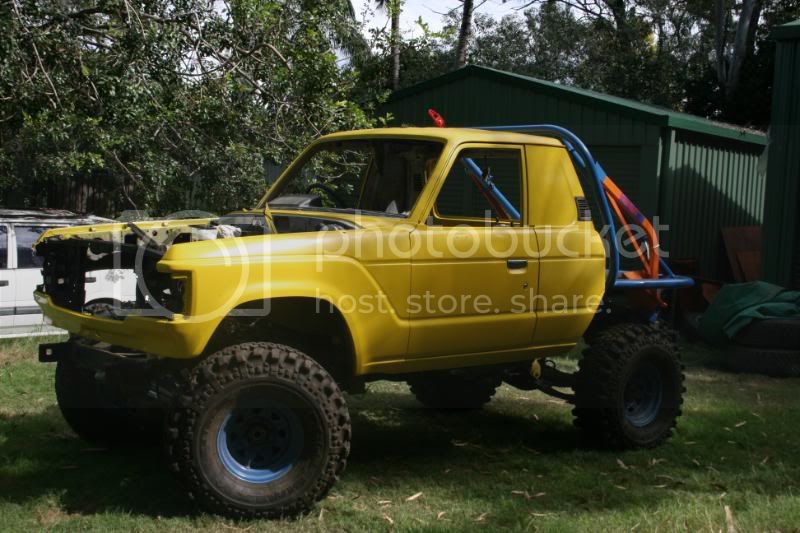

From here I went on to move to a bigger house, build a bigger shed and about 18 months later here is the warthog today
Unfortunately it is still not up and running, but it is slowly getting there
Specs are as follows -
- 1985 HJ60, standard chassis lopped at the rear hangers.
- 1989 Holden EFI V8 308 ci (Aussie GM product similar to oldsmobile V8)
- turbo 400, full manual, reverse pattern mated to 1985 split transfer case
- Front Coils, Diff, Steering box and lincages all Nissan Patrol
- Chromoly steering arm and panhard rod
- Rear diff, 80 series, converted to leaf spring with extended shackles

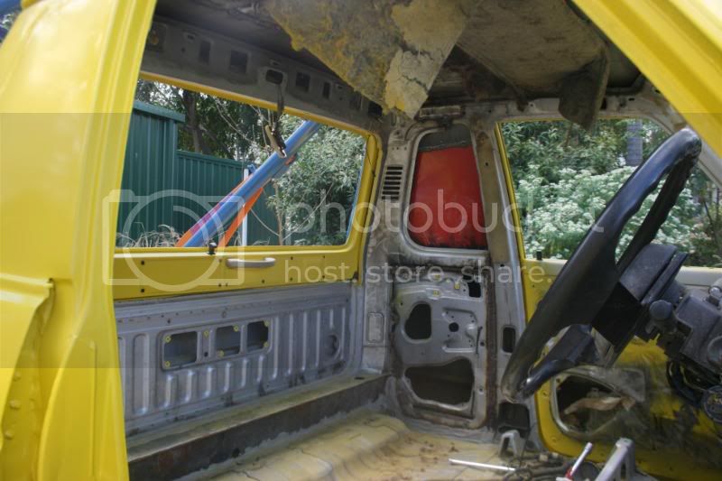

- Custom body chop with 18 inchs room behind front seats
- Custom tray
- 36 inch simex centrepede tyres with staun beadlocks on 15x8 sunnies
- Canary Yellow paint (my son picked the colour)
-2 inch body lift
some more pics

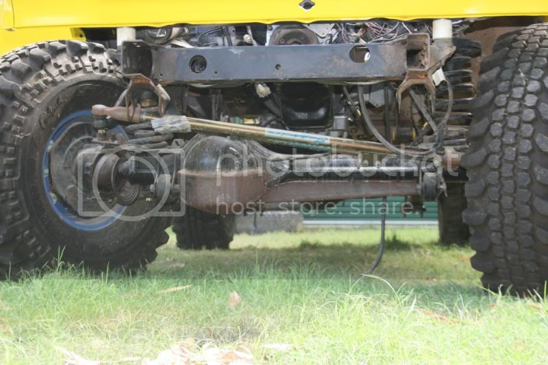

The 80 series front was removed after a mate destroyed 2 of his crownwheels whilst in a comp. Although I am not happy about using Nissan parts, they are much much stronger, and easy to source over here. The front coil conversion was completed by cutting all of the spring buckets, brackets and mounts of a nissan chassis and transfering them to my 60 series chassis
a couple of shots TRYING to show the front end and coils

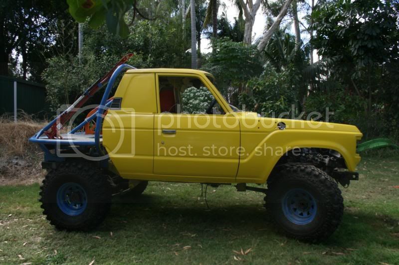

a couple more pics before I go
I like the stance
