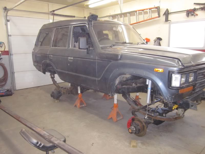

Marmaduke is getting a long needed lowering. With all the additions over the years the "Duke had gotten too big and too heavy. All the bumpers are gone, drawer system is gone, leaf springs are gone. It redo time.
From this:
To something like this:
Back to a bigger tire, lower suspension, nicer armor and aluminum if possible.
Everything is getting ripped out, fixed, and replaced if needed.

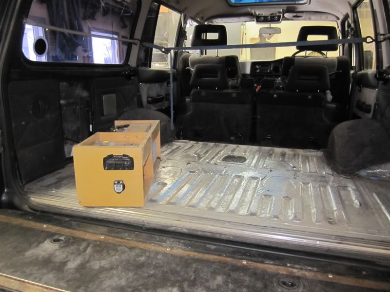

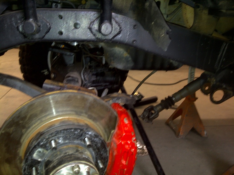

back end is cleaned out. I have 12" of wheel well in the back and 10" up front. Next up is removing the flares and the steering junk up front. Then out comes the axle and spring!
sitting at planned ride height. 22" to the frame on the front and 23" at the back. Optimistic I know, but we will try.
poser shot with the wheels rolled up.
it's tight under there.
Truck went up to 23.5" inches at the frame last night. It's just too tight with the design of the frame. I need to get the engine/frame higher and short of cutting the frame, I need to lift everything up.
It's still 4" lower then it was. I hope I can stay at this height. It just means I need bigger tires to fill the wheel well...
At the new height:
