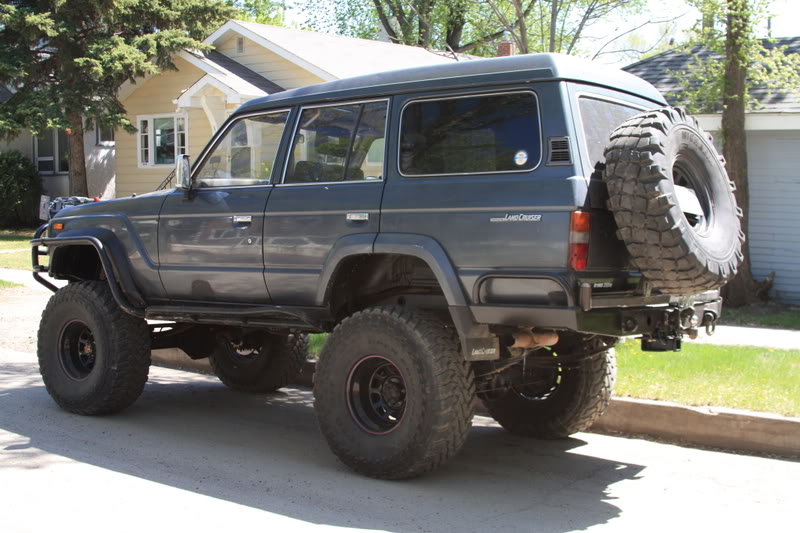

ROTW: Marmaduke HJ61

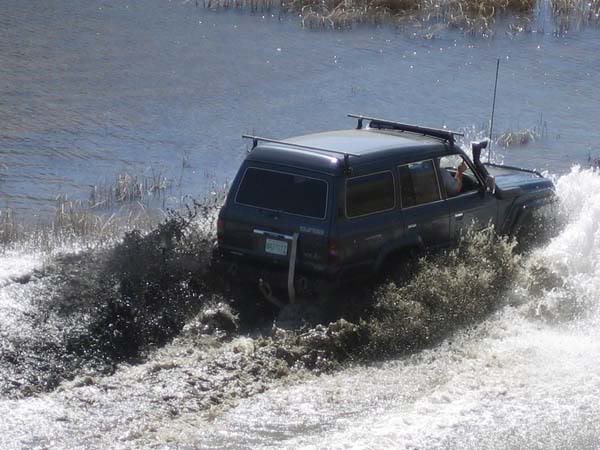

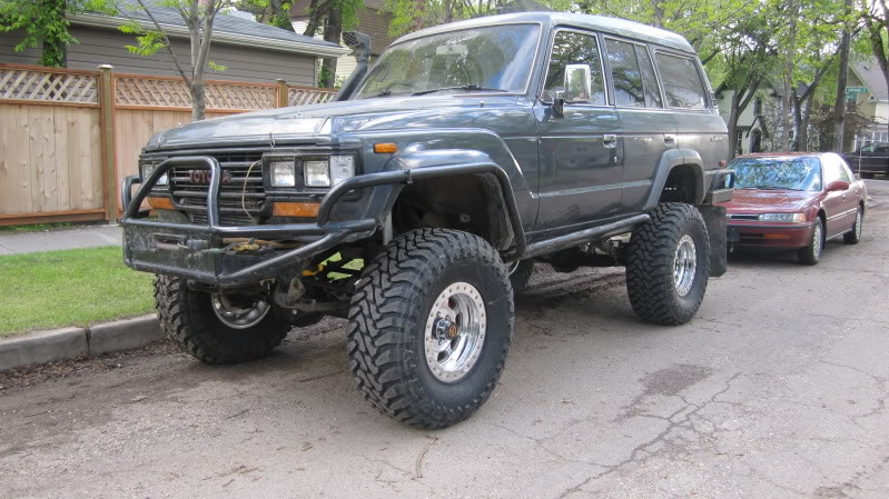

Thanks for letting me post up my rig on the first ROTW!!
and none of this would be possible with out my beautiful wife,
Wow. Totally gives me inspiration to tackle my project truck. Seems insignificant compared to the 'duke! :D

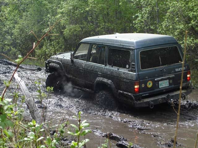

Still my favorite stuck pic, with the ice debacle. I laugh every time. :D
Cheers, keep 'er rollin!
Thats one of the sickest rigs I've seen, and that front bumper looks like its staight out of Mad Max. Great job!!!
I love your rig! Actually its part of my screensaver, but a picture not from this thread, found it in a Googlesearch long time ago, Amazing how you have done everything, and how everything goes so well together, performancewise (judging from the videos and the pics) and lookswise.
Marmaduke has been a great inspiration, and still is!

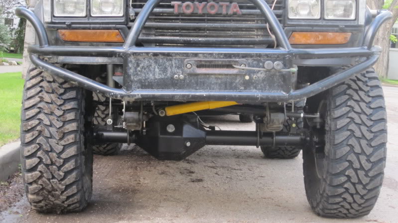

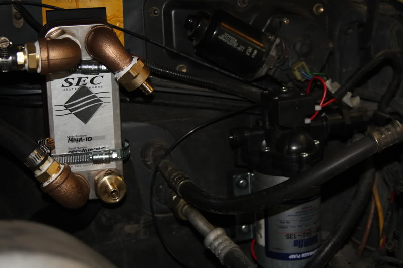

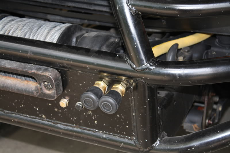

I have installed a heat exchanger from SEC and 12V sur flo pump for a on board shower. I will have to get a better shot of the pump and exchanger. I plumbed the inlet and out let to my front bumper. I hope they don't get knocked off hanging out like they do.

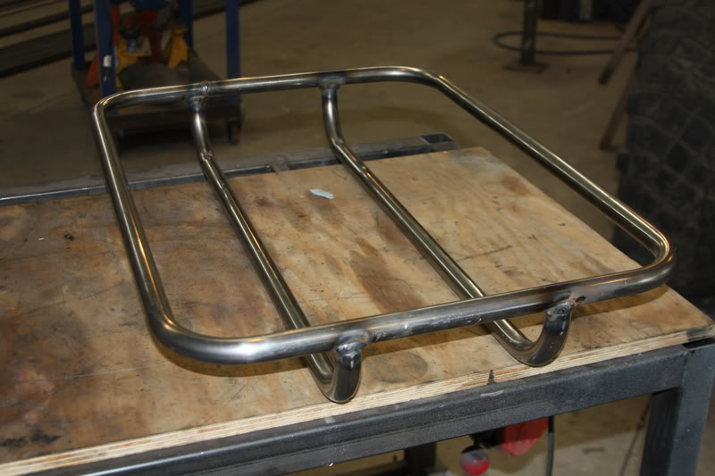

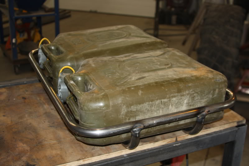

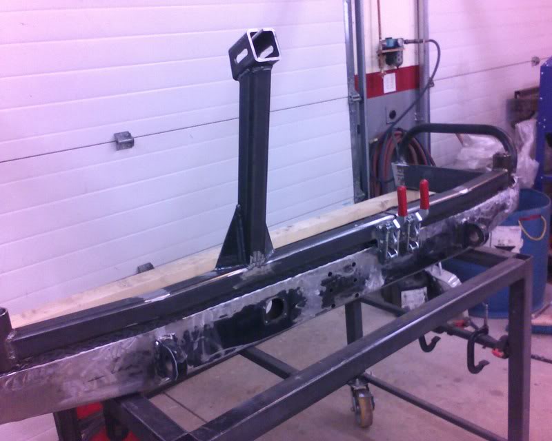

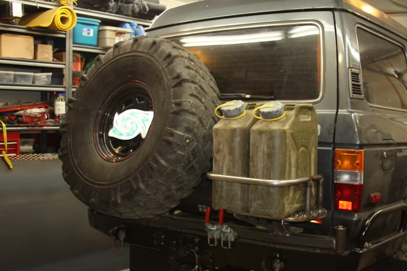

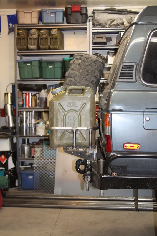

Onto the tire rack and fuel storage. The problem with running big tires is that you need a big spare. I was running a set of Michelin XMLs prior to the Toyos and the best of the lot got spare tire duty, that's a 325/85R16. I stole the design from other bumpers I found on the net.

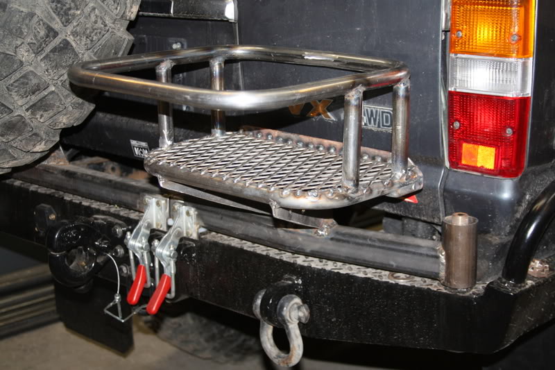

The fuel rack turned out well. Room for two scepter cans. Ii just need to incorporate a license plate holder and maybe a shovel/axe holder.
I was inspired by KMR from www.wagongear.com on his under wagon fuel storage using the AT fuel can holder and decided to build my own. Because of the body lift and no spare under the truck I have lots of room. i would love a long range fuel tank but trying to find one is a PITA and they are $$$$. I still need to do the mounting, I think it will be hinged at one end and bolted up on the bottom side of the rear bumper. So far:

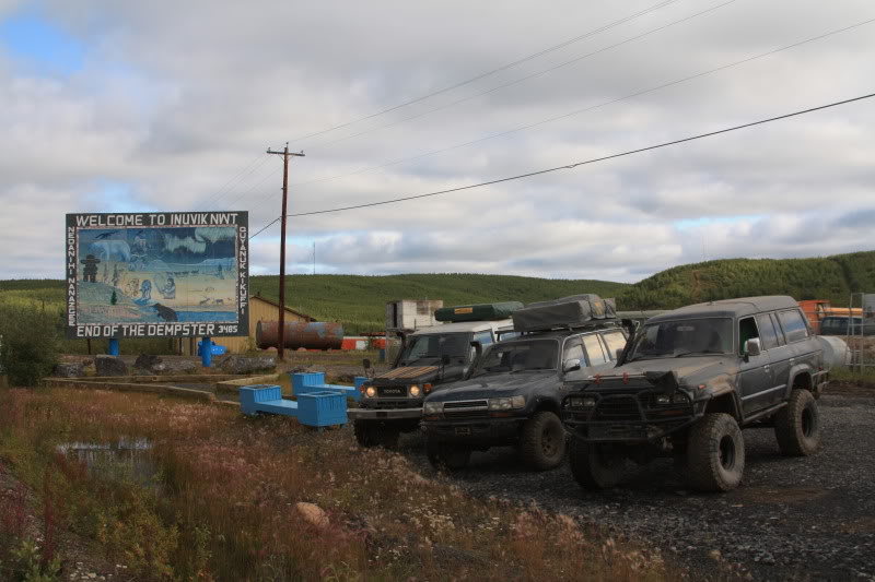

Just thought I would give another update on the truck. We have made a few trips up north (alaska, NWT, Yukon) and absolutely love the truck.

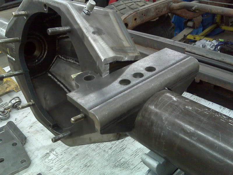

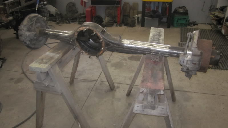

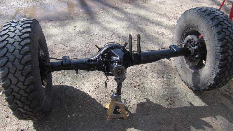

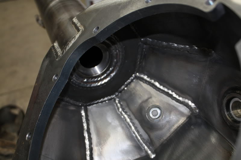

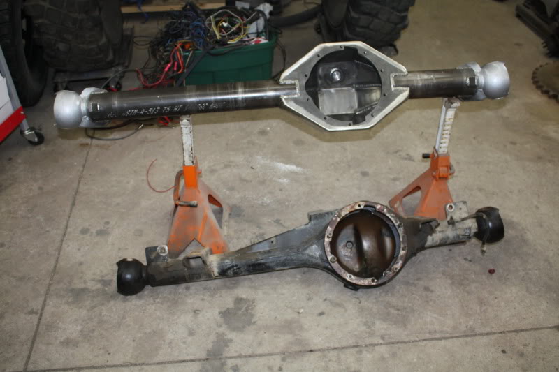

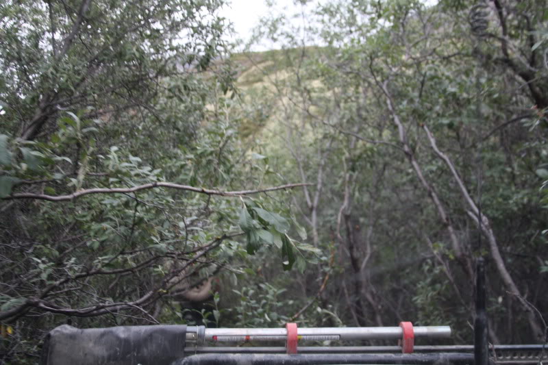

On out last adventure to try and conquer the Canol Road (damn shrubbery!) I ran into a few issues and managed to bend both the front and rear axle housings.

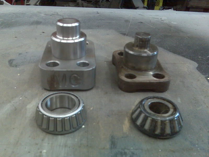

So in the quest to build the ultimate toyota axle, I started collecting parts:

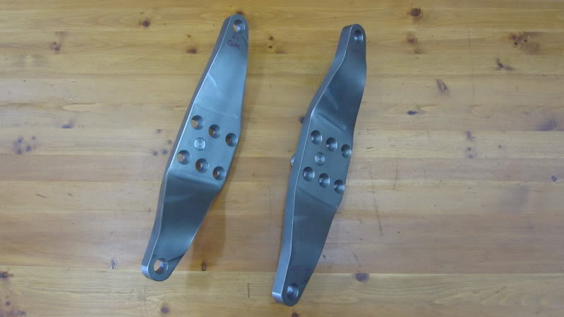

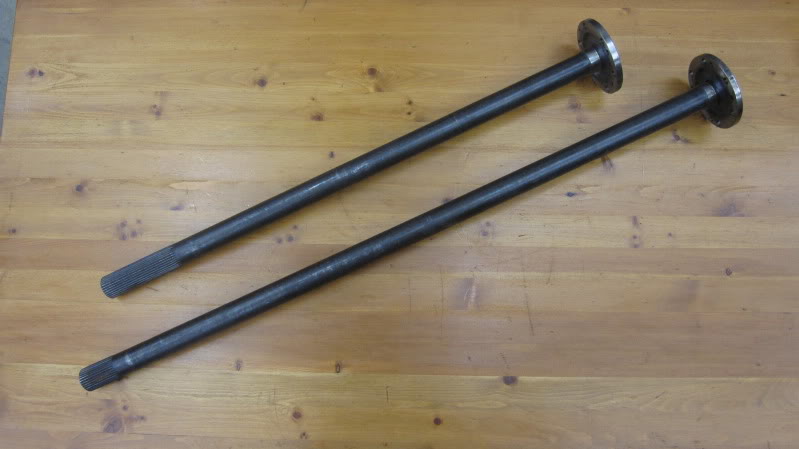

six shooter knuckes and Lukes 6 stud arms (with ARP hardware) and Marlins upgrade pins and bearings:

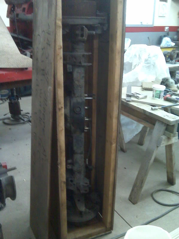

I also went with wider axles to get rid of the spacers and help with the leverage issue that caused the bending in the first place. 80 series with disks and poly pro axles in the rear and a Diamond housing up front with longfields:

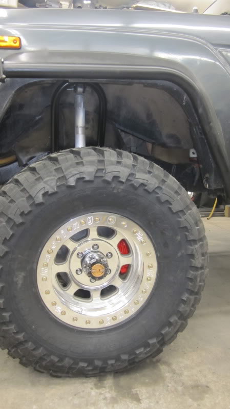

To finish it off I regeared to 4.88 and went down a tire size to 37x13.5R17 toyo MTs on a set of Trail Ready beadlocks. Installed new shock hoops and redid a bunch of wiring and trimmed about 100lbs off the truck and scaled back the front bumper.
