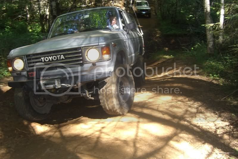

I have since added a MAF 4" Safari lift with shackle reversal. I found some sweet old scool Western Mags 15X8 with 3.5 backspace. The tires are 33 12.50 BFG muds.
I have a full 5x7 rack that I use for camping (sorry not pictured). I have built my own front and rear bumpers. The front bumper is based off of 2mbb design with a few tweaks. I have an 8k Warn bolted to the inside frame rails.
I plan on adding a pre-runner style hoop to the front and reworking the rear bumper to get the tire closer to the body. I am also in the planning stages of rock sliders and should have a locker by the end of the month.
Some other mods I would love to do one day are the 4.11 diff swap and a 5 speed. I figure I will run this 2f untill it dies then consider a diesel swap for a veggie burner.

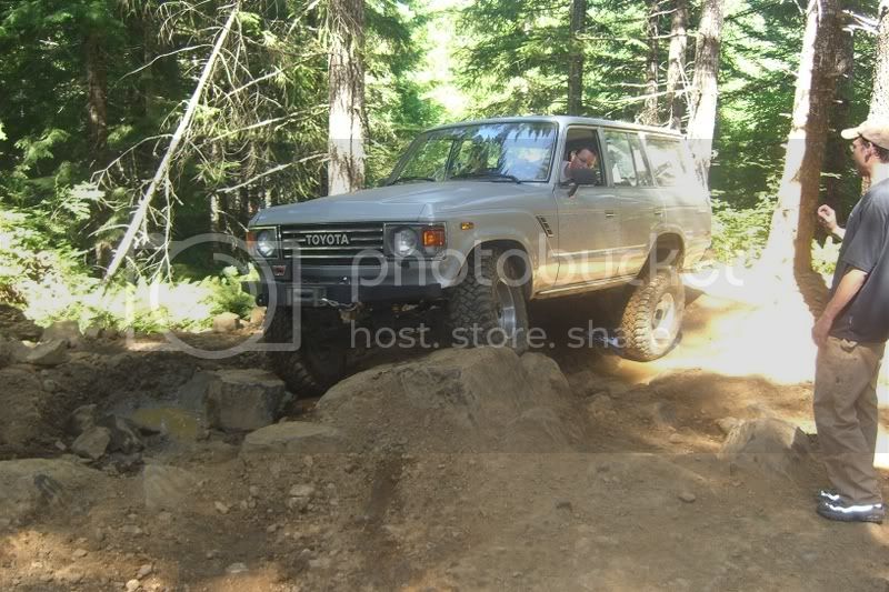

I got to wheel with the gypsy just about a week ago and... the guy is not afraid of his skinny pedal. The the saying " when in doubt... throttle out" applies here. Add a locker or two to clint and who know's what'll happen. Great guy with a great famly ready wheel with... Love the rig Clint.
Oh, yeah... scratch the 5speed for a 700r4 and a crawl box.. :)
Man, I wish I had more video of you on the big turn on FB5 over the rock... THE GUY IS INSANE!!!
almost forgot to add the vid for proof... you can hear me laughing because the gypsy literally attacks this hill and nearly flops (which is hard to see form the video) but does the right thing and sticks to the throttle and not the brake and moves past the hill with no problem. The hill is very steep which does not seem apparent in the video.

90fj62: the suspension actually works pretty well. I was surprised at how well it flexes considering how stiff it rides on the street. With that if I had it to do all over again I would not hesitate to go spring over on stock springs with add-a-leafs and take out the shackle reversal.
