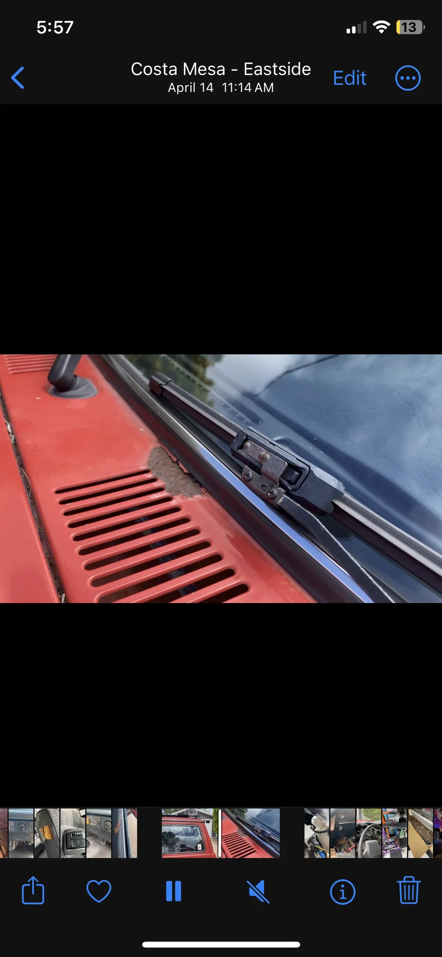

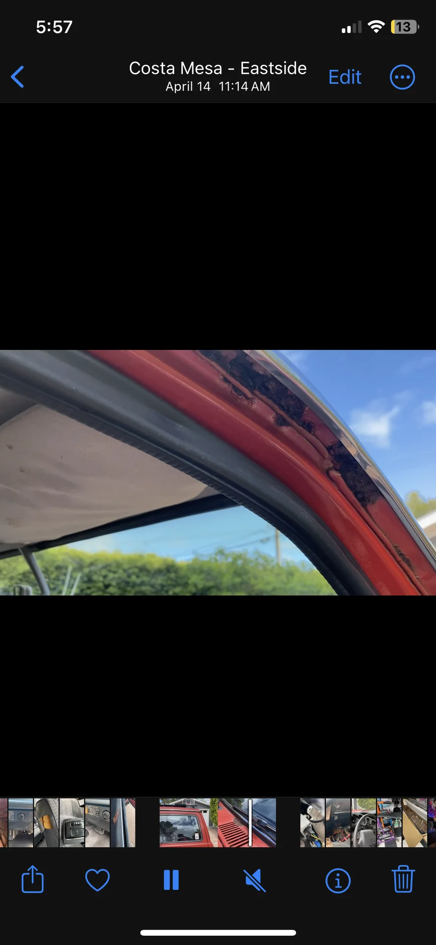

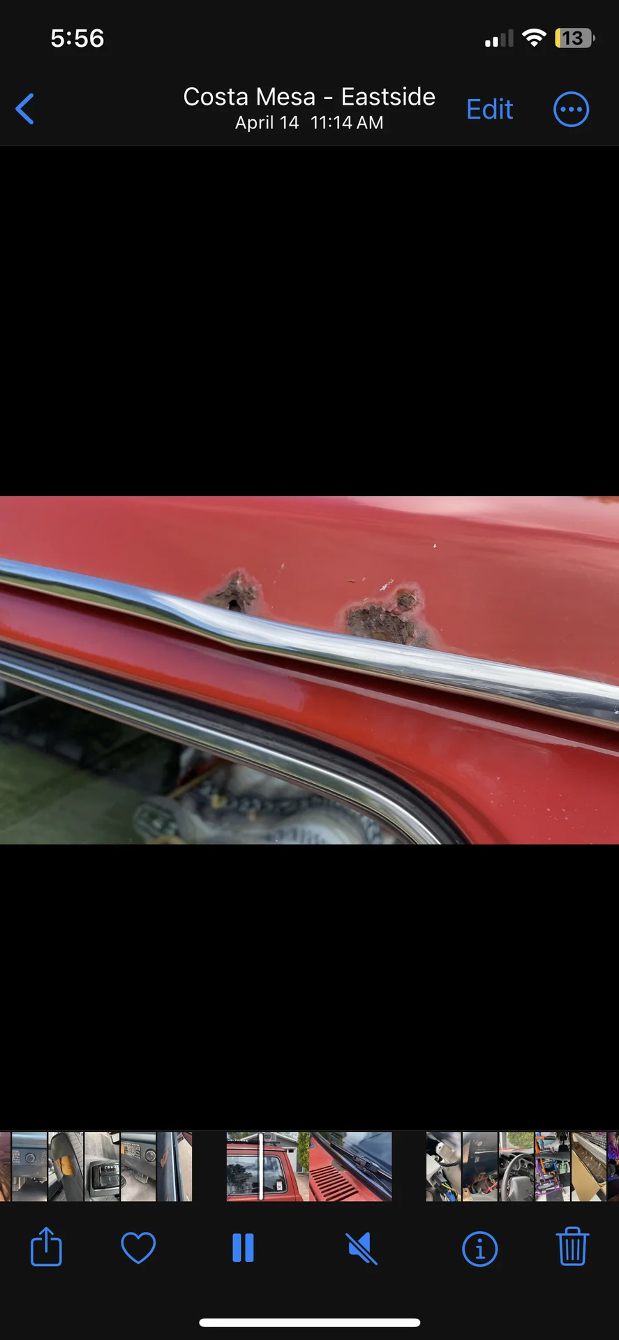

Damn. Here are pics to help see what I’m talking about.

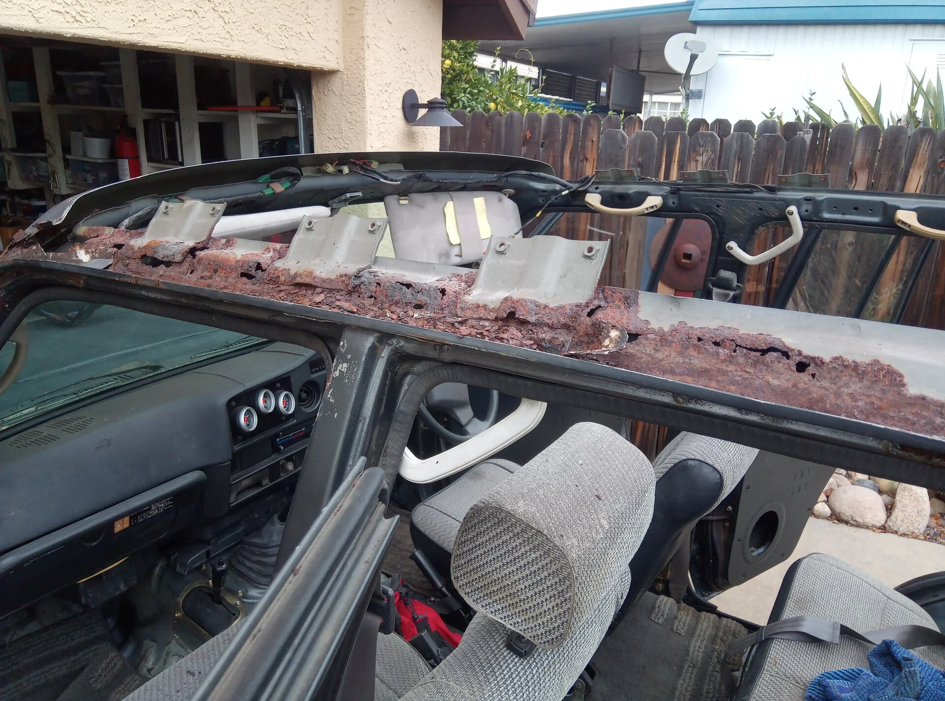

If you want to repair it correctly, the roof and gutters needs to be removed, repaired, cleaned up and reinstalled. I’m doing two roof jobs this year. I have noticed that western coastal 60’s roofs commonly rust like this. At least from what I have seen with customers 60’s

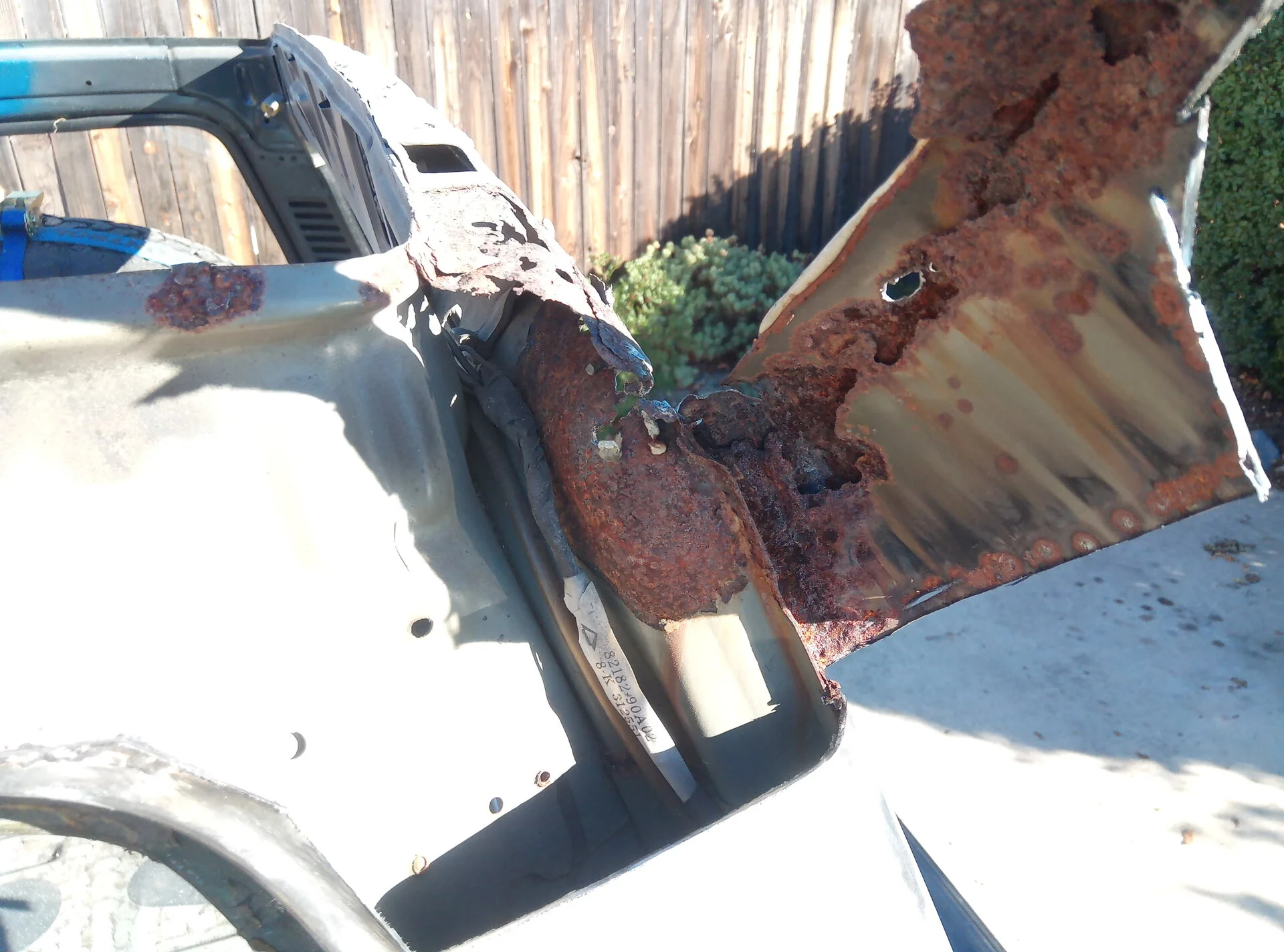

@RojoFJ62 Like he said, this is the only real way to do this properly and ensure all rust is addressed. The process of removing the roof skin is very straightforward. The rest is dependent on the specific truck but below is a rough overview.
This was my experience of fixing my roof rust with a buddy in his garage.
