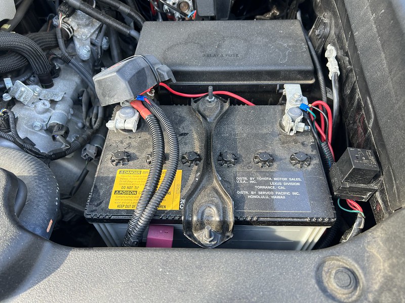

Old stock battery:

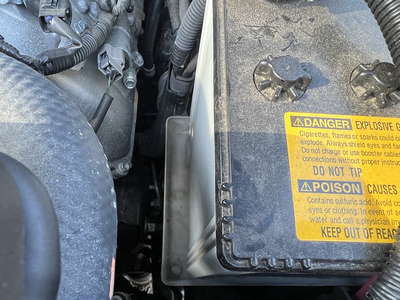

Here's the stock battery in the tray. The gap (i.e., extra space) can be seen here:

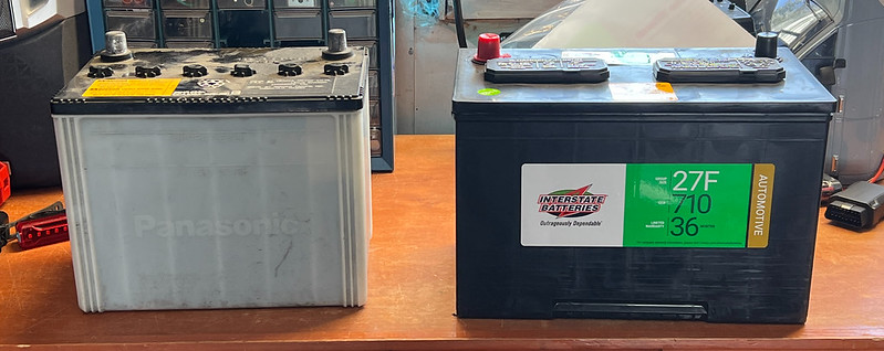

Old battery vs new battery:

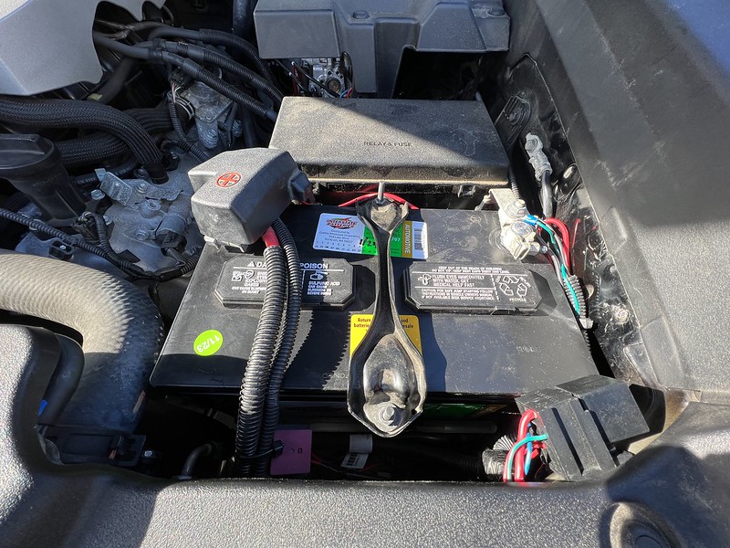

New battery installed. Had to move a relay but it fits *perfectly* in the tray. Nice and tidy:
Once everything is reconnected you have to start the truck once, let it shut itself off, wait a few seconds, and restart it. The infotainment screen shows "System loading. Don't turn off the power." and that's the end of it. Easy process only made difficult by the ice under my feet where the truck was parked.
I too find Costco hard to beat for a straightforward battery replacement. Nice job on the size upgrade.
The other options were appealing but 2x the cost of the Costco battery at the minimum. And thanks, finally confirmed for myself another GXOR top tip that improves the vehicle!
Interstates are not sexy but unless you go toyota OE there isnt a better none AGM
Function over form, and all that...
