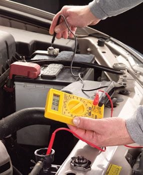

Per Family Handyman
Coolant Testing: Quick test​
Reading the multimeter​
A reading of .4 volts or less means the coolant is good. Replace the coolant if the reading is higher than .4 volts.
If you think the only job of antifreeze (coolant) is to cool the engine during the summer and prevent freeze-up during the winter, read on. Coolant also plays an important role in preventing corrosion caused by electrolysis. Electrolysis occurs when two dissimilar metals start swapping electrons, causing the metals to corrode. Since an engine has aluminum, copper, cast iron, steel and magnesium alloys, electrolysis will slowly eat away at its innards.
Coolant has additives to prevent all of that electron swapping. But, as coolant ages, the additives are depleted and can’t do the job anymore. In fact, worn coolant becomes a pretty darn good electrical conductor, accelerating internal electrolysis. The good news is that it’s pretty easy to check the conductivity of your coolant with a digital multimeter that acts as a coolant tester. If the conductivity is high, it’s time for a coolant flush and fill. Here’s a quick way to check it.
Begin with a cold engine. Remove the radiator cap and start the engine. Set your digital multimeter to DC volts at 20 volts or less. When the engine reaches operating temperature, insert the positive probe directly into the coolant. Rev the engine to 2,000 rpm and place the negative probe on the negative battery terminal. If the digital meter reads .4 volts or less, your coolant is in good condition. If it’s greater than .4 volts, the electrolysis additives are exhausted, and you may be in the market for a new radiator, a water pump or a heater core in the future. All of those are far more expensive than a simple coolant change.

Voltmeter with positive probe in coolant and negative probe on battery terminal as described above. Needs to be .4 volts or less with engine running. Be sure to check with A/C on and off at idle as well as run the RPMs up and down between 800 and 3000 RPM.

I've seen some publications stating .3 volts or less as the target.
You are correct. I have seen .4 and .3 both cited. Cummins cites .4 volts.
I had .1 volts at idle and .2 volts at 2500 rpm with the AC on.
