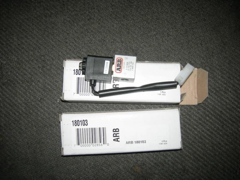

Thanks for the tutorial on the ARB solenoid valve. The fix worked great.
I picked up a couple of spares.

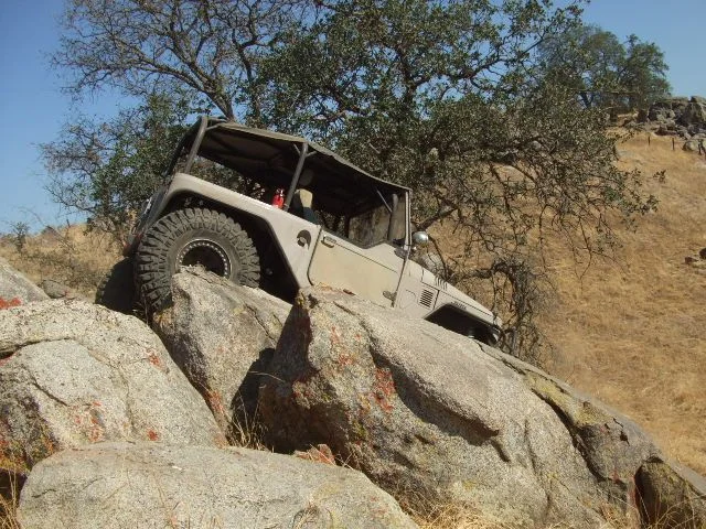

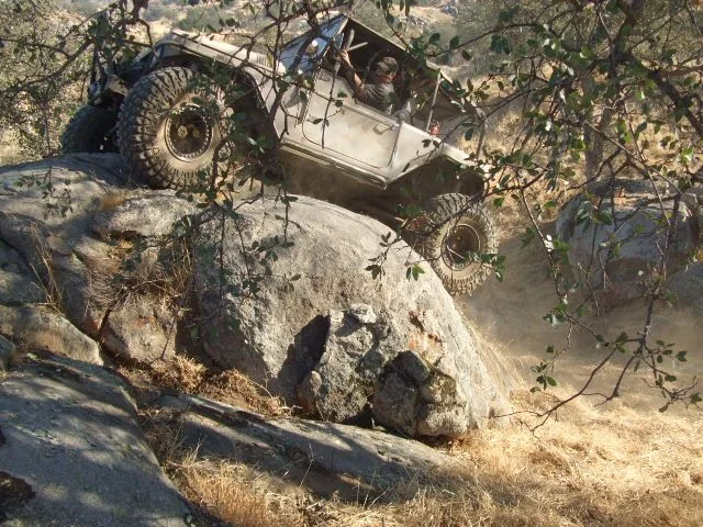

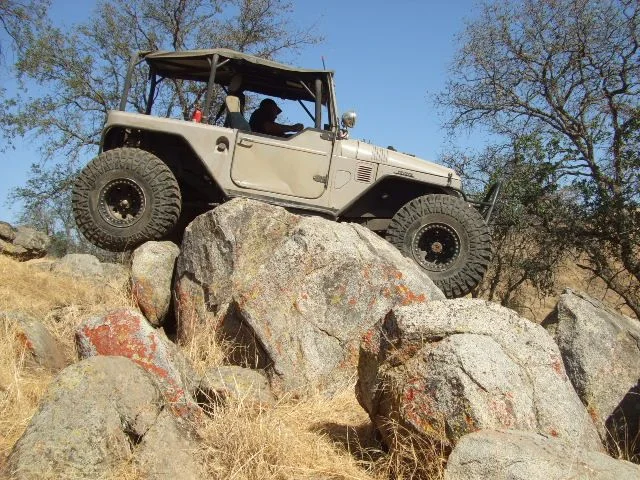

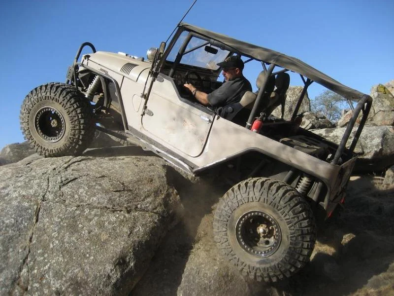

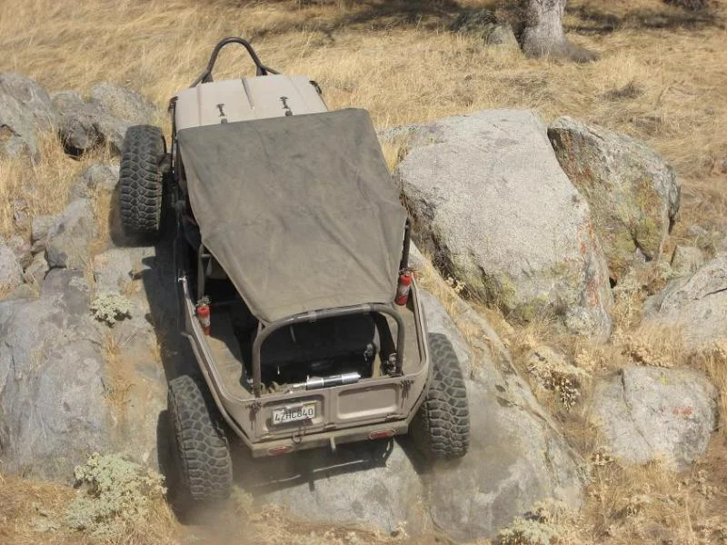

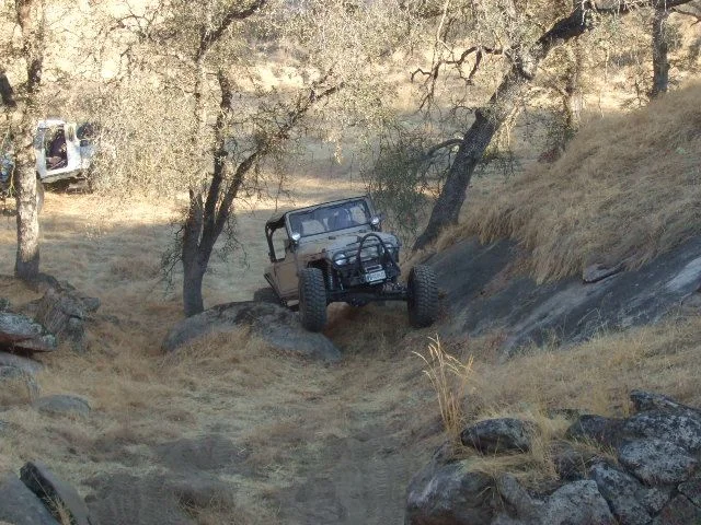

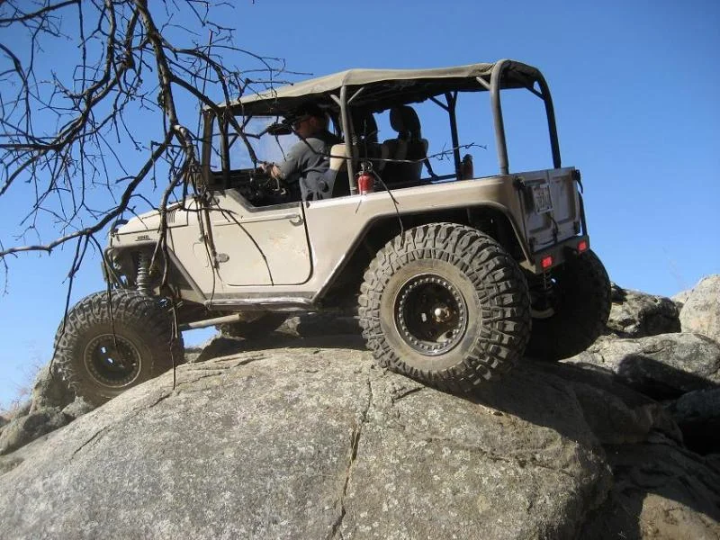

went on a shake down run
here are a couple of pics

arb solenoid went bad on the trail but WE were able to get it fixed
picked up a couple of new ones

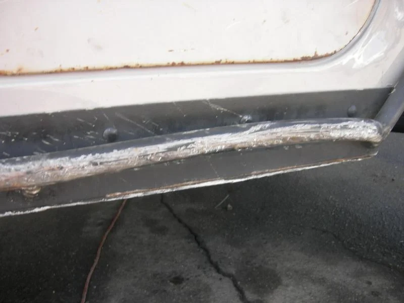

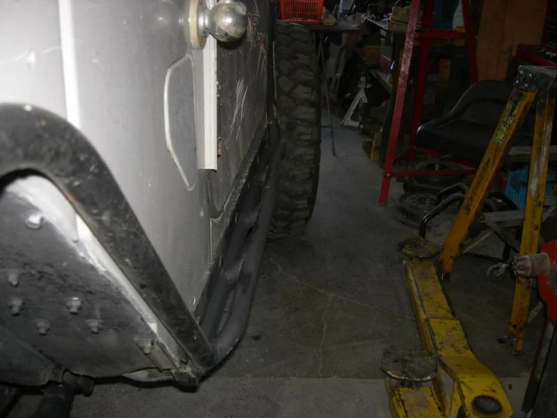

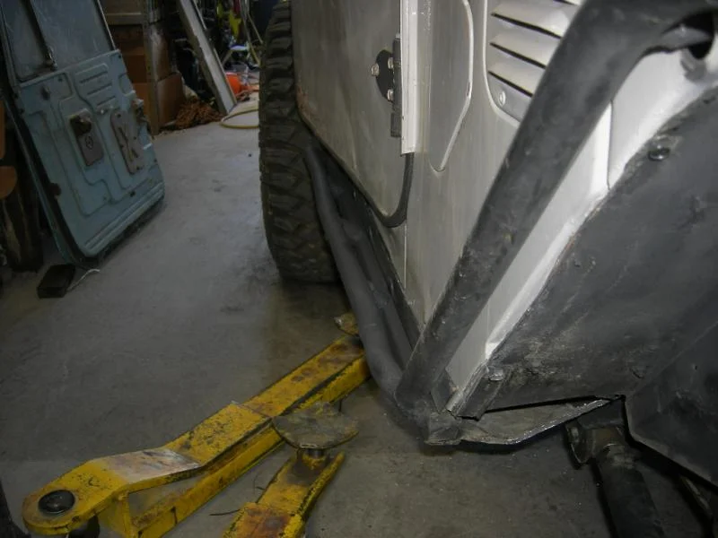

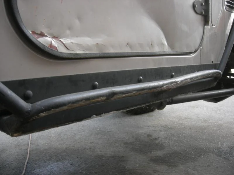

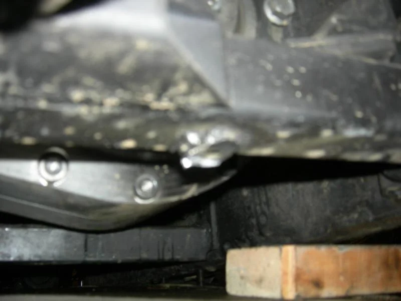

I regret not using some thick wall DOM

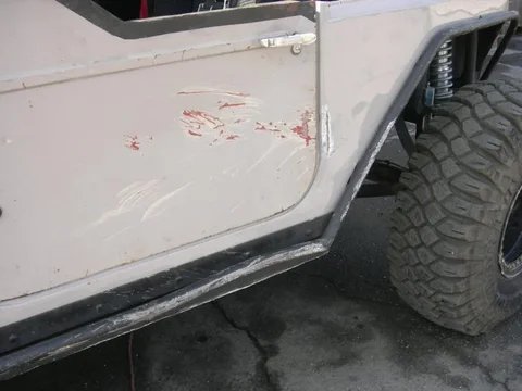

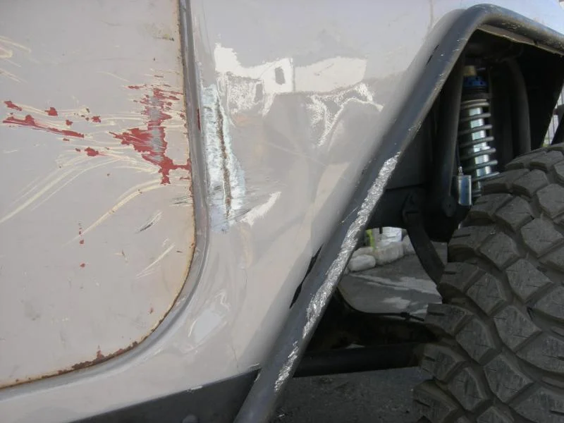

couple of wrinkles in the doors
a little straighter
now with more bracing
need thicker wall dom

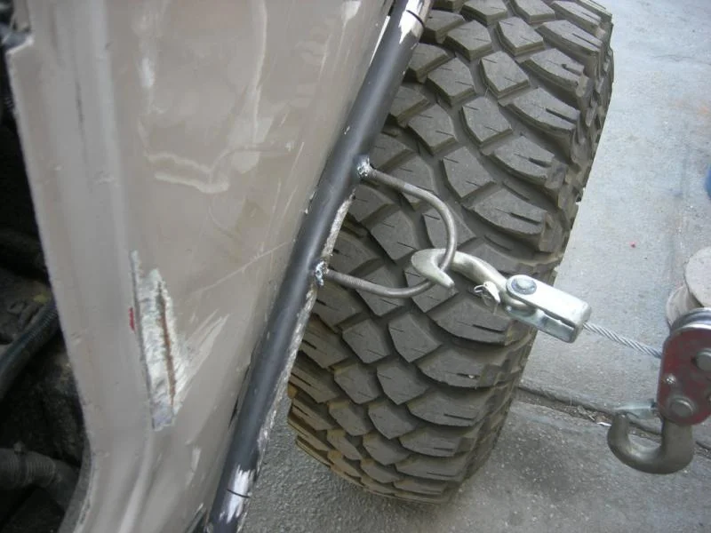

pulled dents out of doors
they are kinda straight now

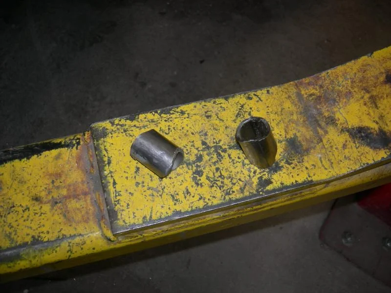

welded exhaust ubolt
relief cuts
then pulled out

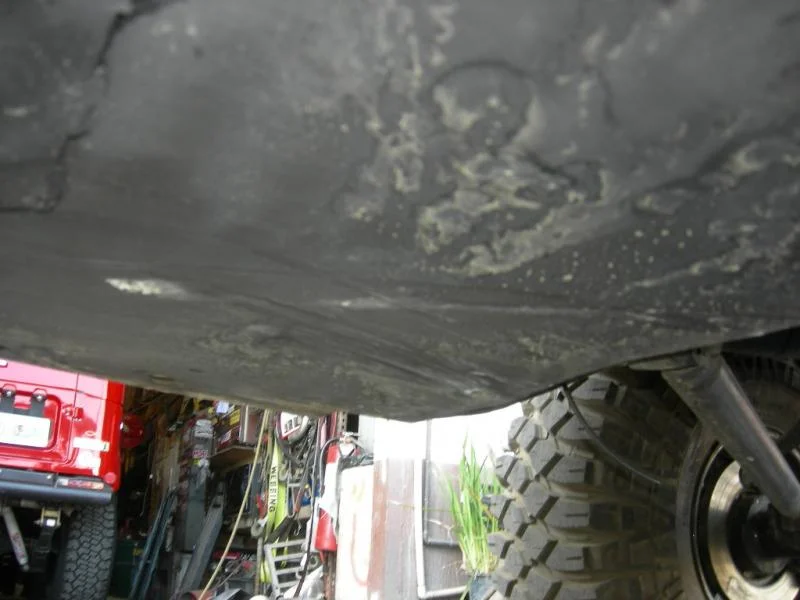

The next series of rock rash is staying

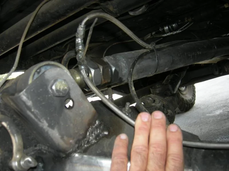

like an idiot a routed the brake lines under the link
of course during the shake down the upper link sheared the brake line in half
had a couple aeroquip fittings with me for a trail repair
brake fluid took off all the paint, no surprise there
all fixed now and routed properly

Hey looks like you had a good time other than the misfortune and rockrash...I love the airiel pic it looks cool!!!

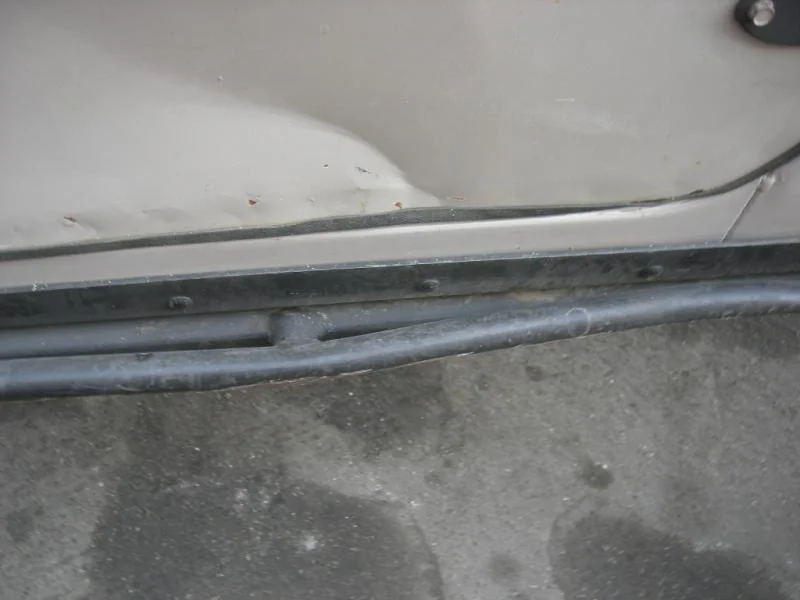

curious what size tube and wall thickness did you use on your sliders and fenderwell protection ?
:beer::beer:
WOW! Now that's a shakedown run!!
I can't believe those tubes bent like that on the sliders!

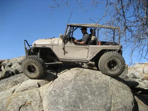

What is that thing weighing now you think?
1 1/4 120 wall. I regret using that thin of a material

I was banging on the slidders pretty hard mostly on purpose.
The rig weighs 5100 with it fully loaded with fuel, tools, and me
