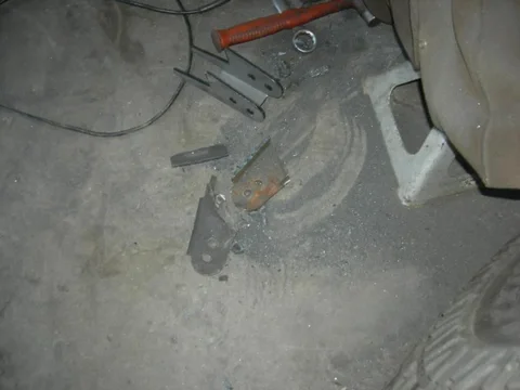

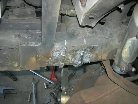

cut down some tube I had from the original build
cut a 45 on the tube for a better weld surface

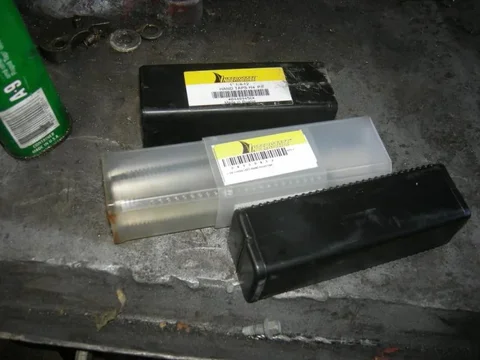

new import taps
lots of heat and scale build up
had to run the tap

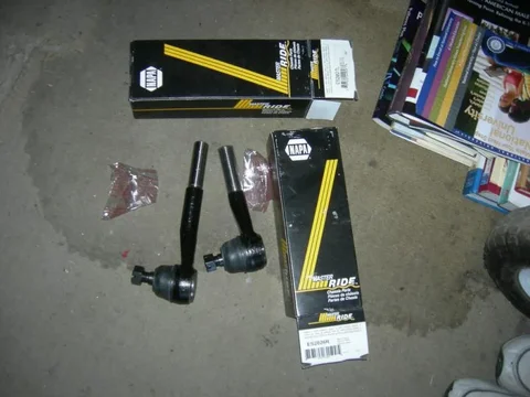

new tie rod ends

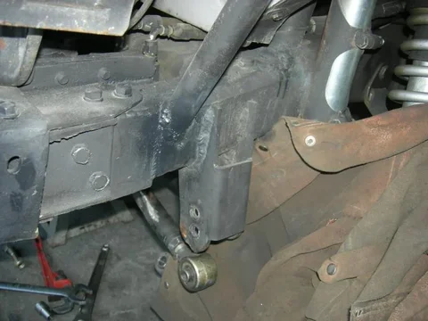

the longer pitman arm hit the panhard bar
move the panhard bar

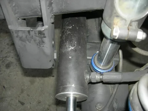

and the panhard bar hits the ram
it never ends
notched the panhard bar and sleeved it up

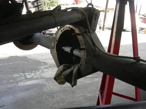

Got the axles in
much better quality then the originals

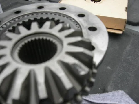

After the installing the axles and getting fluid in the arb was locked up and I had to pull the 3rd out and take a look at the locker
realized I had the axle over to one side by a couple of inches
Tried to adjust it and the threads got nasty on me
attempted to machine the bung fitting out
welded a nut to twist off the bung
threads are all jacked up
finally machined the bung off and welded another one in

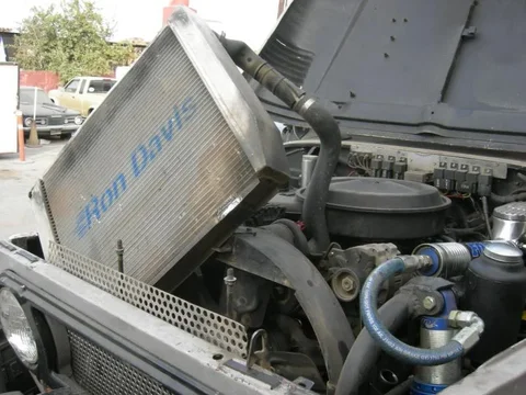

got a remote resevoir
pushed radiator out of the way
pulled the pulley then the pump came off
